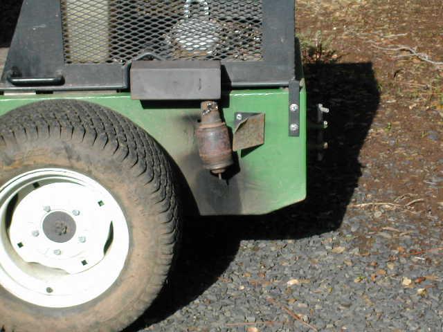

The diaphragm pump that you mention was the one I intended to install but my parts guy recommended the "electronic" pump that I ended up putting on. It's working fine.
Attached is a photo of the angle I am trying on the Supertrap. I worked the PT for a couple of hours Saturday and had no indication of VL. However, an hour or two of stumpgrinding will be a more accurate test. A couple of hours of brushhogging when the temps reach 90 will be the ultimate test.
Please limit comments on my welding ability to "constructive criticism". I did this mod quickly and will grind and fill to make it look nice once I've determined that my VL problem is gone. IF it solves my problem.
And I should be receiving the fiberglass insulation any day now.
