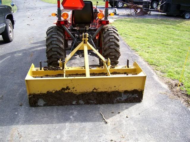

I was going to try and get away with borrowing the box blade.
Now I am wondering if I should get a TSC 5 or 6 foot box blade.
   / Various BoxBlade Uses #93
Mine is 66" & I have to say it is the most useful implement I own. Nothing spends more time on my tractor than the boxblade. When it comes to loader work and digging in the dirt they go together like the left hand does with the right. I recommend going wider than the tractor with a boxblade
   / Various BoxBlade Uses #94
The spec on the 1520 is 62 inch I believe.
going to have to take out the measuring tape.
I dont think two inches makes a difference.
cost is not the issue, they are both about the same.
I am thinking ease of use in tight spots, weight etc....

Regarding the boxblade, I too recommend going wider than the wheel width.
More than several occasions did I need that extra width to scrape or cut where I couldn't drive. Not only that, when you tilt the boxblade severely from right to left (or left to right), the corner cutting the gutter will be closer to the center of the tractor than when the boxblade was level.
Especially handy for me when cutting gutters on my road with high banks, where I could not "straddle" the gutter. My boxblade is about 6" wider than my tread. When tilted like that, where my wheels track is where the gutter is cut. So I use that as a method for getting the gutter cut where I want it to be. If my boxblade was shorter, the cut would happen somewhere inside the wheel, and I would have to drive partially on the other side of the gutter.
