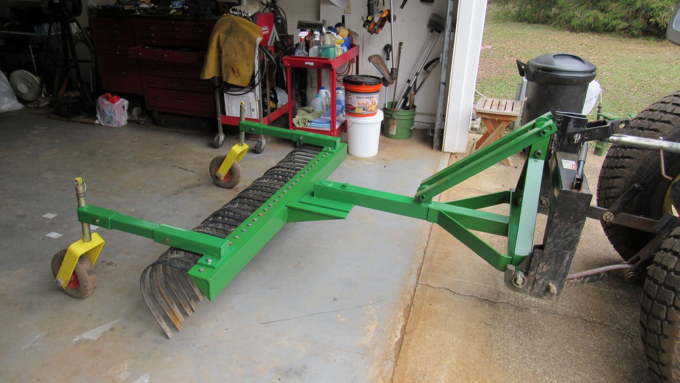

I have a cheap landscape rake I recently rebuilt. I added the titan gauge wheels to it and it was still less than optimal. Mainly because they were too close to the rake and would hit the tines if I backed up. I never really used it as you intend but I noticed it would work to actually rake on the surface after I extended the wheels back and had the height set with the rake just above the surface.
If you have the ability to fabricate you might try adding gauge wheels and extending them to make them function better. The way mine are mounted you loose the ability to reverse the rake with them on. With a little more design work at the pivot you might could make it so the rake is still reversable.

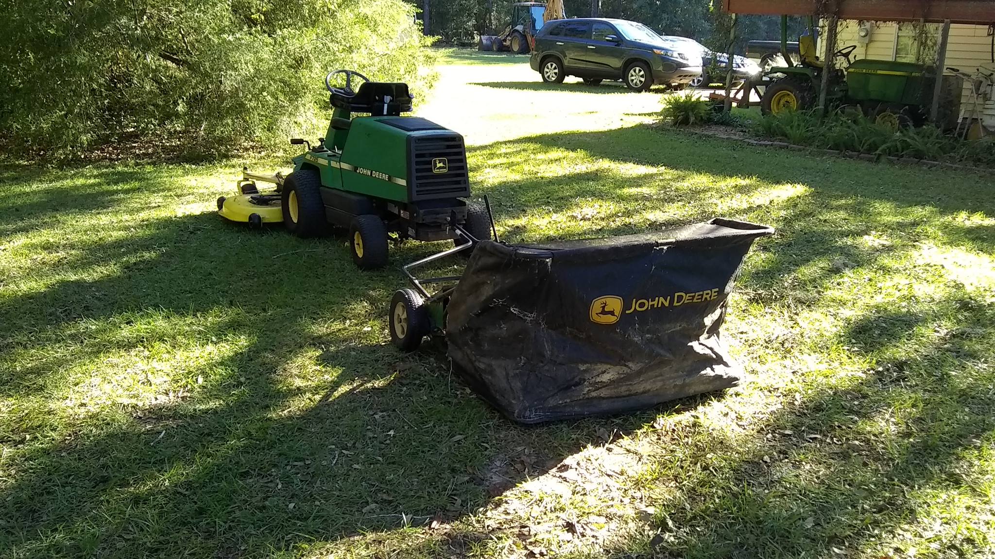

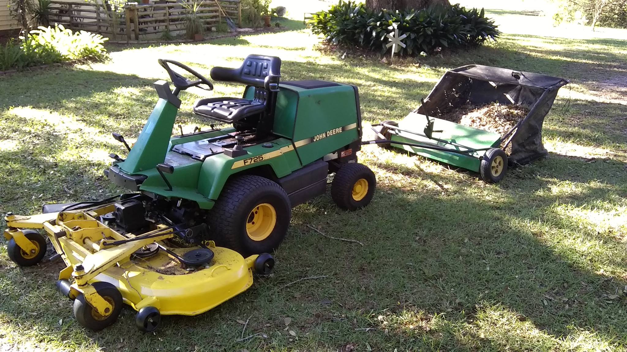

Actually I'm wondering if this implement might work good for me to rake leaves? My second spring season on my new property and we rake a lot of leaves around the house using hand rakes and tarps to bring the leaves to the burn barrel.
You need a lawn sweeper.
