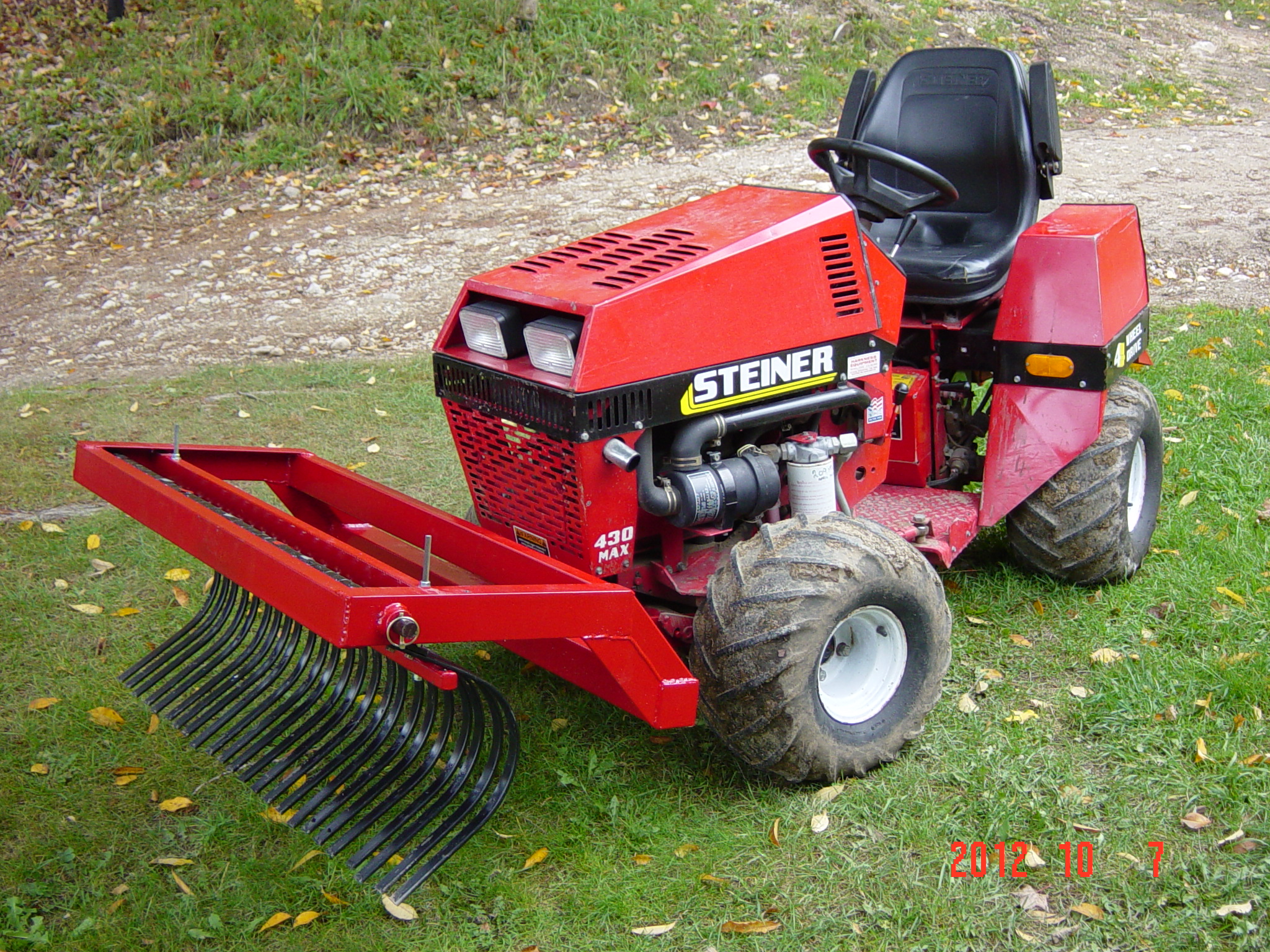

I built this for my Steiner specifically for cleaning up debris if dropping a tree on a turf area.
What makes it different is that each tine is on a bushing, on a rod so it follows the contour and doesn't dig in. It works great. The tines can also be arrested to work like a normal rake and it can really dig in.
As far as picking up small piles of branches. Really, there is no way except by hand, but at least they are in a pile.
This looks great! Any chance you’d share your plans? I’d love to make one of these! Thanks!
