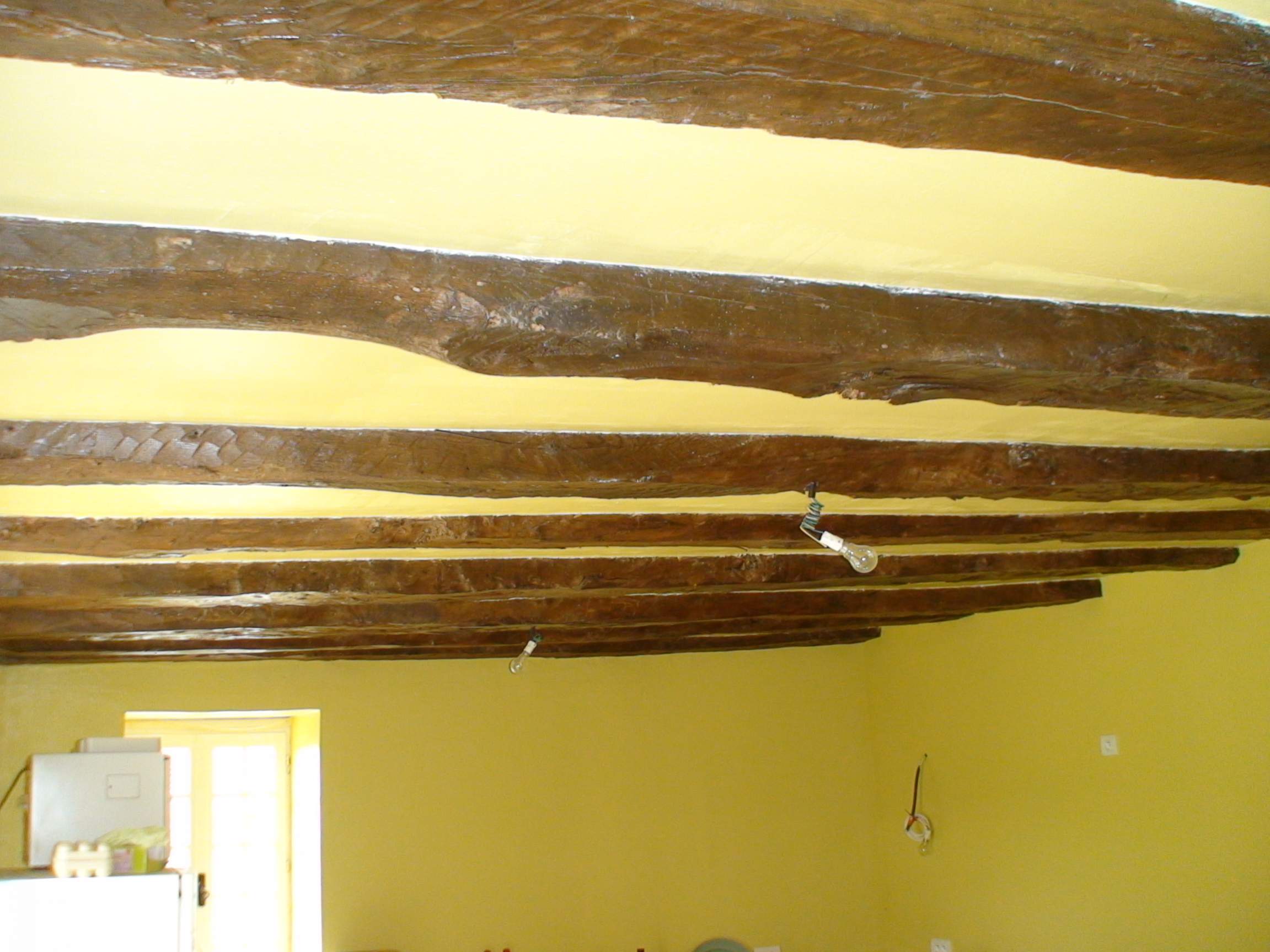

DSC00789.jpgAfter uncovering the oak beams above the kitchen of my house in France I followed local advice to sandblast them and spray with a bleach solution (to clean them as they had been under floorboards for 500 years) before spraying with a matt stain which included insecticide etc. to seal them. Of course, this may not be the look you're after.

<img src="http://www.tractorbynet.com/forums/attachment.php?attachmentid=295759"/>After uncovering the oak beams above the kitchen of my house in France I followed local advice to sandblast them and spray with a bleach solution (to clean them as they had been under floorboards for 500 years) before spraying with a matt stain which included insecticide etc. to seal them. Of course, this may not be the look you're after.
You have a 500 -year-old house in France? Picture me dying on the floor of envy! That is SO wonderful!
