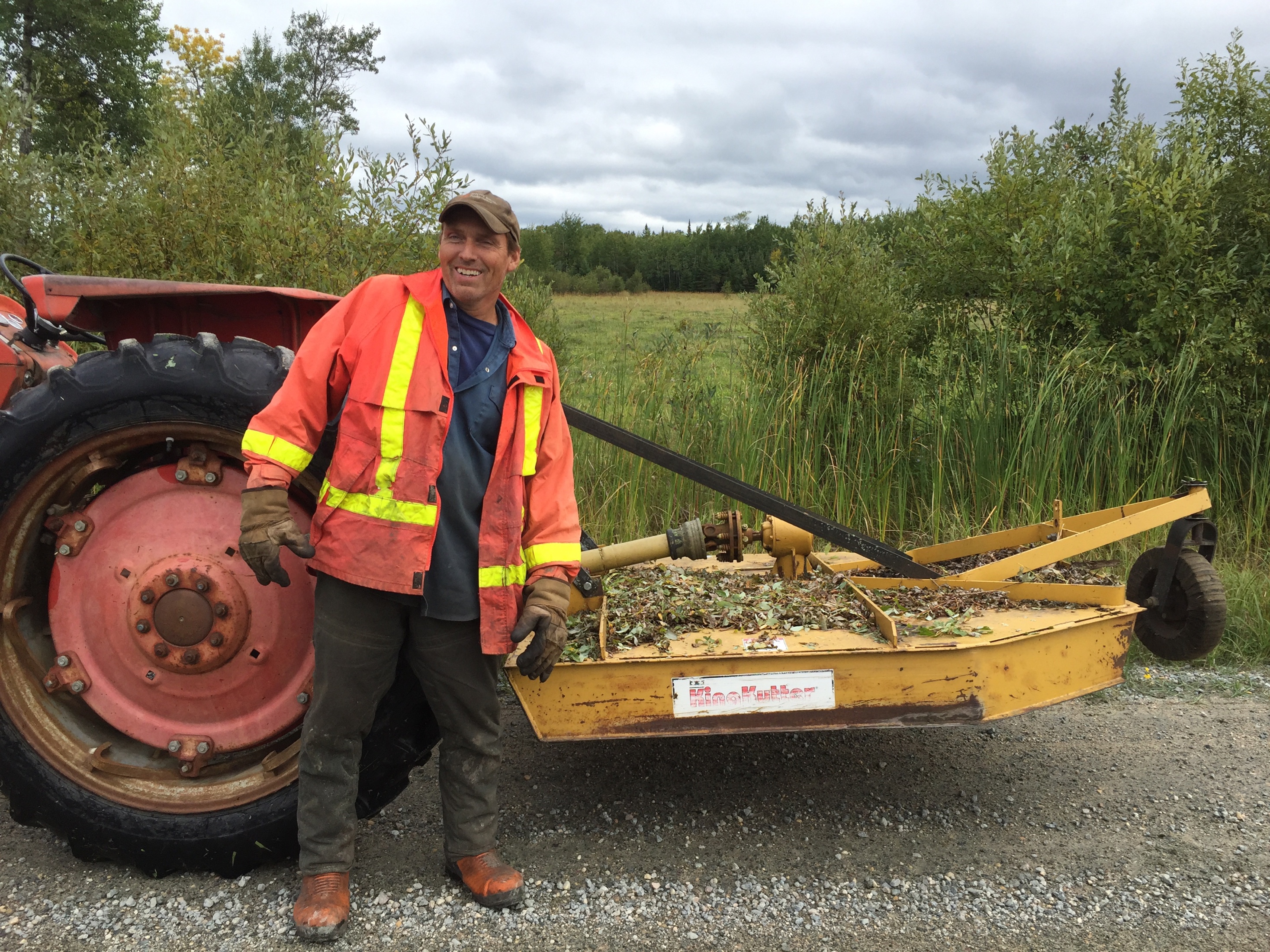

Looks worse than this 6’ hog I brokered a deal for up in Ontario. A friend there bushhogs shooting lanes and bought a new one after beating this one up pretty good. Neighbor by my camp was interested and since they could never link up I took the $75?cash down to the owner, and the neighbor finally picked it up. He said it was quite a bit heavier than he figured on his smallest tractor but got it home and runs it. He’s a logger & raises beef cattle, and wasn’t too familiar with these little contraptions.
