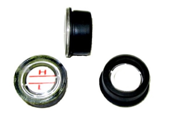

Maybe someone with an LK will chime in, but I'll say if its part # T4240-14212 it appears to just be a rubber push in with a sight glass face. The parts diagram I'm looking at over at Nolts Power Equipment, as well as MIE show its either part# T4680-14211 or T4240-14212
that second part number brings up this picture in google
If this is the right part, looks like it has a bit of a taper, and is made of rubber, once you pop it in, that lip should keep it in and sealed. If its old and the rubber is hard, it may not stay in well anymore. If it still goes in firm, and feels mounted, but still comes out randomly, make sure your front axle vent is clear, so you know the axle case is not pressurizing while its warming up during use, thats bad for a number of things.
