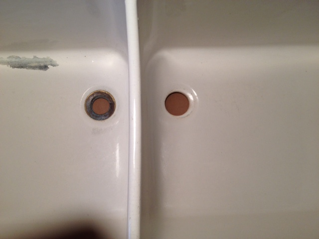

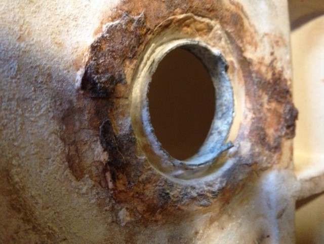

IMG_5755.JPGthumbnail_IMG_5752.jpgthumbnail_IMG_5752.jpgthumbnail_IMG_5756.jpgAgain, many thanks for the helpful comments.
This sink came from a large kitchen in an historic Philadelphia mansion. The sink "sits" on a stand. It is believed that the sink dates to about 1920.
Some additional photos attached.

Hello all.
The old drain removal problem has been resolved! We just slowly picked away at the old plumbers putty from underneath and the fitting "popped-out". I guess we were a little too worried about this but we didn't want to break the sink.
On Monday we will remove the existing sink and its support system and layout the installation of the "new" sink. After that we'll re-route the supply plumbing, order a new vintage faucet and start to put everything in place.

Good result! It was apparent from your later photos that there was nothing left except hardened putty (or SOMETHING!?). Glad it wasn't epoxy or something that a previous owner used!
You should be OK to use almost ANY chemical to clean any remaining residue. Vitreous china is essentially the same thing as your toilet. Intended to be impervious to most anything, but can be a bit fragile where mechanical force is involved.
As noted above, please go back with a high quality replacement basket, use a liberal bead of good plumber's putty and snug the new basket down gently. I find it works well to snug a new one down, then wait for and hour or so for the putty to slowly "flow" out of the joint/gaps, and then re-snug. Maybe repeat two or three times.

Are you sure it's not an old farm sink made out of fire clay?
   / Vintage Kitchen Sink Plumbing Connections -- HELP!
#20
That is a great question.
I only know what I was told by the seller.
How could I determine if it is fire clay? What does one look for? I can take more photos if that would help.
How is a fire clay sink made? Is fire clay durable in a kitchen sink application?
I love solving mysteries. I'm open to all comments on this.
