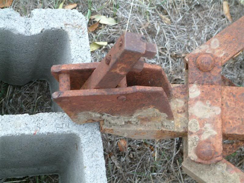

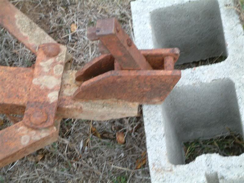

Has a funny looking hitch. Don't know if there's a part missing here. Probably will have to rig up an adapter to the 135 drawbar.

Flusher, can you get a closer shot of that hitch? I have a thought involving how it hitch's and what, if anything, may be missing.

I recommend to operate it first. The hitch adjusts the gang angle!

FWJ:
Here they are:
   / Vintage tandem disc-latest find #6
Yep! Parts missing....I'll try to get a picture of the complete hitch, or at the very least, a good description of the missing parts.

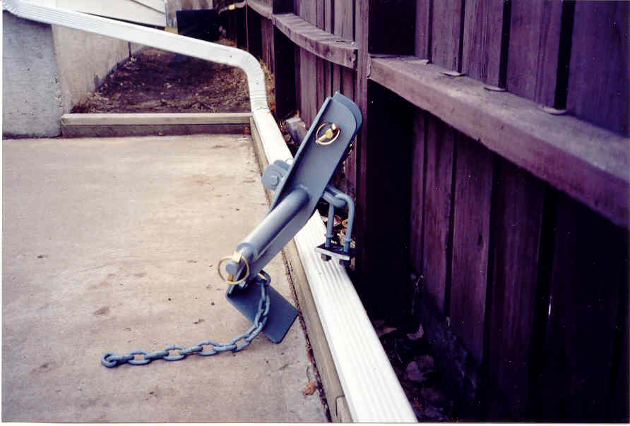

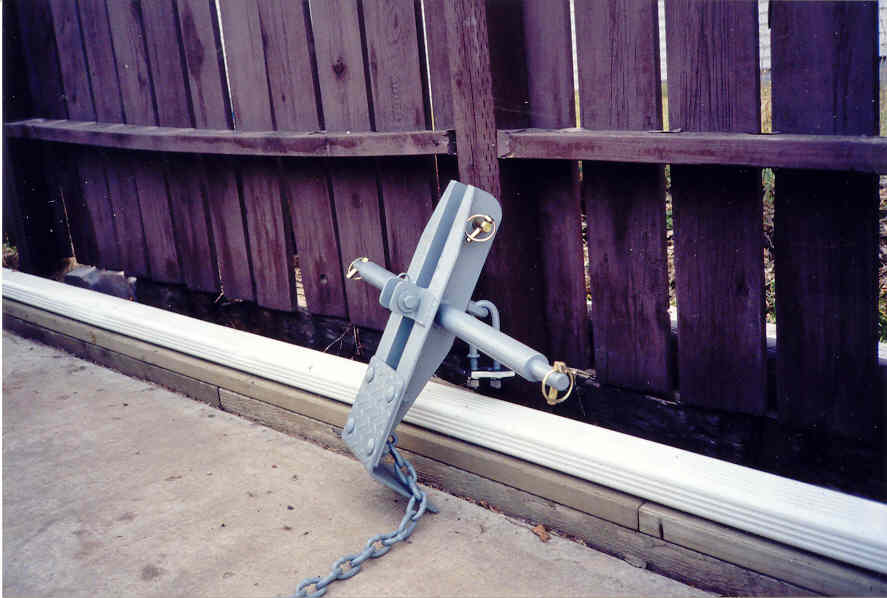

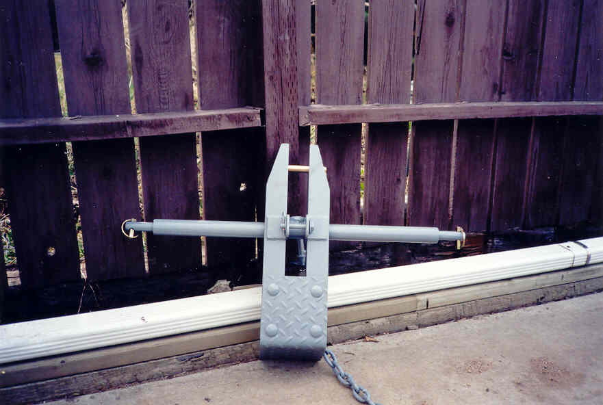

This is what's missing - made one for a friend. Hope these pics come through.
There is a pic on page 88 of "Ford Tractor Implements" by Peterson & Beemer.
That is all I had to go by. It works very well.

Thanks for the info.
My guess is that the hitch on my Ferguson disc is supposed to connect somehow to the drawbar rather than the 3pt hitch.

When the Ferguson tractor first made its debut, there was no "fixed drawbar" under the rear end. Harry Ferguson's logic was such that he wanted ONLY 3-point equipment used on his tractors. That disc was produced and sold during the time period when the "drawbarless" Fergies were built. If you wanted a Ferguson tractor and a Ferguson drawn disc, you EITHER used that hitch pictured above, OR the 7-hole drawbar that goes on the 3-point lower links. Ferguson also realized he would sell a few of his pull-type disc's to owners of other brands of tractors. There was a clevis style hitch available, as well as the original version of the fabricated hitch shown above. I've looked through my stash of old Ferguson sales literature and still haven't found the picture I'm searching for. That's the shot of the most basic hitch, the clevis style.

FWJ: thanks for the info.
I'm confused. Is that hitch on the Ferguson disc I have supposed to mate with the 3pt adapter Hank shows or does it mate with the drawbar?
So far I haven't figured out how the hitch on the disc I have connects to that 3pt rig. I would prefer to pull it with the drawbar rather than the 3pt.
