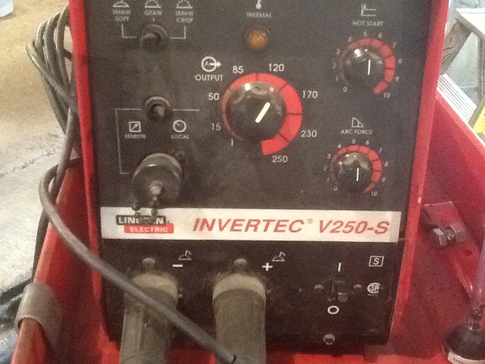

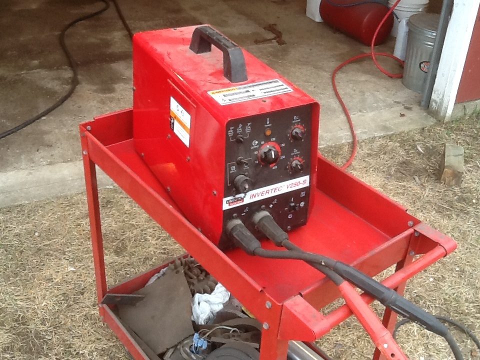

My invertec v250-s tig/stick is DC only - it's only drawback is I can't tig aluminum with it.
