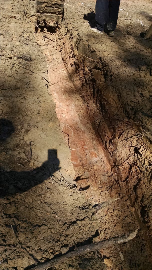

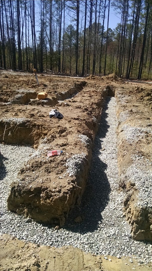

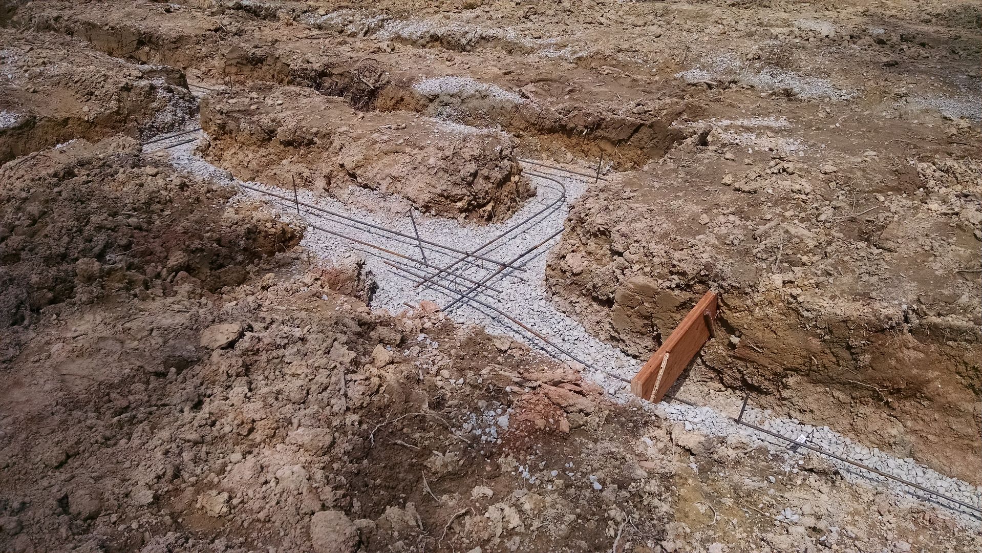

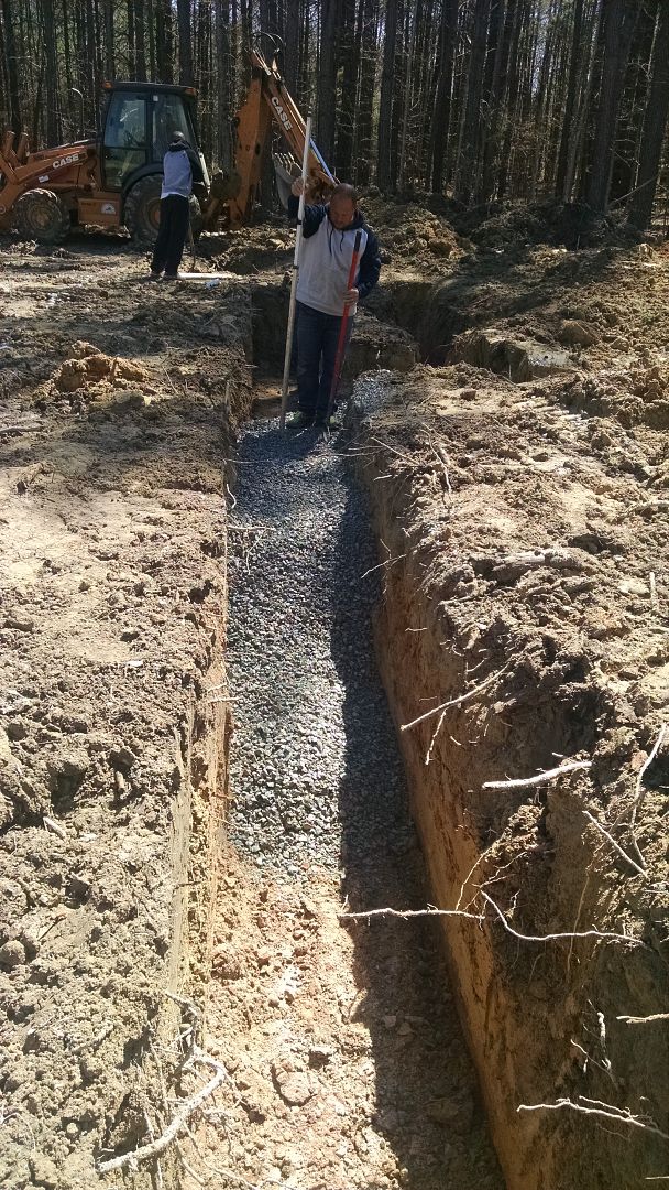

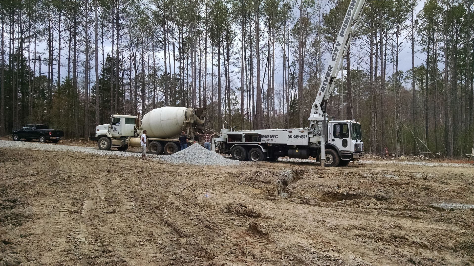

Footing were dug this week. Continuous footers. Engineerdesigned and stamped for County Approval because of the shrink swell soil in the area. Footers were dug 24" below frost level at 18". Rebar over compacted gravel.

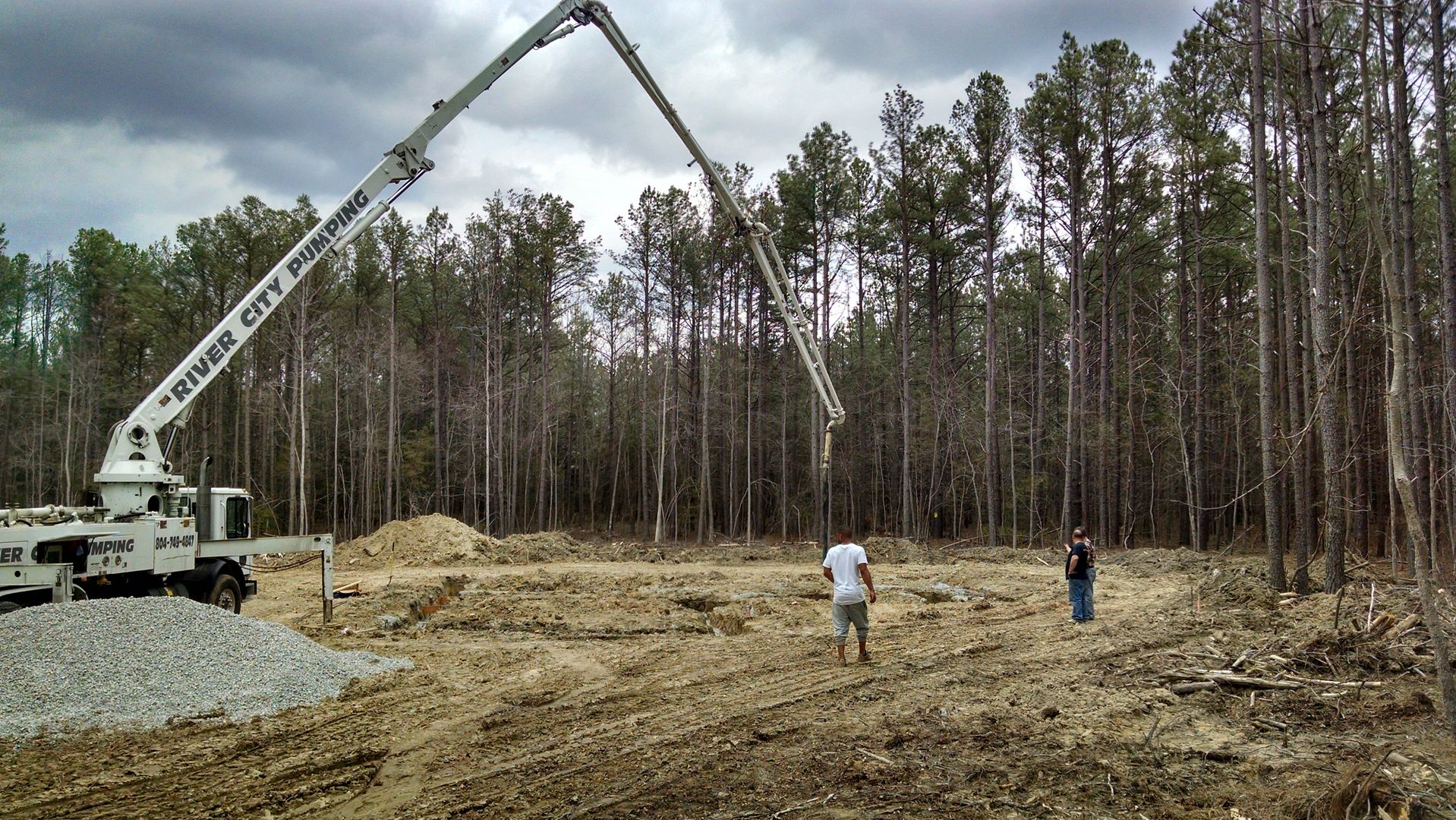

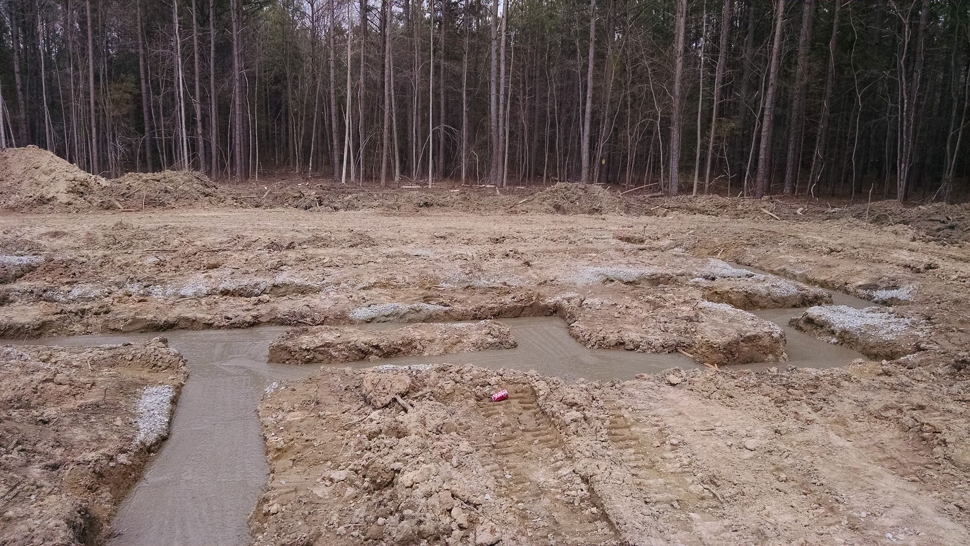

We had to tailgate 3 more yards of concrete when we came up short. We had to release the pumper truck since he charges about $150 per hour (minium 3 hours) and $6 per yard to pump. The house will have a 22' x 26' garage attached to the house. The real garage will be in the back yard.
Pole Barn Garage pad is ready for the barn.
I had an additional 40 tons of fill dirt delivered to raise the garage.
The garage should start in two weeks. We had to wait on the delivery of the pole protectors.
Garage will be 36' x 60' x 12' with a second floor that will have a storage room that measures 14' x 60'.

Lots of concrete but it looks like your foundation design spreads the soil bearing load out pretty good. It's probably appropriate for your soil. The foundation is no place to skimp.
Getting concrete down is a nice milestone in your project. :)
