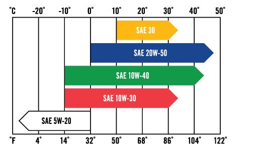

Likely beating a dead-horse but I am not sure why manufacturers use these type of charts. What does the arrow mean, anything above the last temp, good to the next temp, or try and interpolate the temp the arrow point ends at. This is for an air cooled 17HP Kawasaki engine and 10w30 and 10w40 are both recommended by Kawasaki in different areas. Also, the engine only has 5hrs on it and this will be the "break in" oil change, should I just go with straight 30w is that old school.

I would guess they are implying that the arrow means you could use the oil at temps past the arrow, but at higher ambient temps the oils that proceed further to the right are better choices.
I run 5w30 in my Kawasaki 14hp mower, but have also used 20w50 in the past. I personally would not use a straight 30 weight.

Couple questions.
What is the application? Something running full tilt big load like a mower or zero turn? What season do you use it? I cut my teeth on air-cooled engines, VW/Porsche and small engines too. Air cooled engines run hot, next time you use your machine for a good period doing whatever it does take your oil temp using an infra red gun on the crankcase or the oil itself.
Most temps I see are 230f and up on a warm day. Some of the newer air-cooled small engines have an oil cooler to help with the heat. None of these warmer applications work well with low viscosity oil, it's just too thin at temp.
Old VWs used straight 30 detergent or 20W-50. I have a new Exmark zero turn and they recommend 20W-50 full synthetic in fact they market their own oil and show you why it's so important to use a heavier oil in their applications.
Porsche recommends 15W-50 in all of their air-cooled engines even retrofitting back to the 50s.
I personally wouldn't use 5w-30 or 10w-40 in any air-cooled app unless it's low heat low load.

The only way those charts make sense are for air cooled engines. For water cooled, there is no upper limit because it's set by the thermostat in the water cooling system.
10w30 is probably the "old school" 30w.
Personally, I'd use a good 5w30 synthetic. I just buy Castrol 5w30 at my local VW dealership for their diesel cars for my 2 diesel engines. The 5w30 would give you some more protection for the upper valve train at startup, e.g. the oil pump would start pumping it faster than it would a 10w30 and get it to the valve train on startup quicker.

Thanks for the input, it seems motor oil might be the most researched topic with no definitive solution, even the manufactures differ wildly on the recommended temperature range of oils. Briggs and Stratton says straight SAE 30 is good for over 104F.
Went to a lawn equipment dealer yesterday and he says Kawasaki now recommends 20w50 for all V-Twin air-cooled engines and after researching their website I found they do say "their" branded oil 20w50 is good for hot weather operations but don't actually recommend it or any weight oil for their engines. Also they have not updated any of their engine owner manuals to include 20w50, it seems likely they are more concerned with leaving wiggle room for warranty claims then actually telling owners what oil weight is best for there engine.
Again I would not be so overly concerned if this was not a brand new engine and I want to ensure I do not void the warranty and ensure a long life. My gut tells me the best oil would be a 15w40 SL rated diesel oil but I can't find any documentation on if doing that would void the warranty.
This is a 24HP FR730V on a big ZT mower which runs WOT for 1 - 3 hours every two weeks.

I would highly recommend 20W-50 for your application.
10W-30 and straight 30 at 230F are NOT the same oil.
Take the oil temp, you'll crap yourself when you see how hot it gets.
