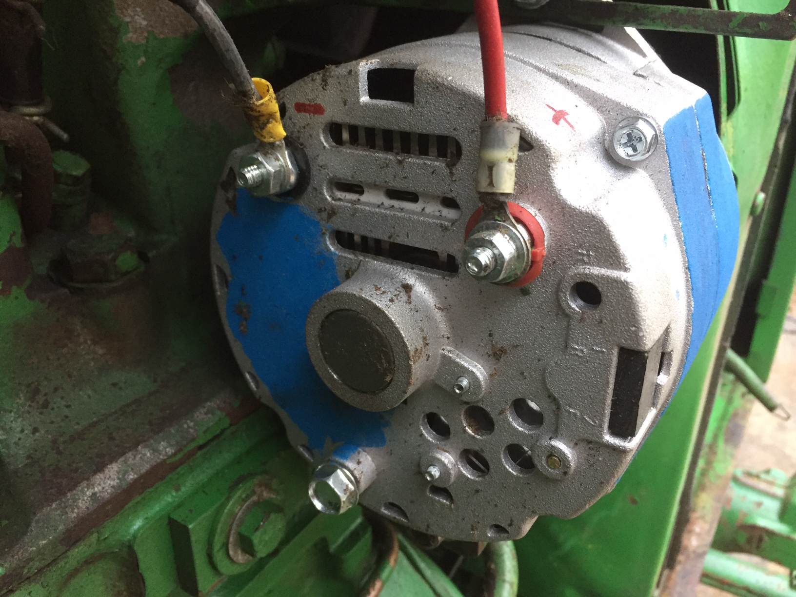

Just installed a new 24 volt floating alternator on my 68 3020 diesel.
It is installed properly with the connection point between the batteries grounded to the tractor chassis.
It is a 2 wire alternator with the + AND the - terminals isolated from ground.
Here is the issue:
when tractor is not running the voltage at these alternator terminals is 25 or 26 volts ( just what it should be - the two batteries in series )
when the tractor is running the voltage goes from 30 or so at idle , all the way up to 38 VOLTS at faster engine speeds
I thought these style ( "1 wire" or 2 in my case ) were internally regulated?
any body have any ideas ? thanks!

this is a Delco 10SI Type alternator
bought from Brillman Co. ( Home - The Brillman Company )
#BALT011 " 24volt, 40 amp alternator with isolated ground, 1 wire "
( since ground is isolated, there are actually 2 wires +,- )
this tractor has never been converted from 24 v to 12v
both the 24v starter terminals are also isolated from ground

I've worked on many of the 24 volt systems with generator, but never with alternator. I assume your alternator leads connect to the starter battery terminals? What voltage reading are you getting at the batteries when running? Check them individually. What condition are your batteries in? I have run into occasions where batteries being bad causing high charging voltages. If batteries are good and alternator is connected properly, I think you got a defective regulator in the alternator.
/ @$ volt alternator 3020 #7

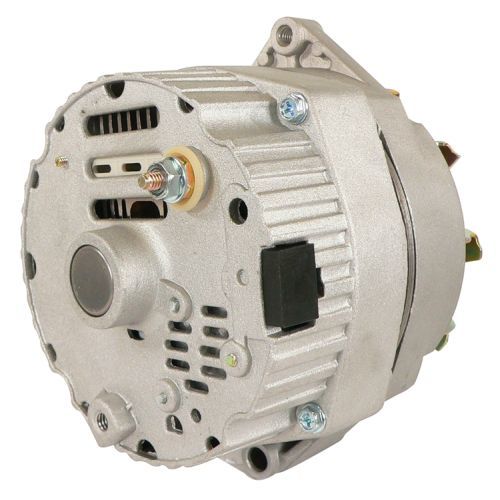

I agree with jd110 in that if alt is connected per instructions then internal regulator is faulty. I'm curious as to where you attached the 2nd wire as I only see one electrical post? Maybe 10SI alt I Googled is incorrect model as it is a one wire.
/ @$ volt alternator 3020 #9
OK I Googled incorrect alternator. What is the brand & model # of your alt?
#11
Returned Alternator to Brillman Co. They tested it and found internal regulator faulty. It's in shipment back to me. They refunded my return costs. Good company. !! http://www.brillman.com/
