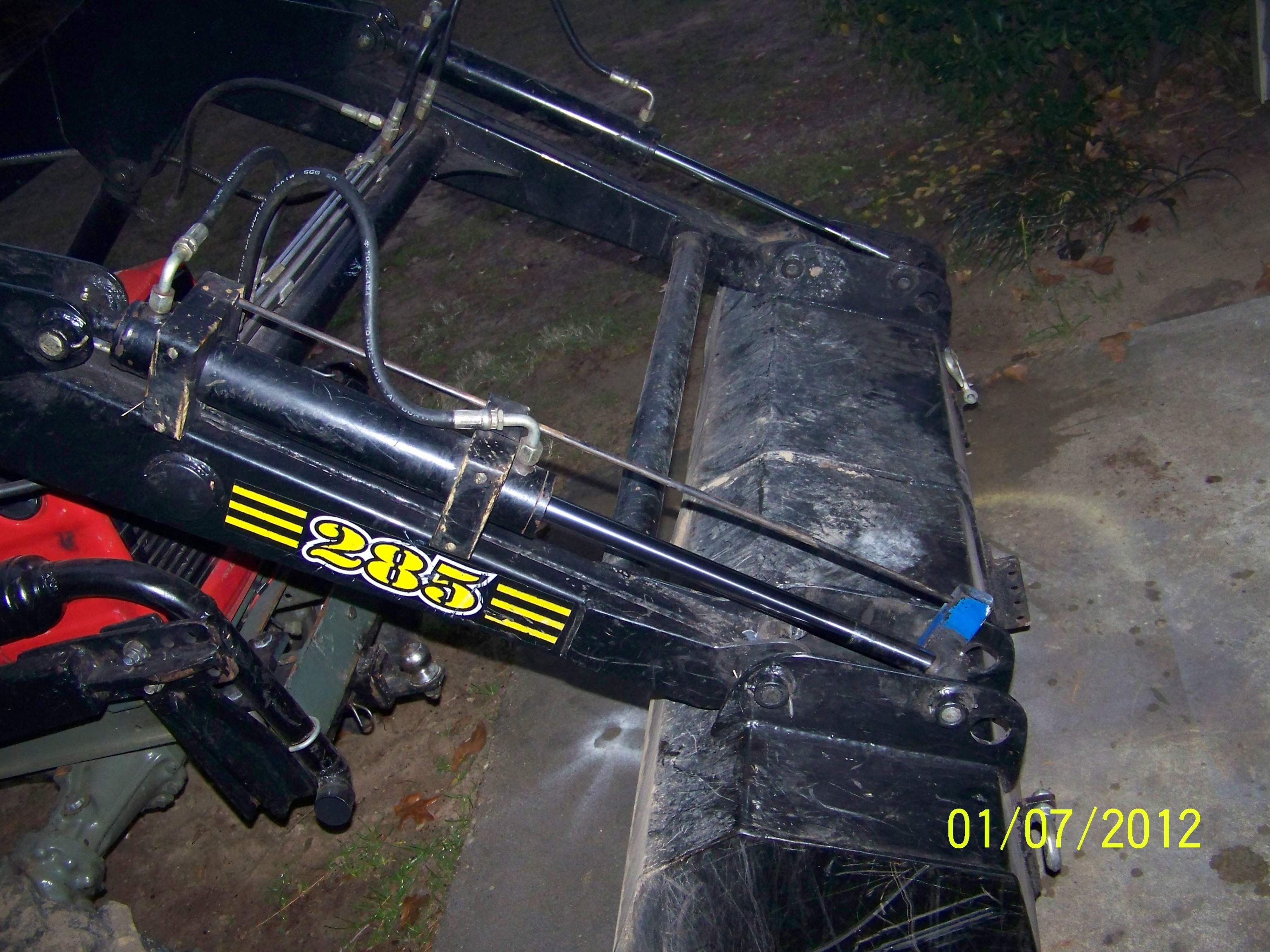

/ Vtek V2 Loader #27
I built a level indicator for my bulldog awhile back. I got the idea from a picture of a John Deere loader. It works pretty good. Daylight comes I'll take a picture or two. Not saying it is the best but it works.
/ Vtek V2 Loader #28
As promised, here is my contraption, for what it is worth. Works ok for me.
Picture 1 shows the little paint line on the 5/16" metal rod right at the 2x6 rod guide. This is the level position (parallel to tractor). When I am wanting to made a shallow cut with the bucket I would move the top of the paint line down to the guide.

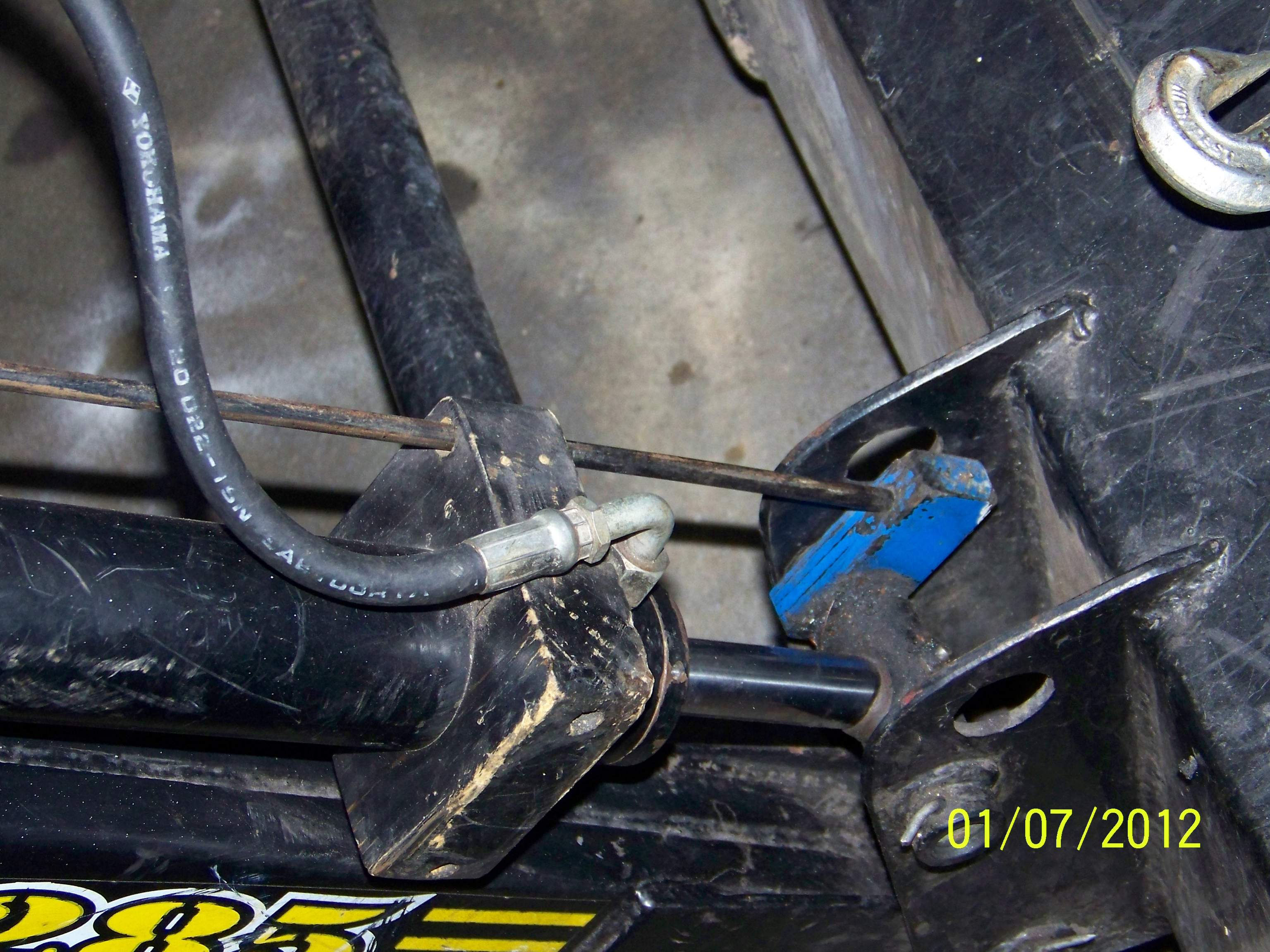

Picture 2 shows the bucket curled completely and a good view of the 3/4" block that rotates on the bucket pin and the 5/16" rod is pinned in it.

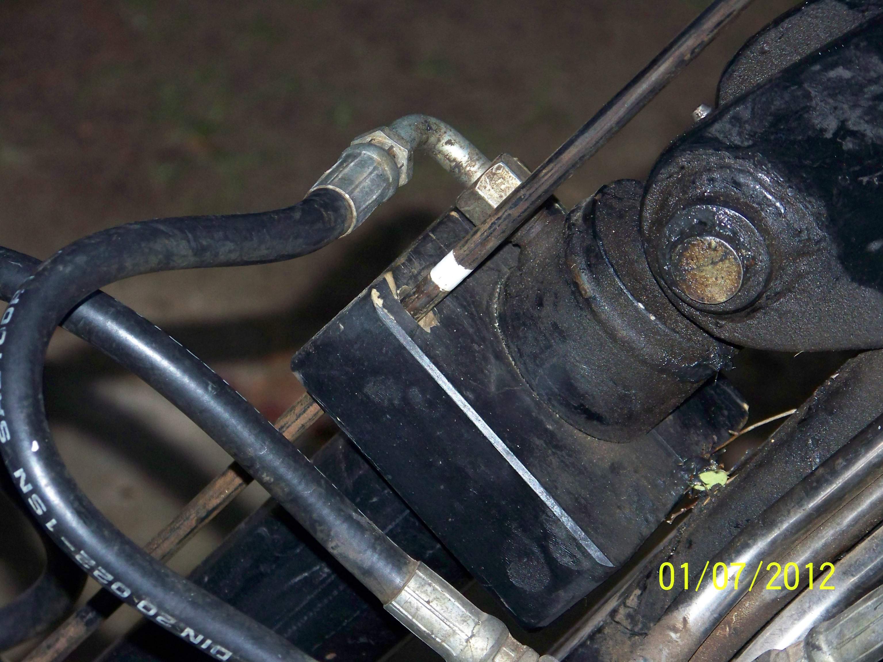

Picture 3 shows the rod position when bucket is fully curled under.

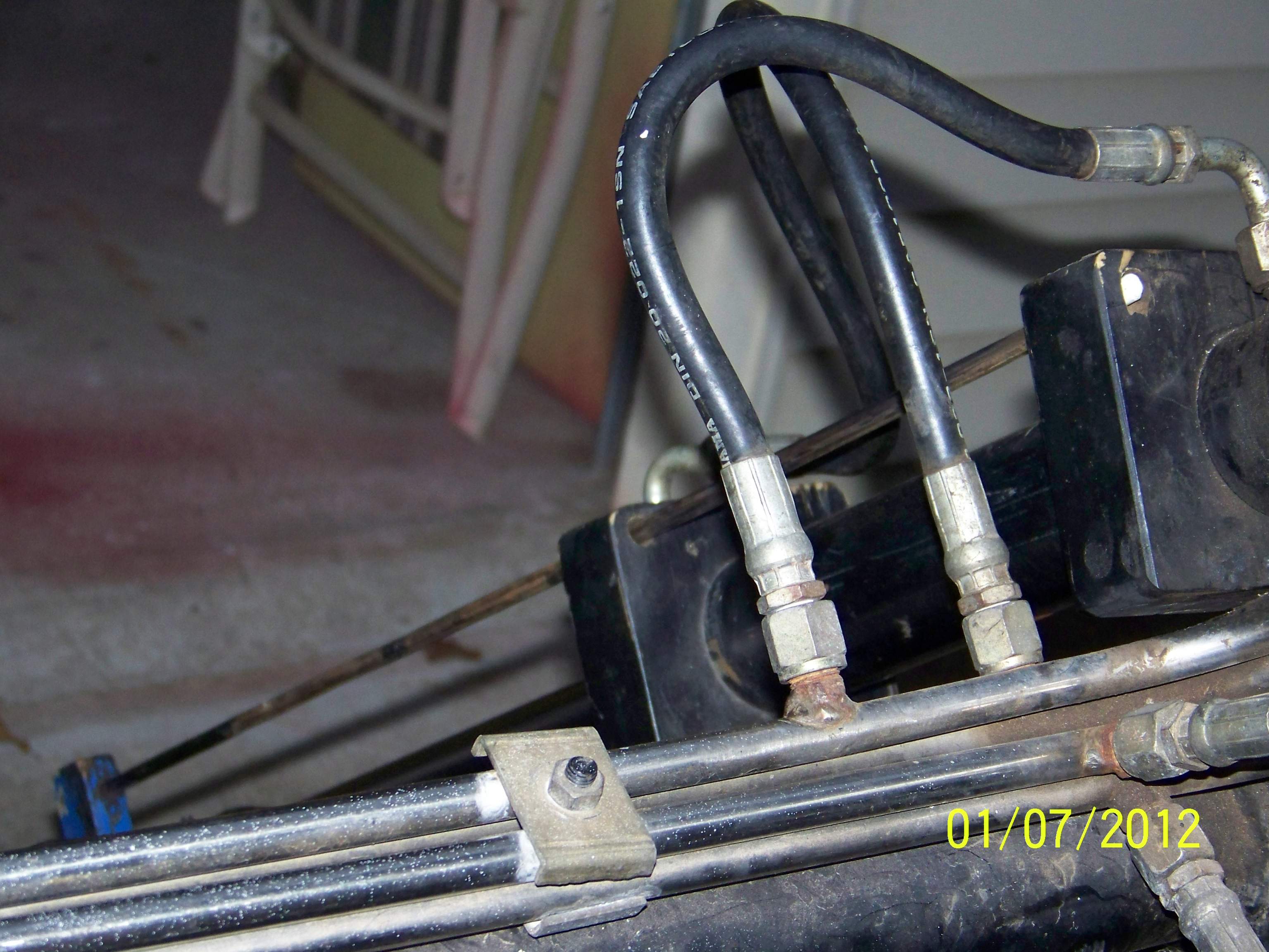

Picture 4 I am just trying to show a good view of the 3/4" attaching block.

This might not work if you have tie rod cylinders or numerous other reasons I suppose. It will work on a Bulldog 285 loader.
