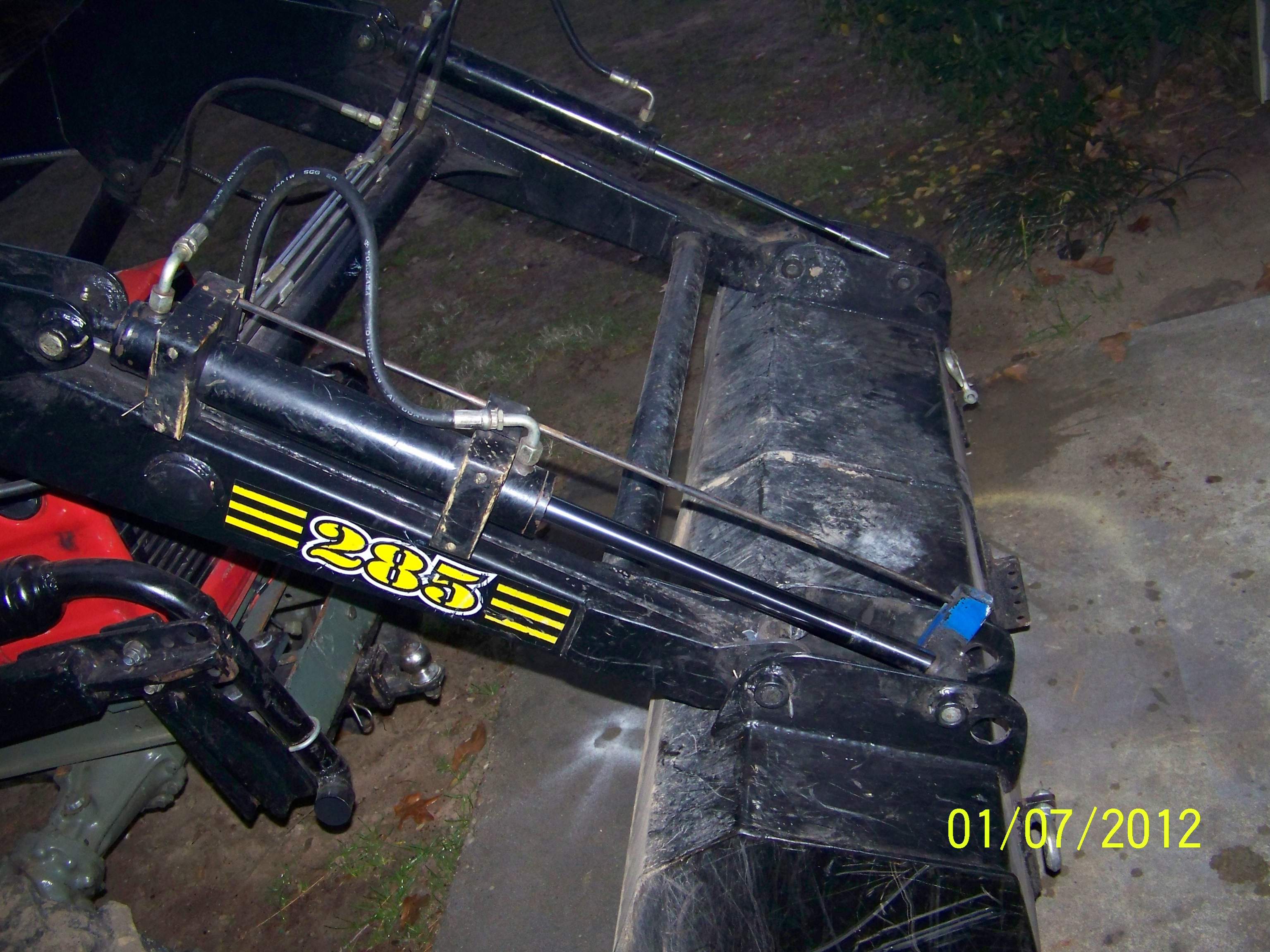

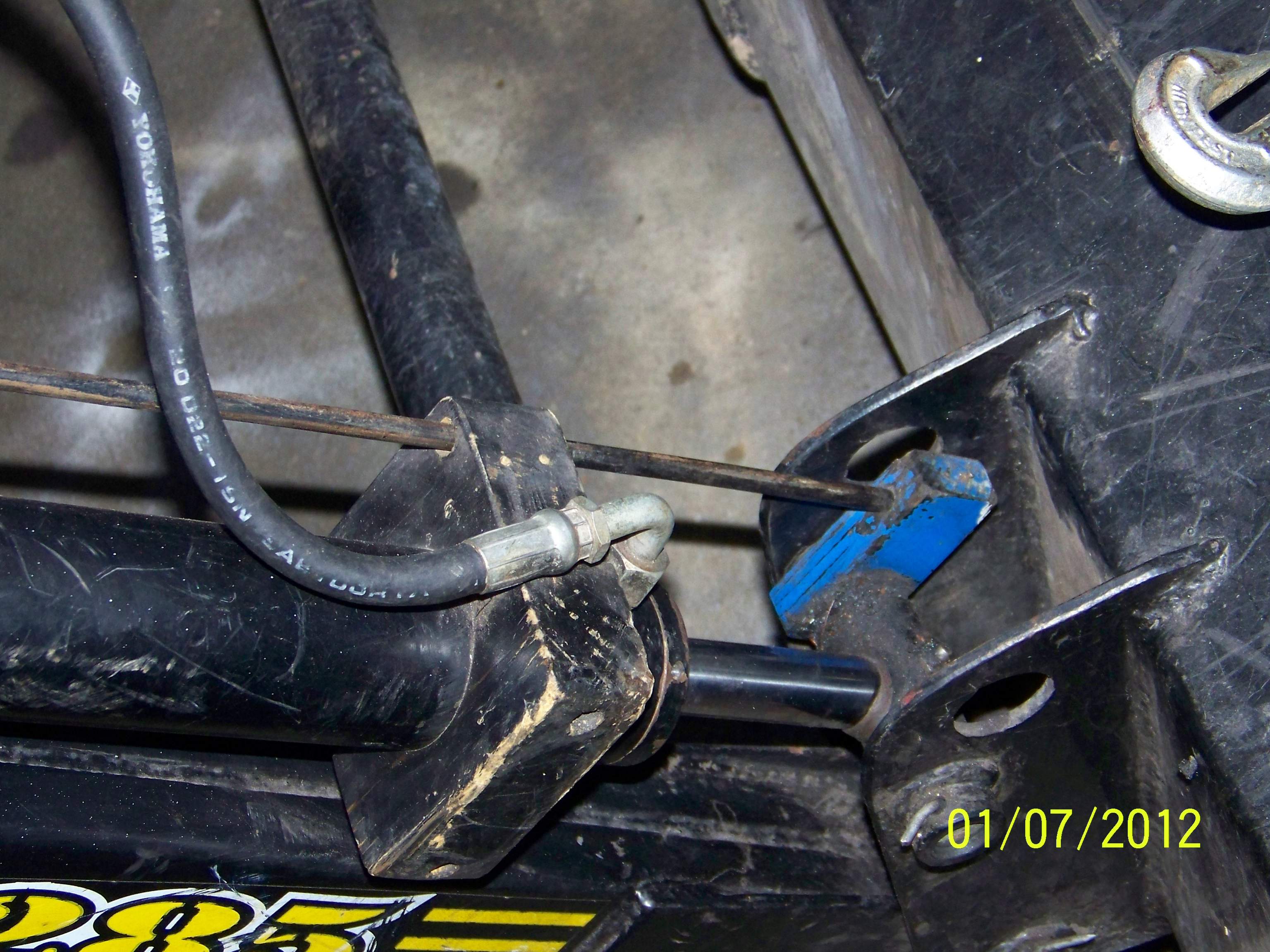

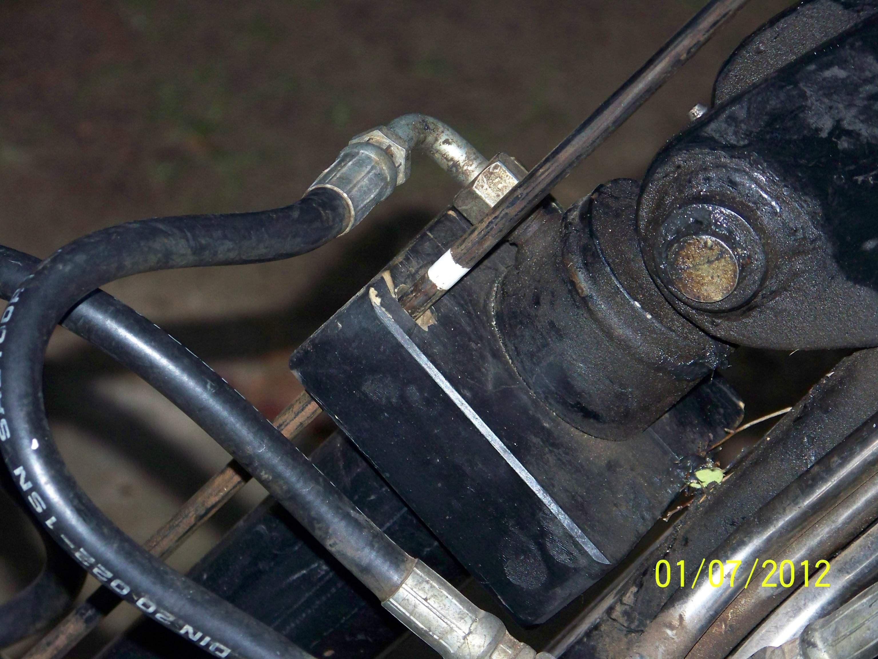

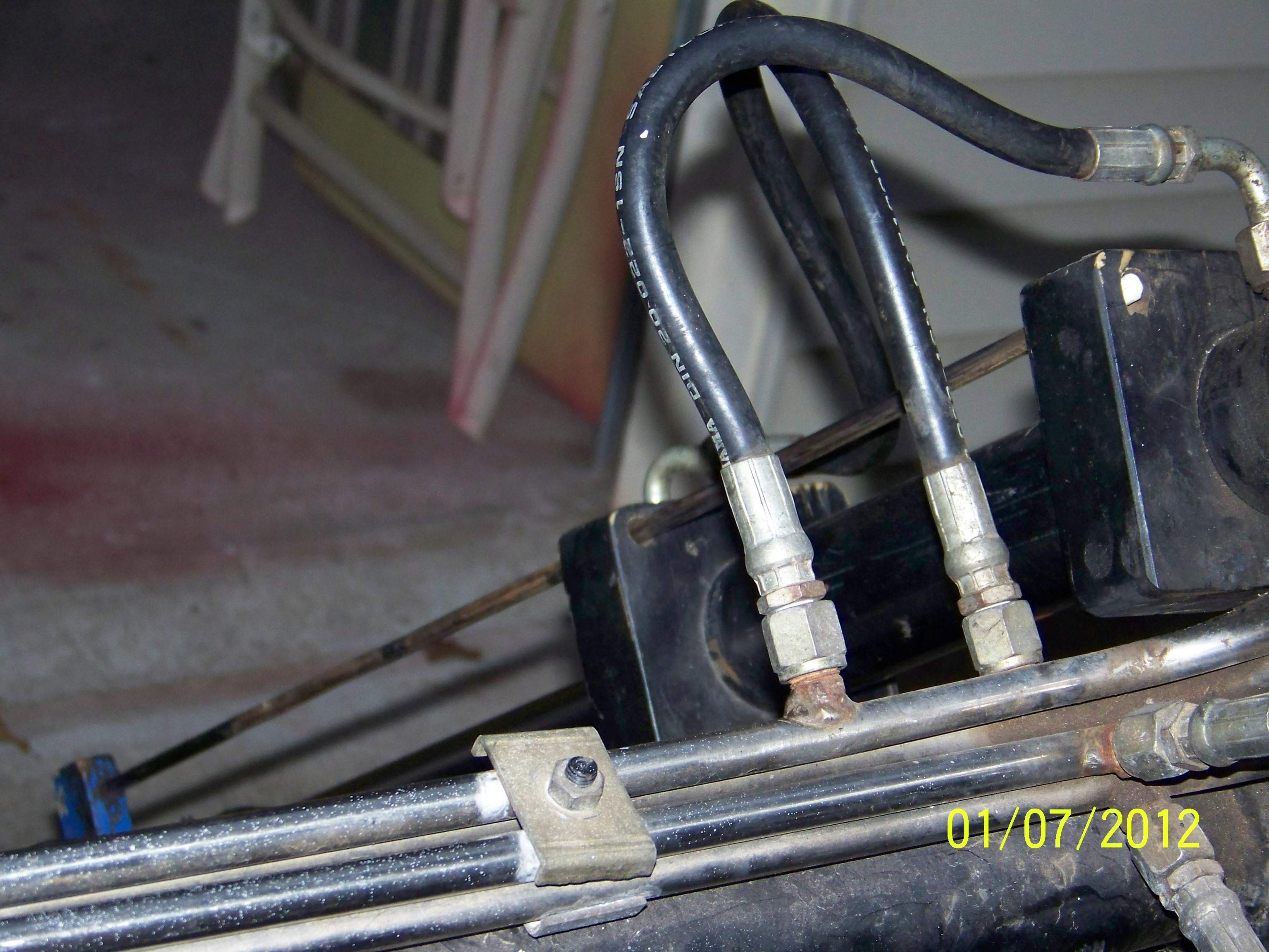

Here is woodcarvers bucket level indicator I built for him and if you notice he has the V2a I guess the "a" is the designator on the QA model its a nice loader btw.
I am not aware of any attachments being available now but I guarantee I could (and probably will) build something. If it didn't happen to follow any known standard being built now that is so anyone could just a matter of doing it.

Sure enough, I checked some photos, and mine is also a V2a. The quik-tach looks to be simple to use (and sturdy), just two pins.
I do like the bucket level indicator. It looks simple and sturdy. I hope you won't mind if I build one similar, as, with my short experience, it will really help to know what my bucket is doing. Thanx, RacinJason

Oh absolutely RacinJason feel free to use them or anything else you see on here thats is what we are here for have any questions fire away! :thumbsup:
I agree it is a simple attachment system and should be fairly simple to make stuff to fit I think anyway and the bucket sure would come off quick!
