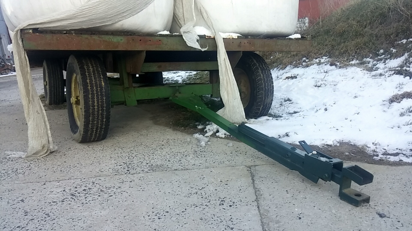

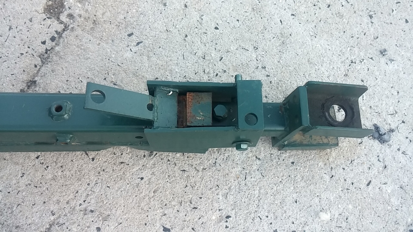

here's my extendable wagon tongue build for my round bale wagon. I used it all summer in 2016 pulling loads up to 12,000 lbs. Works great & simplifies hooking up to the tractor! The outside tube is 2". Found the tubing pieces at the local scrap metal resale yard. The rest of the metal was from my scrap metal pile. I welded the outside tube to the original wagon tongue.

what kind of spring did you use to hold the latch down?

I don't have a spring. strictly gravity. I have not had any problems with it staying latched.
