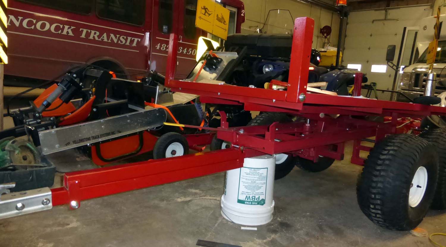

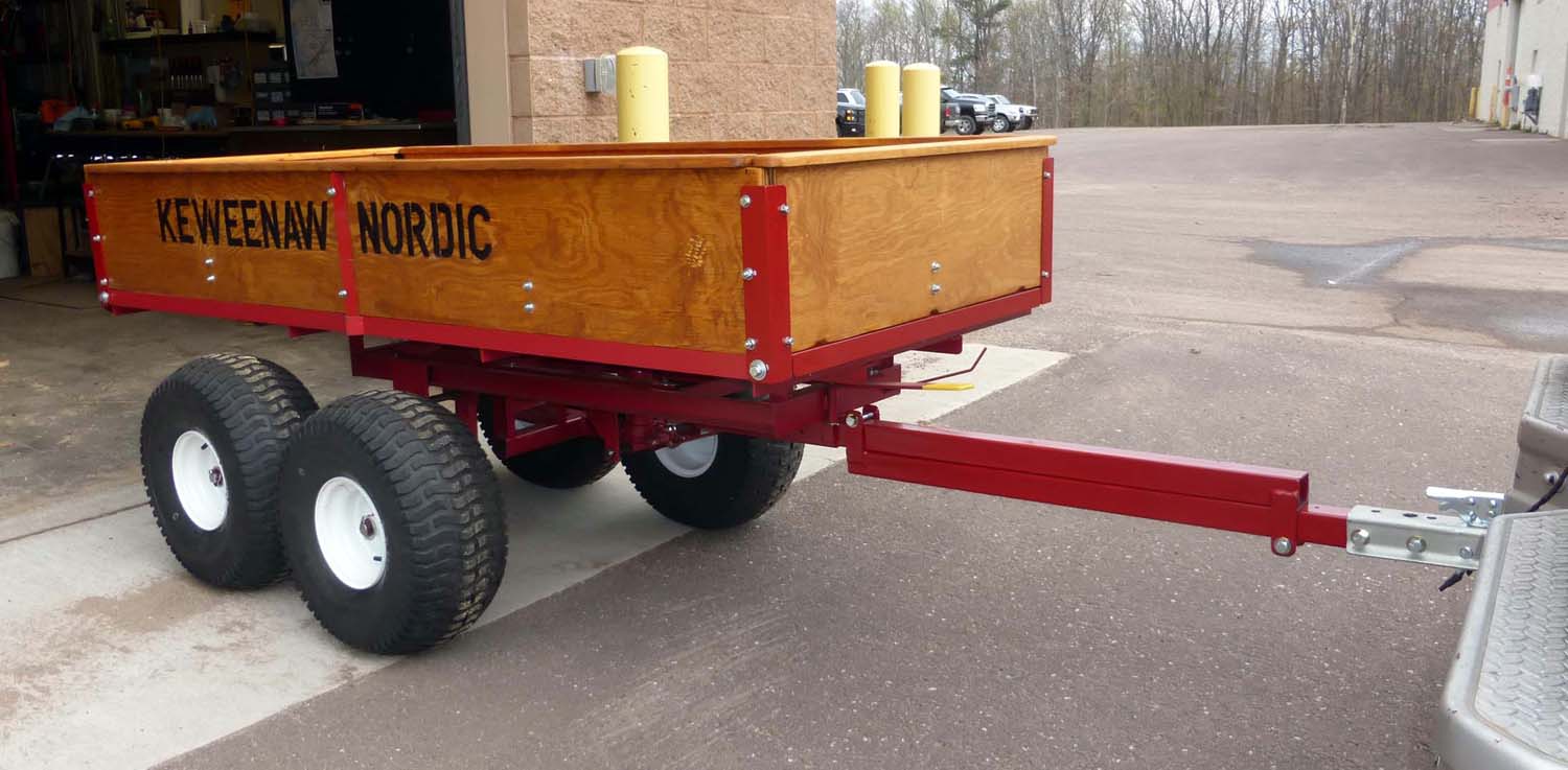

I'm not sure if this will help but here is photos of an adjusted length tongue we built for a UTV trailer. This setup worked very well for us. With one wench (or two) we could adjust it in 60 seconds. Of course yours need to be heavier duty. For $250, you might be better off to buy it.

looks good. thinking of using my square tongue. getting a round pipe and bore a 1 inch hole in it. cutting a hole in 2 pieces of flat piece of steel for the pipe to slide through and welding it inside of my wagon tongue. have to weld a piece of steel on the end of the pipe so it will not pull through. make a hitch for the other end. bore a 1 inch hole in my square tongue. mount a bracket over top of the hole so i can put a pin and a spring that will hold the pin in the hole when i back up. seem like it should work?
