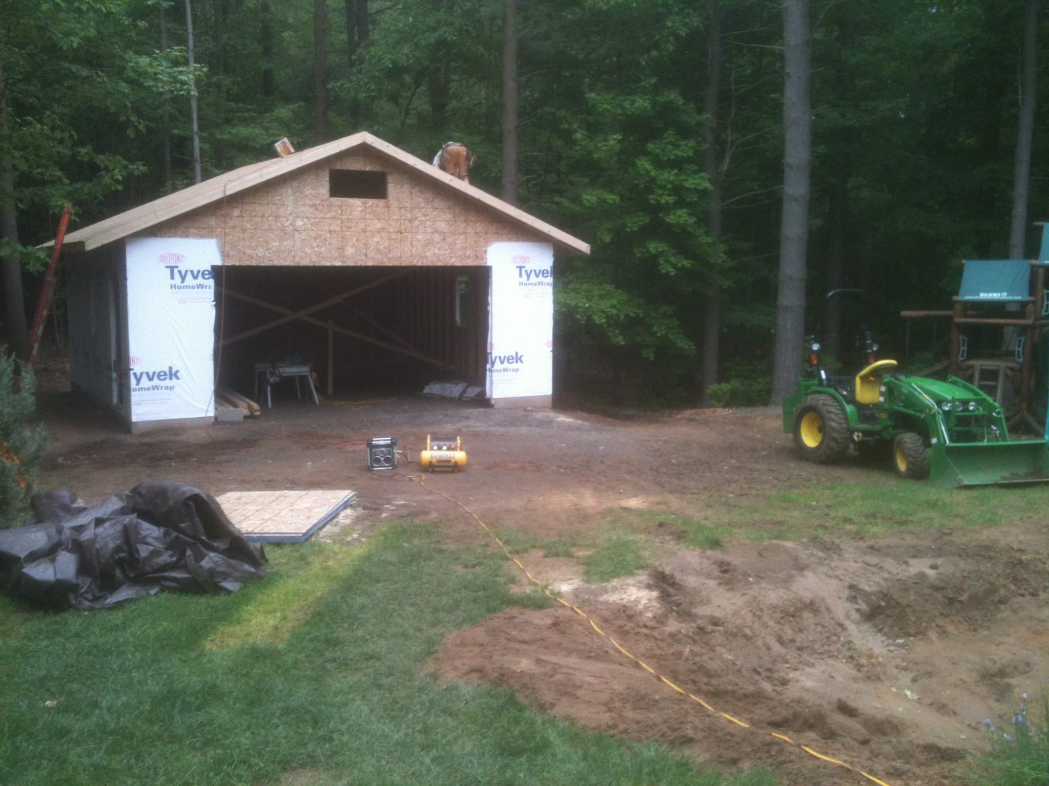

I know this doesn't come close to the guy who's building the new house in the woods in 90 days, but it's my own smaller version.
Can't wait til it's done. I need a place for my stuff.

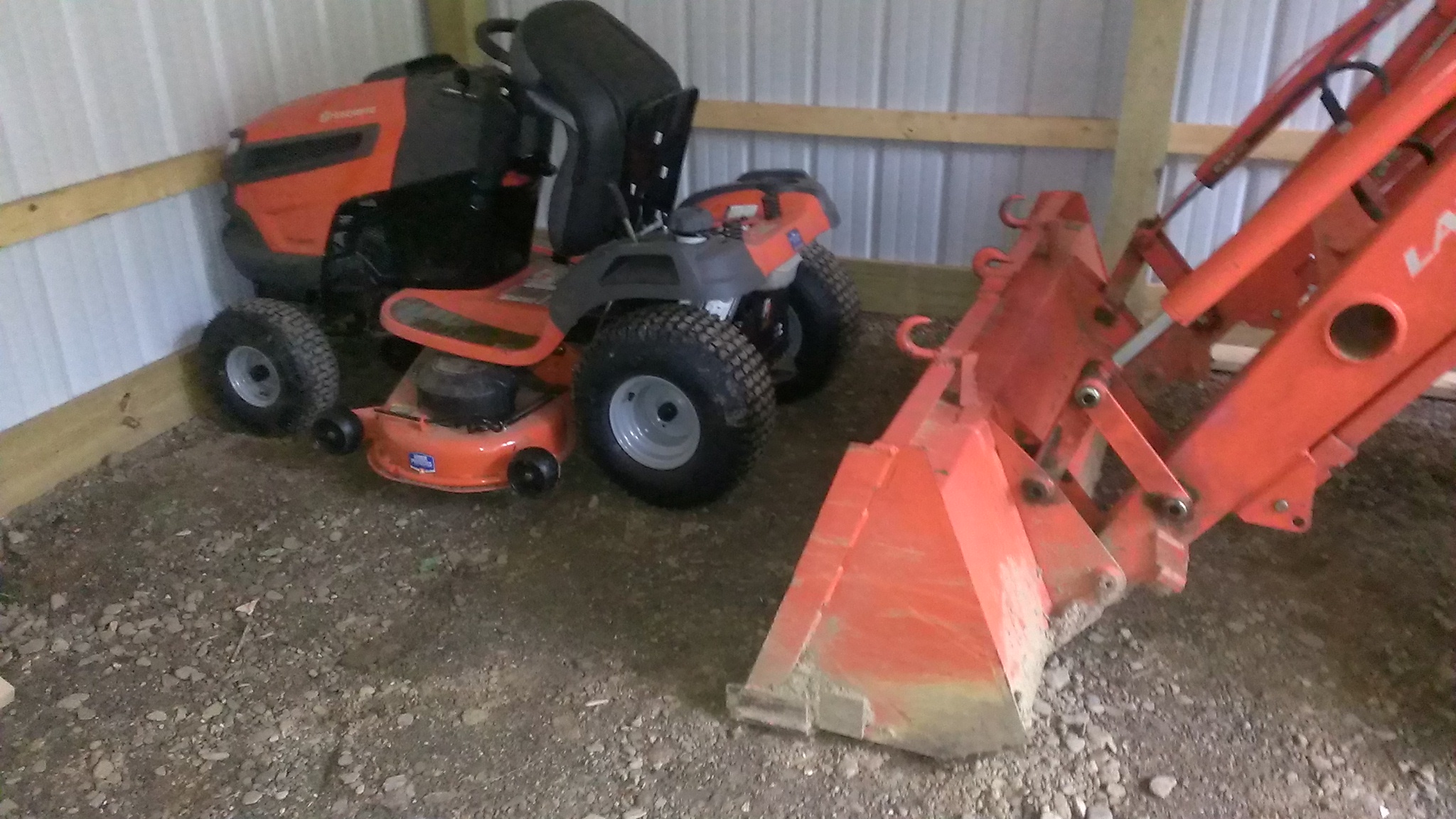

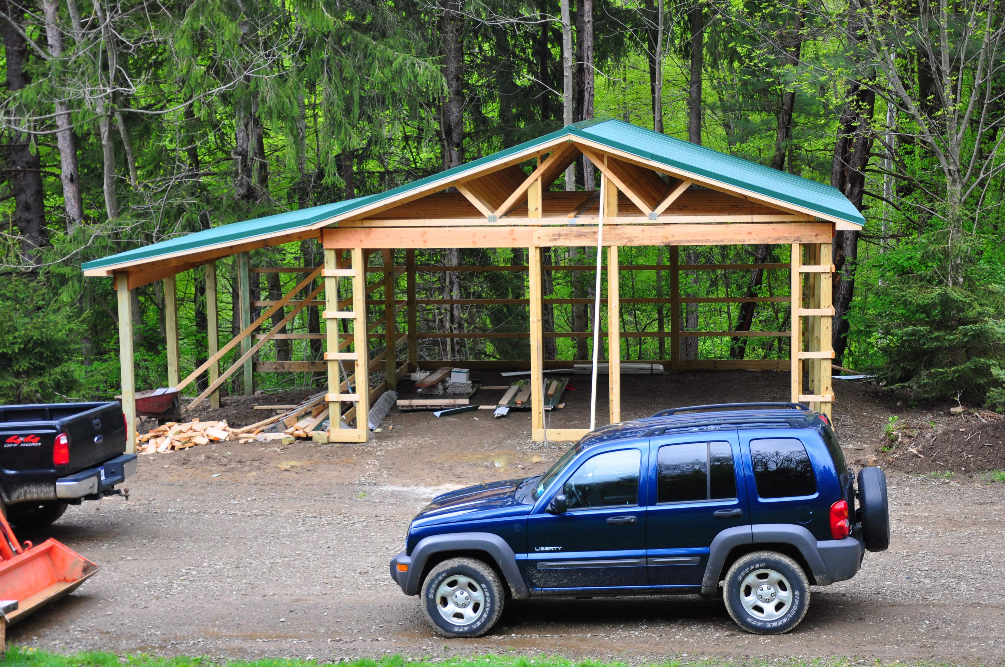

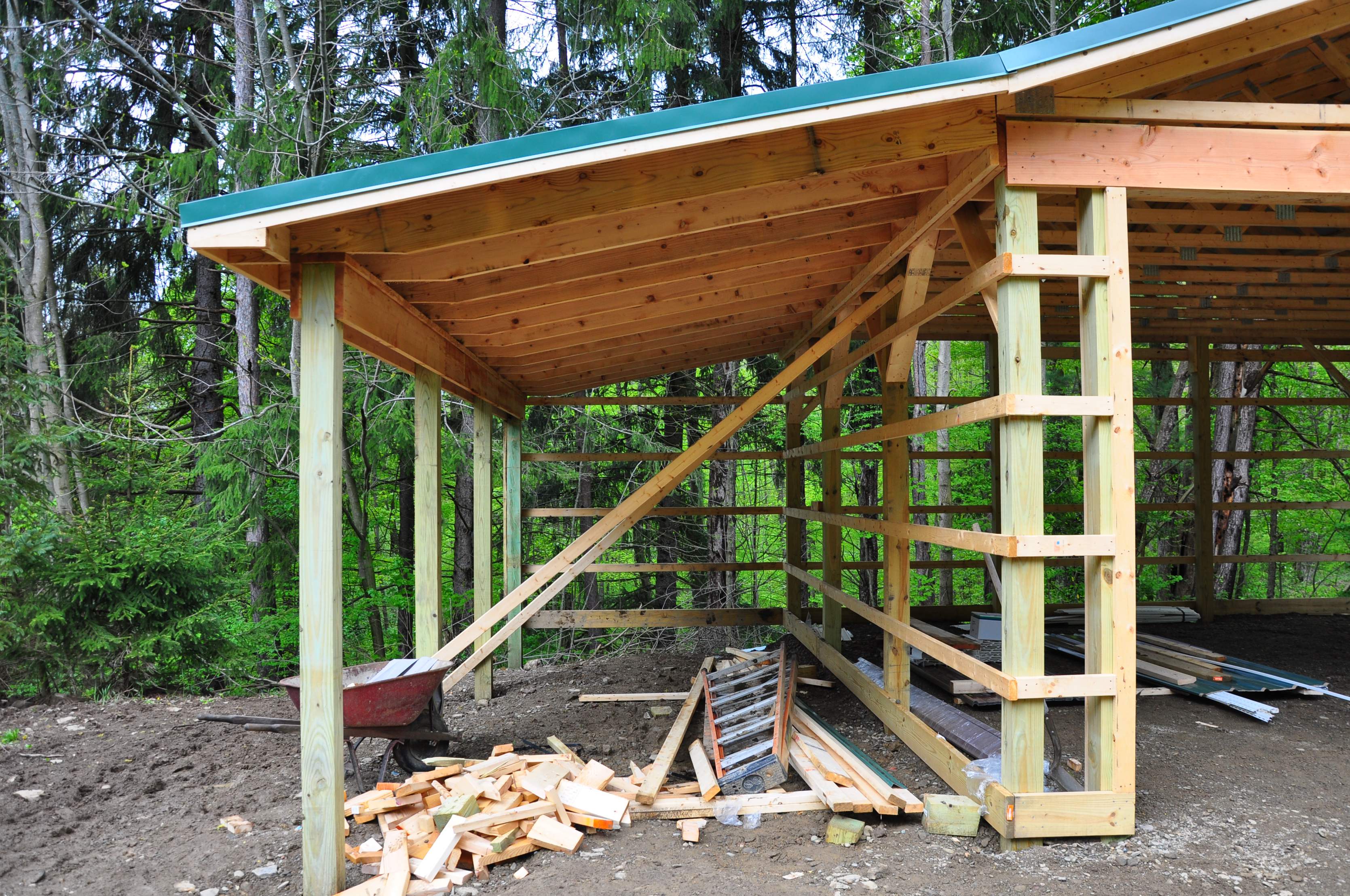

I feel your pain. I'm in the same boat....

Thanks. I went back and forth on the design features before deciding on what we built. I considered a hip roof and 20 x 20 but ended up with the roof to match the house and growing it to 24 x 24. It has 24" overhangs and there will be no gutters (I'm already on my house roof twice a month blowing out the pine needles and I want to stay off this roof). It's been built up quite a bit above the original ground level (9 courses in the back and 6 in the front) and it's all sand among the pines so drainage won't be an issue. I'm also grading the area all around it to shed as much water as possible.
I went with the block foundation because there was a pretty good grade change in that area. You can't really see it in the picture but it was there. They had to step the footings to account for that and we filled it in with two 10-wheeled dump trucks full of stone where there was no original earth. My father has a 30 x 40 pole barn and it's beautiful. It's also packed with his stuff. I guess it runs in the family.
I too would have liked to build it myself but like Clint Eastwood said, a man's got to know his own limitations.

Very nice building and a familiar setting. Is that bay on the left going to be like an open carport type of space? I thought about doing something similar but was limited by my property line and the scale of the project. My wife and I agreed to keep it relatively small so it didn't look out of place so close to the house (It's only about 60 feet away). I also like the metal roof. My pine needles wouldn't have a chance.

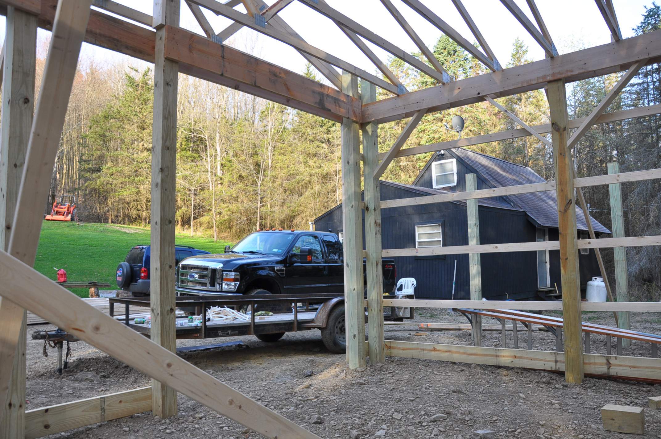

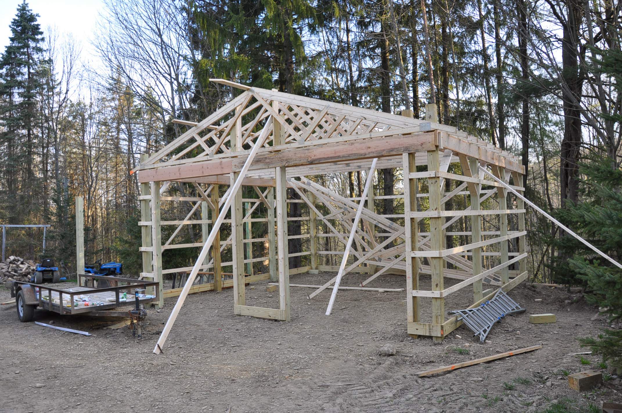

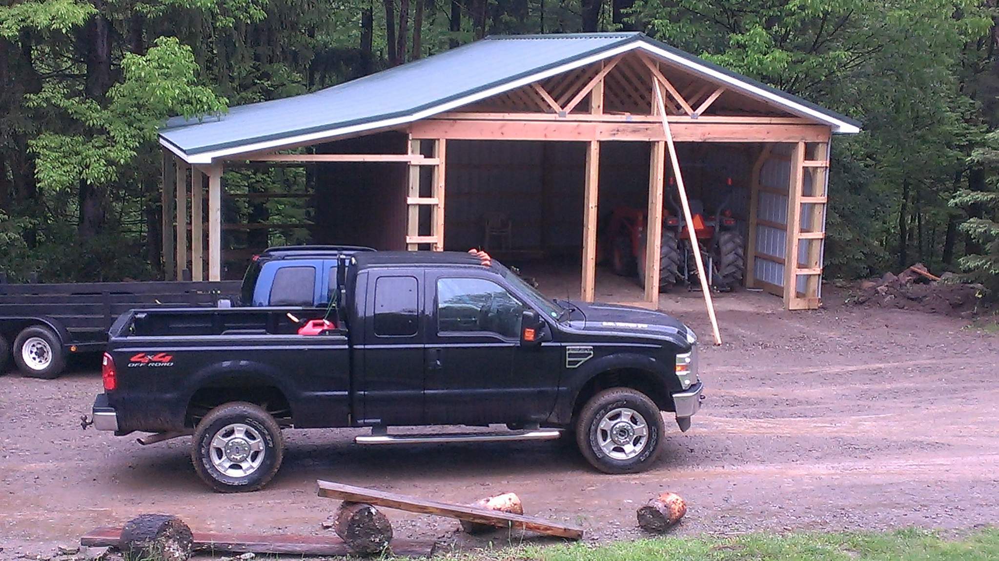

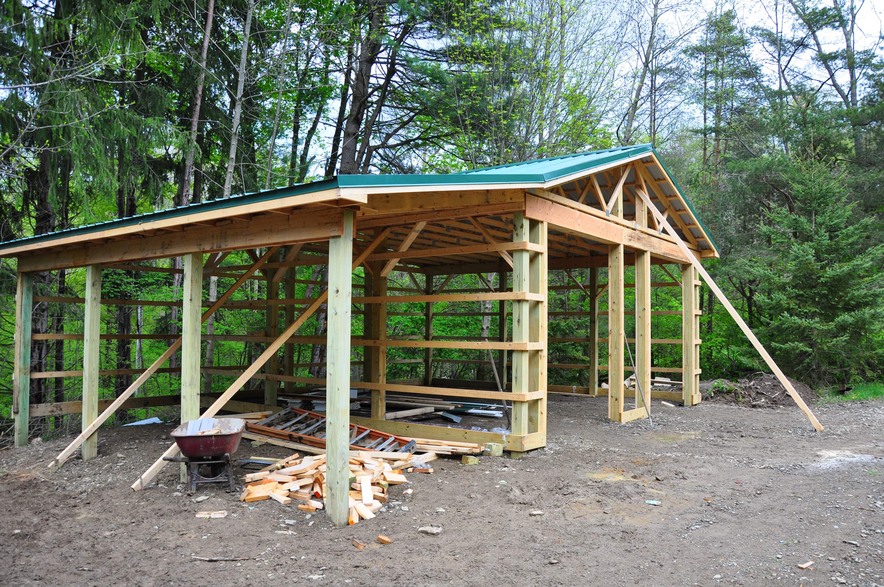

Yes the space to the left will be only closed at the back. I will store my firewood and trailer there.
