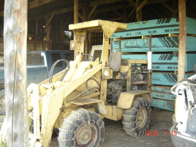

I got this old Waldon 500 allready for 15 yrs(looks similar to yours)
build like a tank,strong as an ox.
Like you said they are easy on a lawn and more agile than a skidsteer.
I got right now a 6.2 GM diesel in it(soon to be replaced with a 3054 cat).

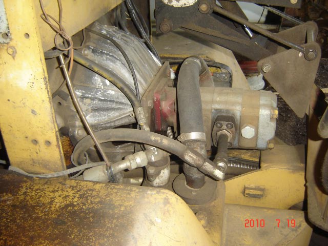

you can like i did change the hydr pumps with a commercial stackable one if you want to up the flow(mine are a 50 and 35 gal/min)(see pic)
A good solid loader as long as you're not in a hurry on rough terrain(bumpy like h3ll).;)
