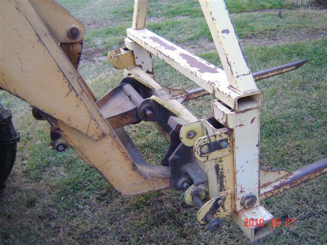

I believe he was referring to something like this:
Universal skid steer adapter Adjustable rollback on eBay!
Something like that anyway.
Personally i think the skidsteer quik couplers suck big time,not enough hook in the top and a lousy latch.
IMO this one i build from scratch is superior to that.I build it originally for my tractor but made it to fit the waldon as well.
the coupler fits this fork, a snow blade( i build both from scratch) and a bucket.
You be the judge ;)

Well I must say it looks pretty skookum. Problem is, it only fits your stuff - kinda proprietary in my book, while the Universal Adapter adapts almost anything to anything. Personally I find the skid steer attachment system very robust and I've never had a problem with mine or any I've rented.:thumbsup:
   / Waldon 5000 loaders #13
I have an ASV tracksteer with a mulcher and a brush cutter ,both have a original skid steer attachment,both are a PITA to hook up and its almost impossible if not on perfect level ground and both have been rewelded and re-enforced a zillion times.It might work for people that never used anything better just fine,but that crap is coming off mine an replaced with my design this winter.
That way i can use all my other attachments as well and swap between the tractor and compact loaders.
I'm the only one using it anyway.;)
