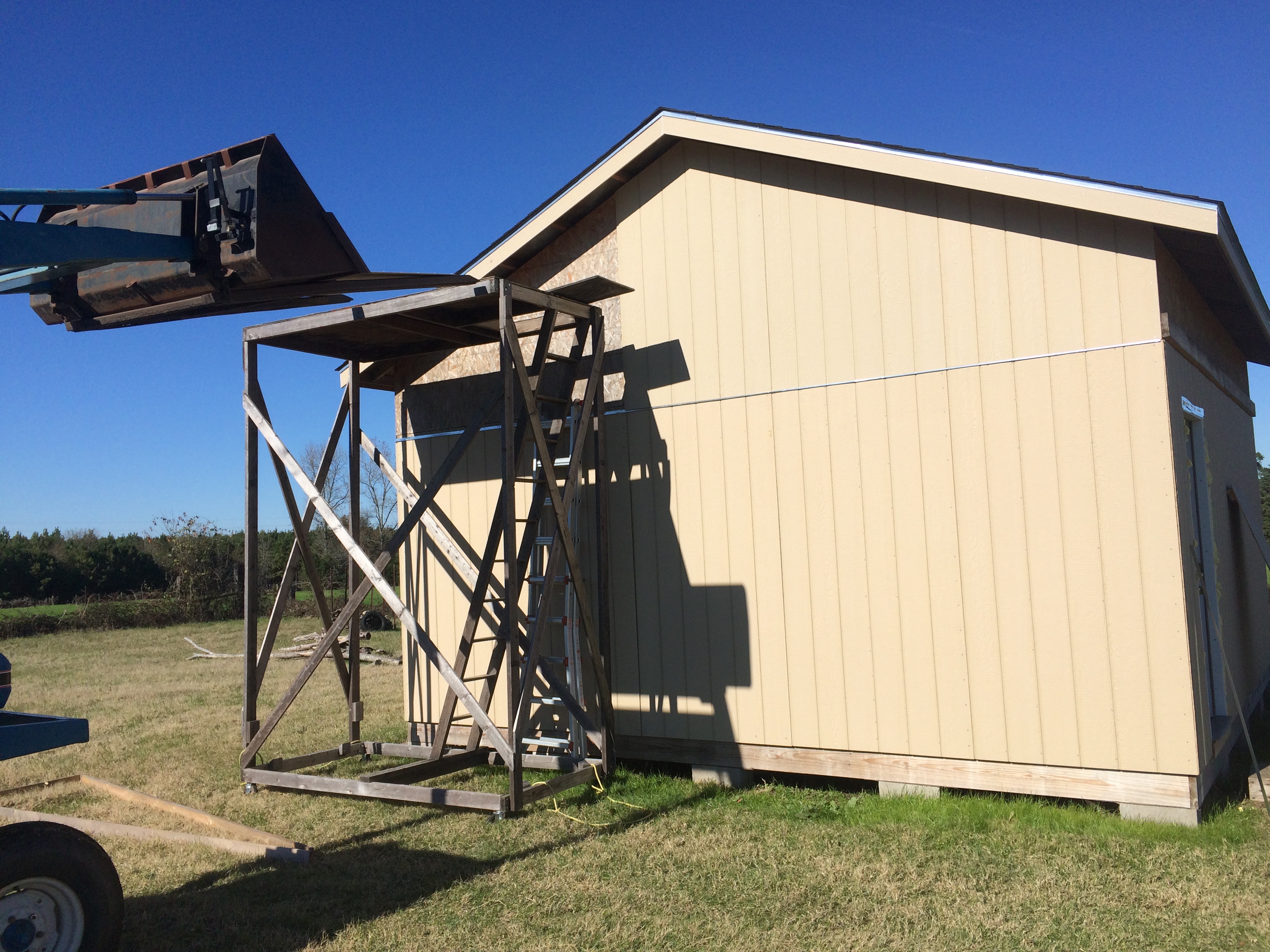

I built this shed 20x20x10 by myself. With the help of my tractor and my roll about scaffold. When working topside I would clamp the scaffold to the building and always felt safe. Yet for some reason I alway felt unsafe standing on this building. It is a 5/12. My main workshop is 4/12 and I've never has a problem standing on that one.
I have a metal hangar at the airport. When I work on that one I don't trust the metal panels. They need replacing. For that roof I work off a plywood sheet that I tie to the hangar. On the plywood I can distribute the weight. I never stand straight up on that roof. Maybe with roof replacement it will be different. Age is a factor also.
