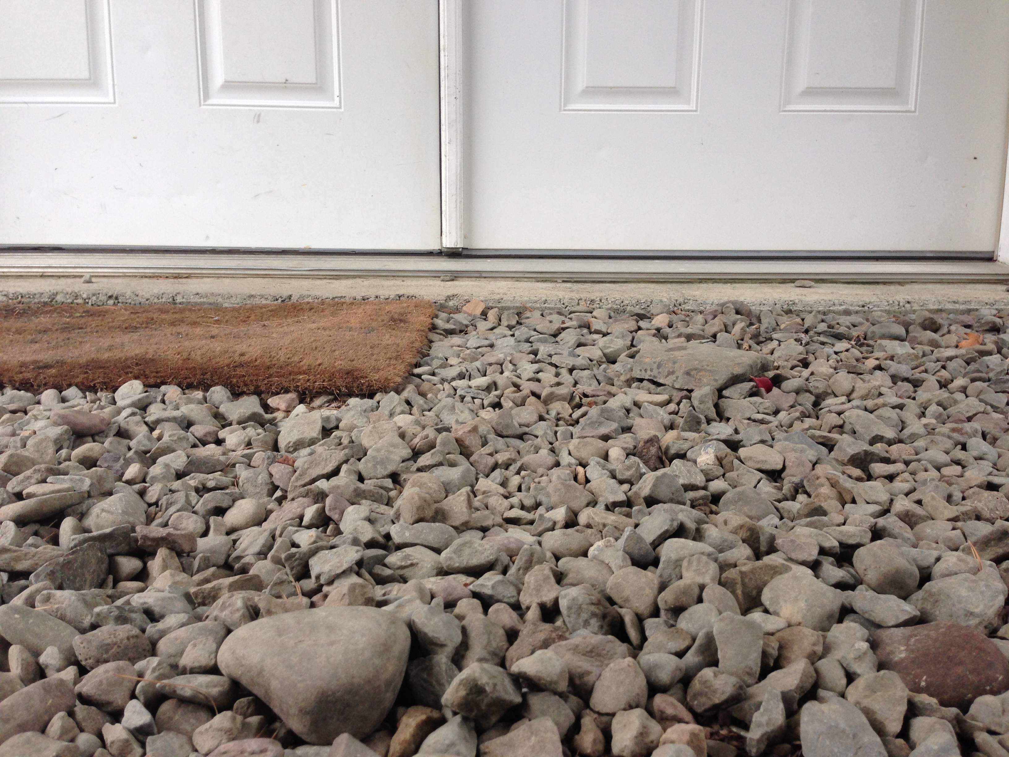

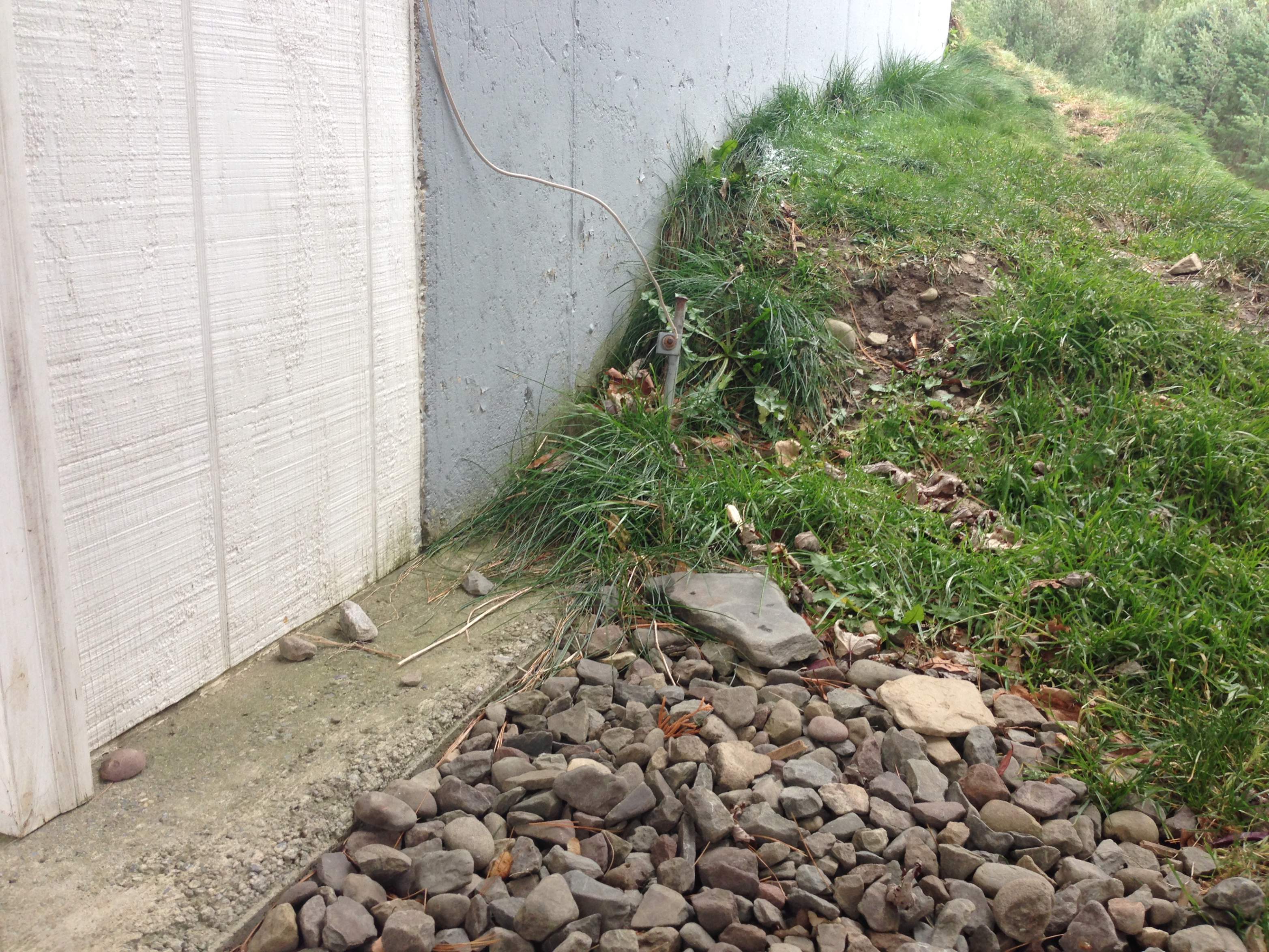

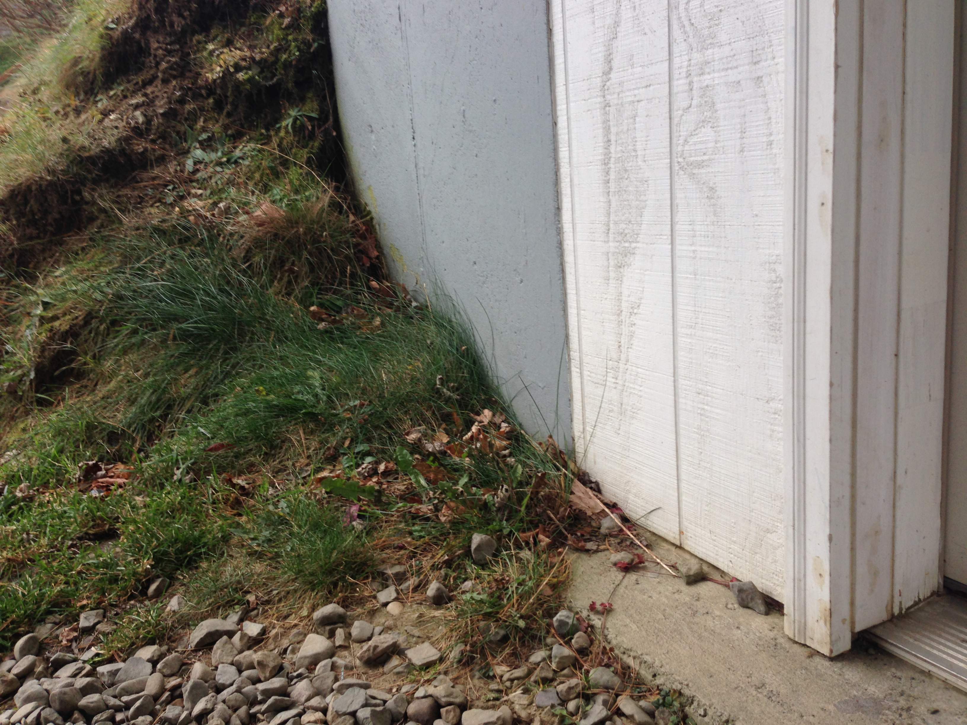

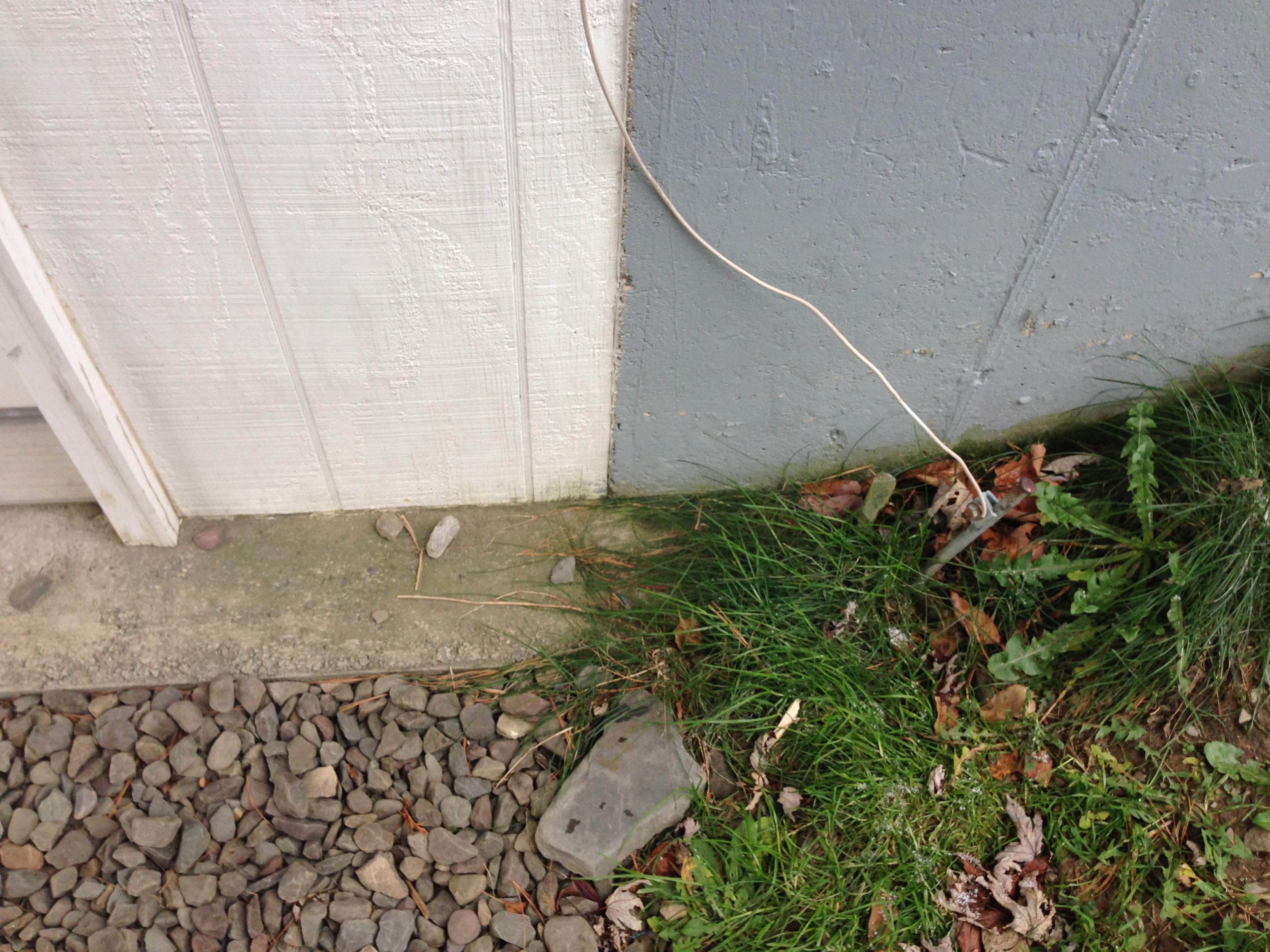

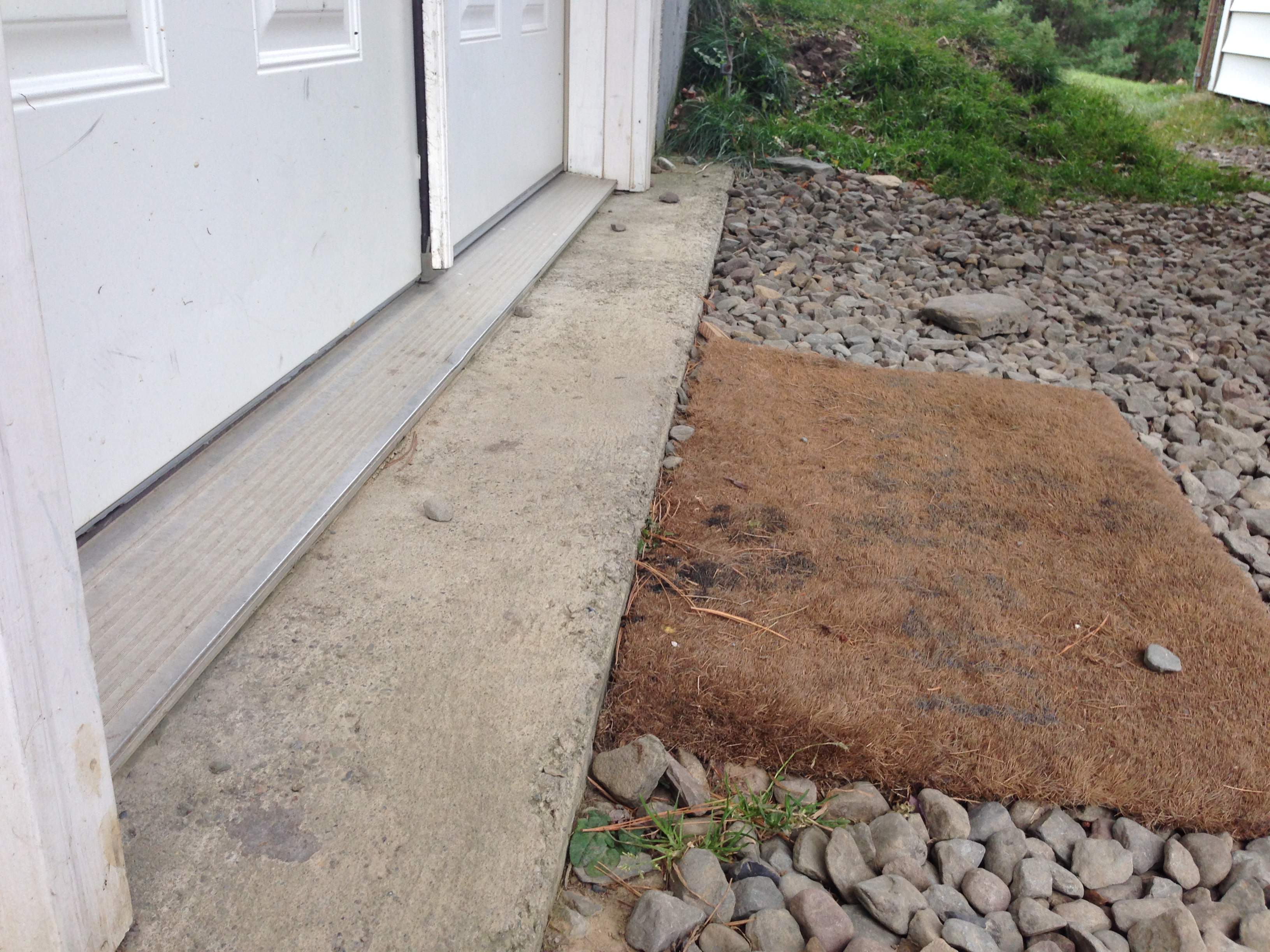

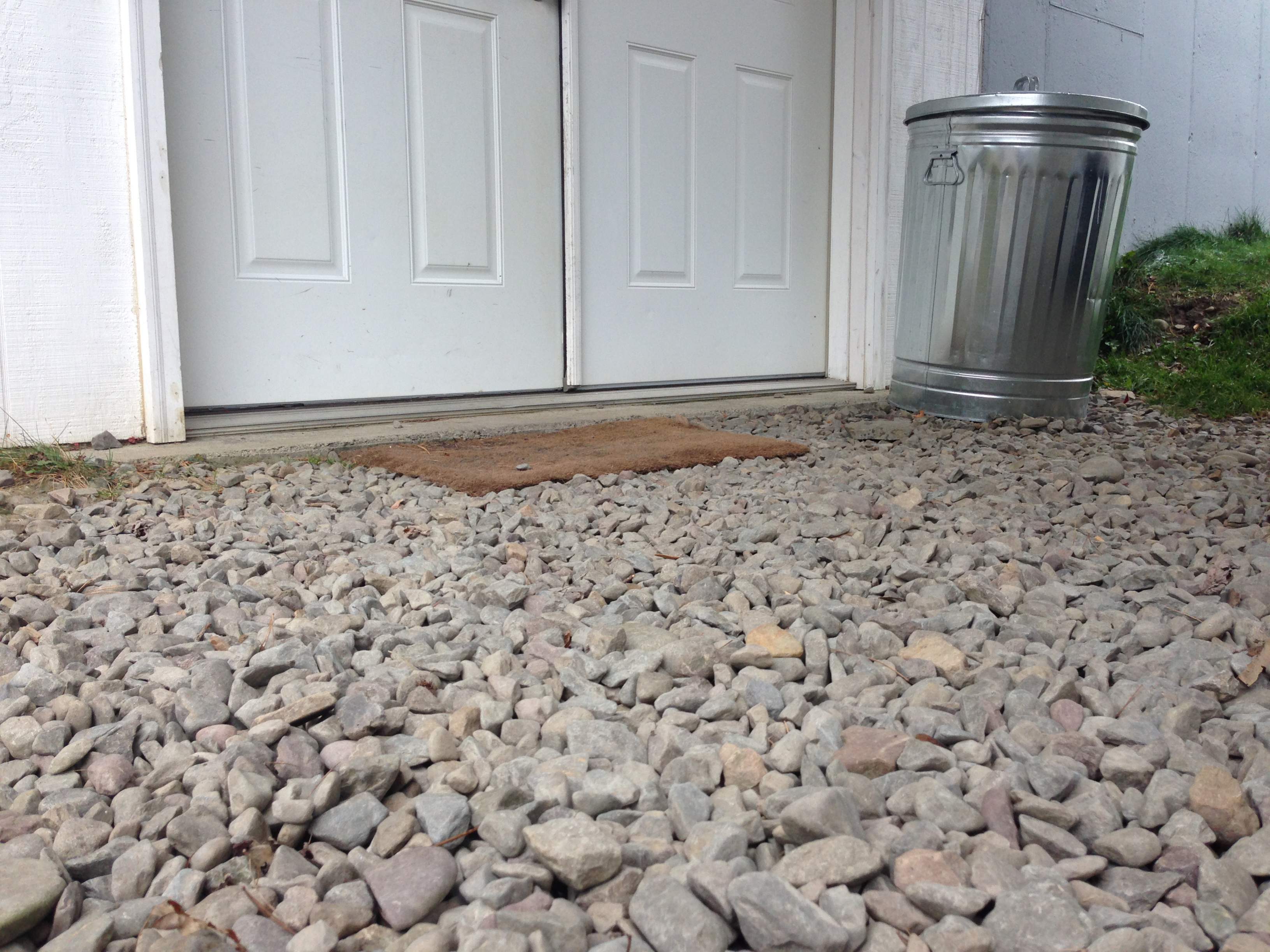

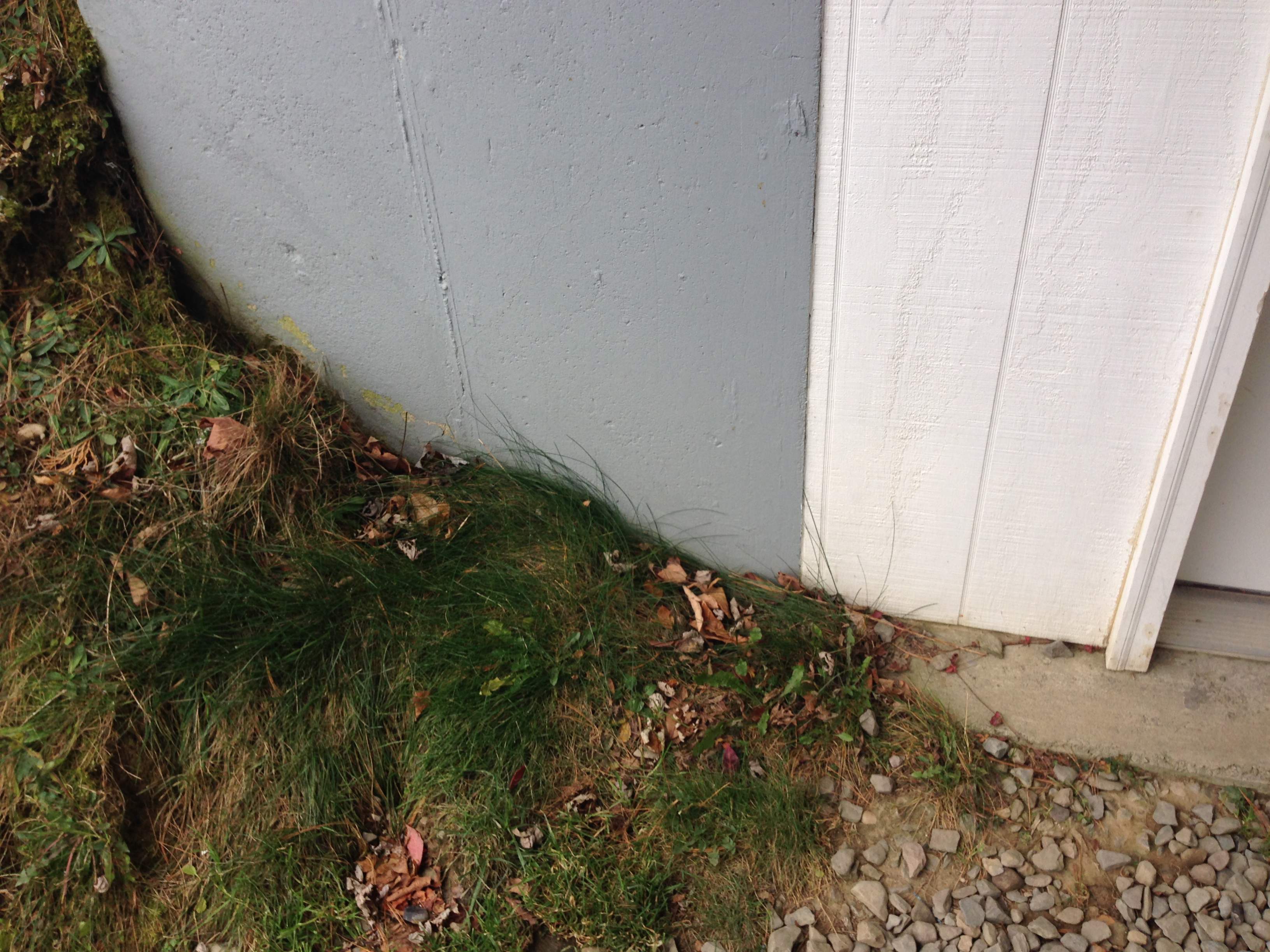

Here are some better pictures. I do not think that any of the water is coming from accumulation in the gravel in front of the door. This seems to drain extremely quick and I never see any sort of pooling here. Also, the concrete level is slightly above the level of the gravel as hopefully these pictures show. I do think that the banks on the sides of the door are directing runoff directly to the concrete pad that the door sits on, which is not sloped back towards the gravel, causing water to sit at the bottom plate and wick under.
   / Walkout Basement Entrance Re-Do #16
That looks likely to me from these pics.
You could give yourself a little more room by laying block on each side of the door rough opening if you re-do that wall section. But, it seems like keeping the surface water from ever getting to that area is a good idea.

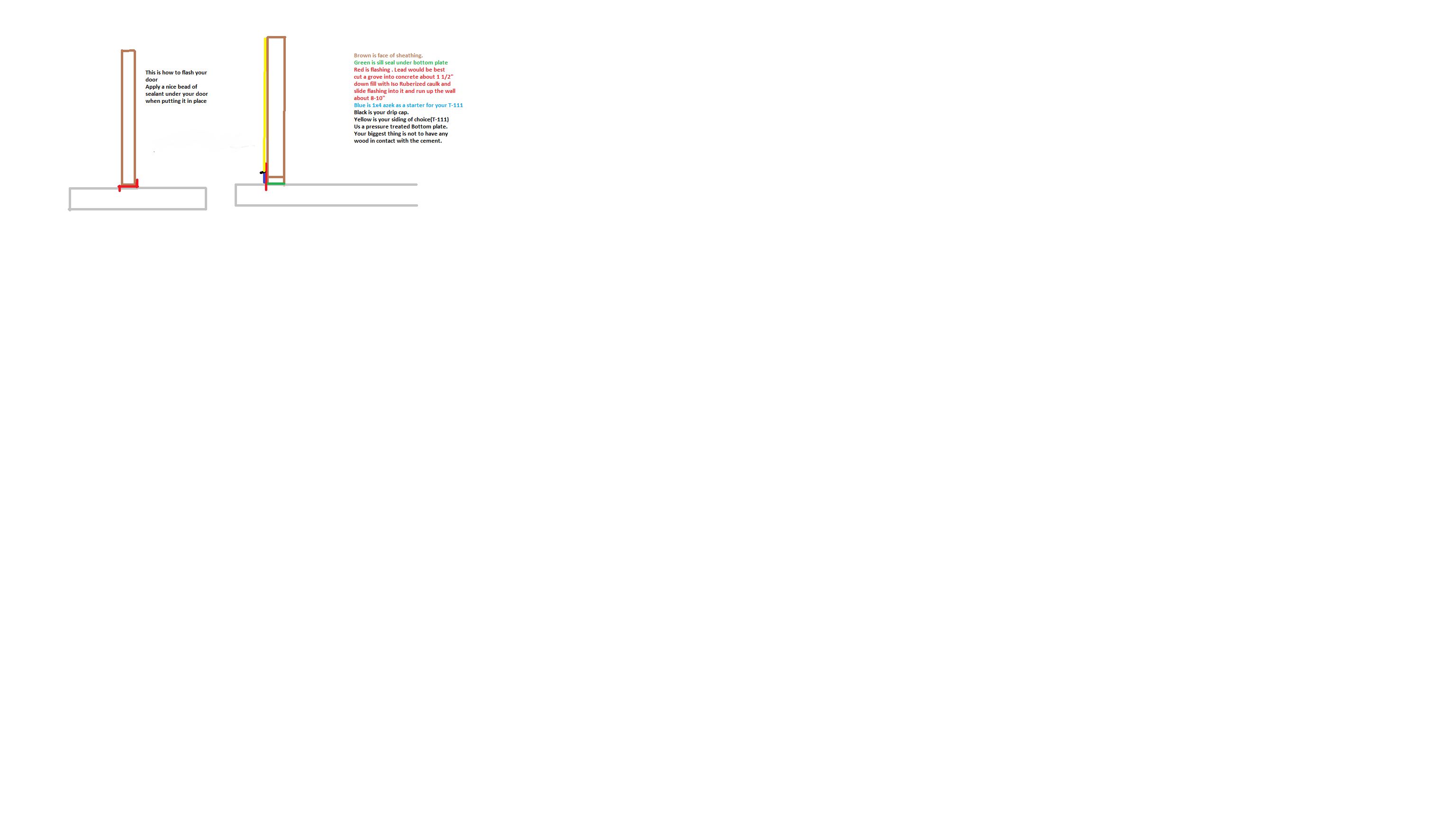

   / Walkout Basement Entrance Re-Do #17

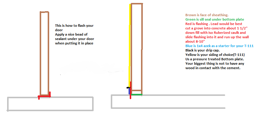

flashing.pngOk here is what i would do in your place. Sorry about the picture quality but i think you'll get my point. Can't figure out how to make the picture bigger :confused3: Can you guys see it?

The grade of the grass banks on either side of the doors needs to change, and the grade needs to be pulled back from along the walls too. There should be a stone lined ditch about 1.5' or more running alongside the walls sloped away from the wall allowing water to get away from the wall and away from heading to the doors area. The siding should not come to grade as it does now. The lowest portion of the siding could be trimmed with a piece of Kleer or other solid PVC material, impervious to water. T111 is not impervious to water or mold or outdoor elements. Same with the door trim, (called brickmoulding)- use PVC or nothing.
I would excavate out the grade from the side walls, seal it, after thoroughly cleaning the concrete with a Muriatic acid solution, then coat it with a bituthane sealer and use landscape fabric to line what will be your perimeter ditch, then stone to keep the water from contacting the house walls.
Water must be directed away from the entire area; both walls and doors must be isolated from water runoff and constant moisture.
Slope the remaining grade to have enough pitch to carry any remaining water away from the target area.
It seems you have a overhang of some sort above the doors? I can't tell from the pics too well, but if it's there it too must allow the water to be taken away from the doors with gutters, flashing, whatever it takes to keep the area underneath dry.
