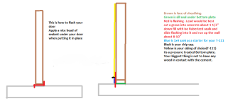

View attachment 346627Ok here is what i would do in your place. Sorry about the picture quality but i think you'll get my point. Can't figure out how to make the picture bigger :confused3: Can you guys see it?
Builder, I can see it, although when I first looked at it all I saw was an empty white box! :D
A couple questions:
In order to keep the PT sill off the concrete, is the sill seal all I need? Or should I wrap the bottom and sides of the PT sill with vycor, leaving the top open so the sill can breath?
When attaching the PT framing to the concrete walls, should I use the same method? Sill seal between wood and concrete, with the framing wrapped in vycor? Should I flash this in the same way, with the slot cut to accept the lead flashing?
I have vycor left over from the deck project, and it is cheap enough that I don't mind adding it where it can be of help.
Thanks!
Joe

   / Walkout Basement Entrance Re-Do #28
A couple questions:
That should be fine.
Joe
I would not do this. You are creating a bath tub to hold water around the wood.
   / Walkout Basement Entrance Re-Do #29
A couple questions:
Thanks!
Joe[/QUOTE]
1)If you have the Vycor just use that and don't worry about the sill seal. Lay the vycor down even with the inside edge of your sill plate, frame your wall do the sheathing and fold the vycor up onto your sheathing basicly creating an L-shape with the vycor. You can do the same with your stud running up along the foundation wall.
2) You don't need to to flash your sides the same as you do the bottom as water will not sit there. You might want to run a piece of Azek 1x4 or whatever size you like along the edge of your foundation wall so your siding(T-111) will not come into contact with that as well. Then apply a nice bead of sealant inbetween your Azek and foundation wall.
Your door you can get with composite jambs along with the exterior casing.
Want to know anything else just ask i'll help if i can.
