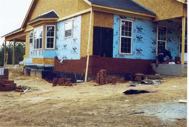

That green sealer is some pretty neat stuff. Goes on thick, then they attach a flat drain tile to the bottom that is designed to channel water away from the foundation. The green rubber wall was covered with a super thick black plastic sheeting that no four of us here could tear by hand. If you look close in this photo I think you can see it.
Anyway, the manufacturer provides a lifetime warranty against leaks.
Yes, that's a brick ledge you see.
