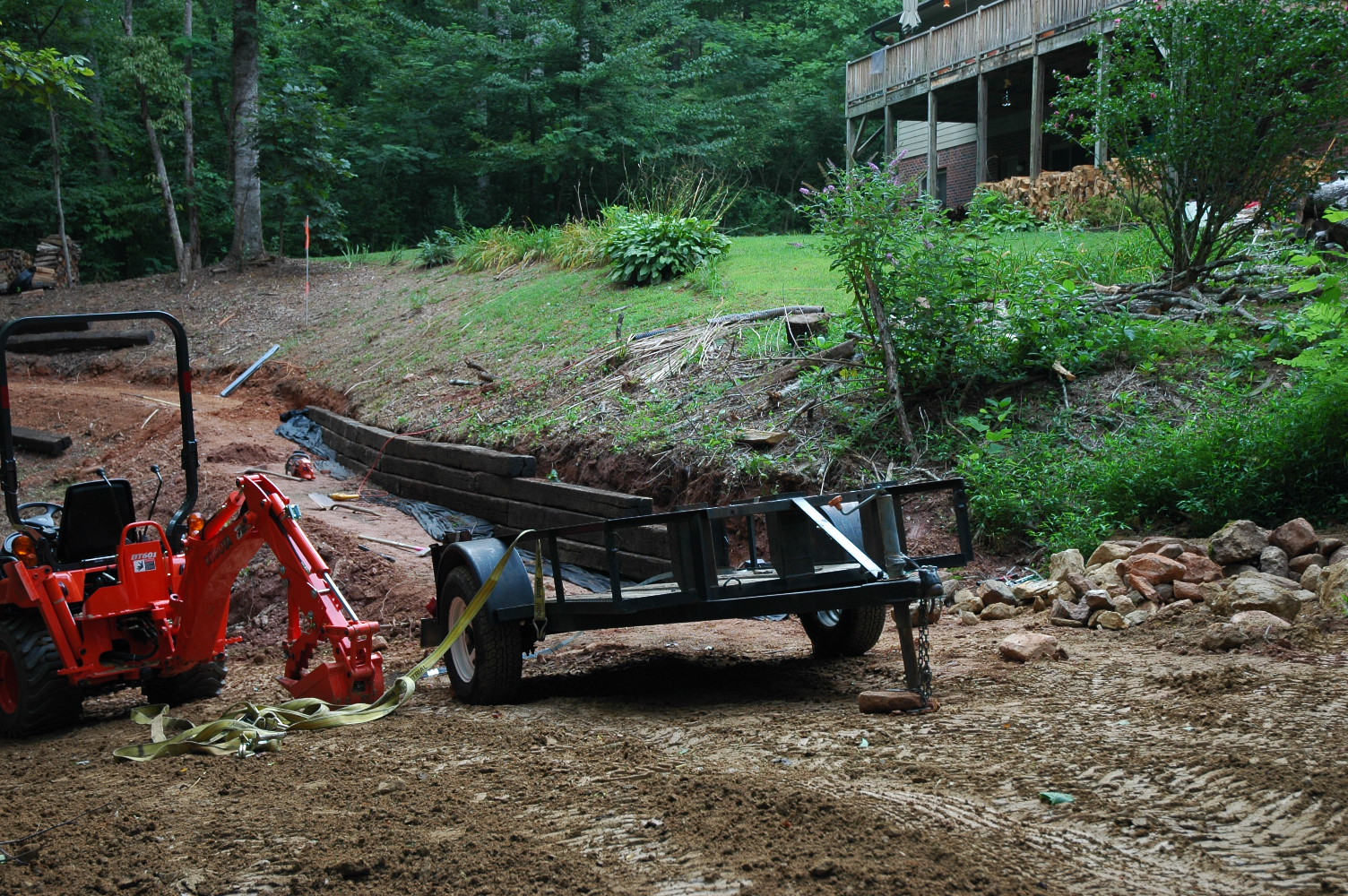

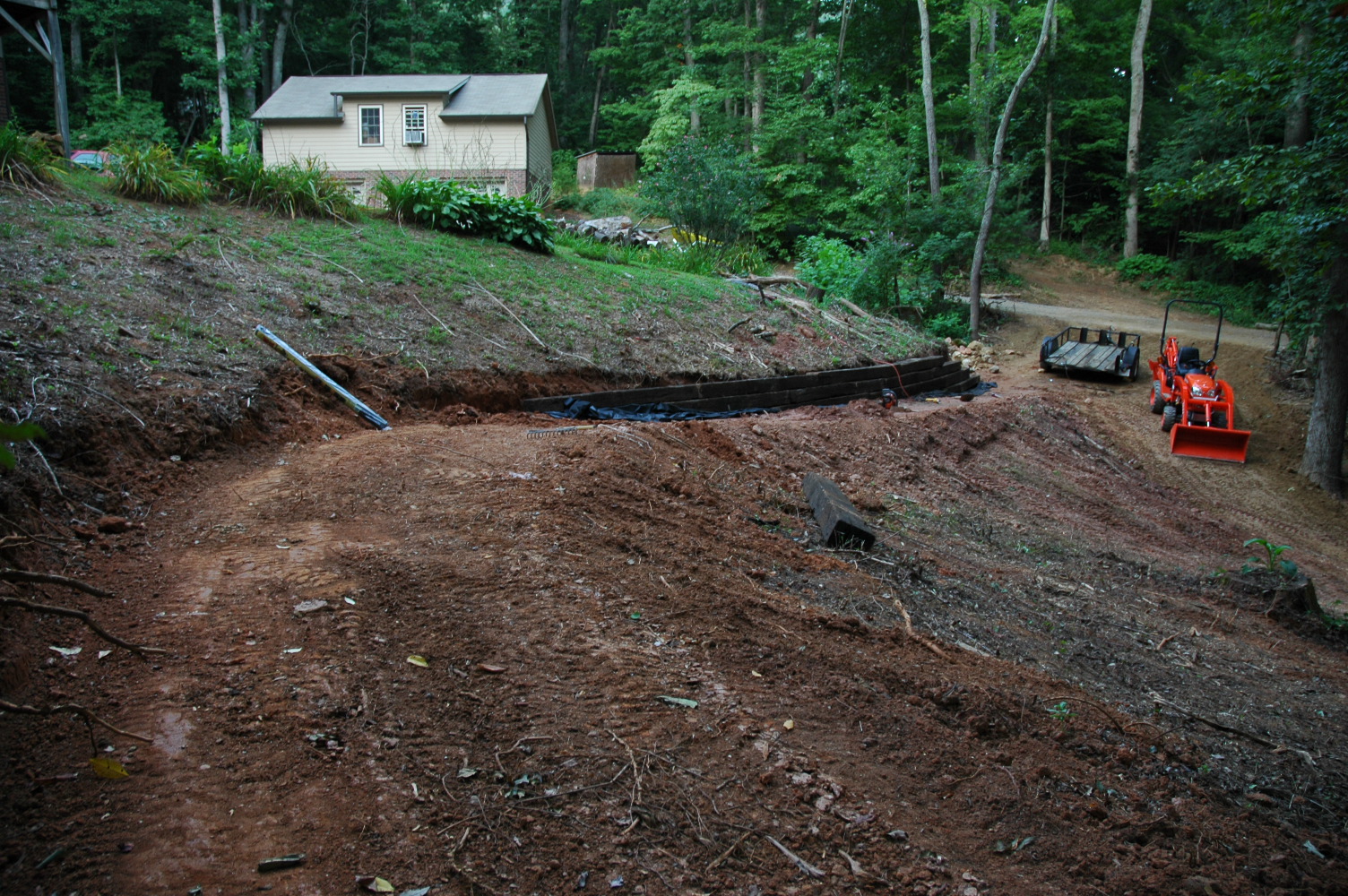

I've cut a terrace/path across my front bank, and I'm trying to decide what to use as a base for the path. I'd love to use brick pavers, but this would blow my budget, and really wouldn't "fit" since I'm trying to keep a rustic look.
I'll be using rocks that I've collected from my property to stablize the bank on the upper side, so I'm considering some sort of gravel base for the path, but I am open to alternatives. It'd be interesting to hear any suggestions.
Hopefully there are pics listed below.

From the pictures you appear to have a lot of elevation. Unless you plan on putting in some sort of drainage system you will have a lot of erosion. Perhaps some sort of wood walkway, even rustic uncut logs or trees.
My dad used to build roads on lots of hills and he always sloped the road slightly to the downhill side to ecourage the water to sheet off instead of becoming a small river and really eroding the road base.
Good luck. I love projects like this. Please keep us posted with pictures. :)

Rick, I don't get very much erosion on this bank, least not in 6 years. I do plan to put various plants above and below the path, and I have sloped the path back towards the upper side, and it also has a slight crown to it along the length of the path. The pics make it look steeper than it actually is, and the path has been groomed quite a bit since those pics were taken.
We've had a few downpours since those pics, and the only place that I've seen any erosion is where my downspout drain lines empty on the upper bank, those lines will bo routed to an 18" culvert down below.

Well...the heatwave as made progess sloooow! Can't even let the tractor do most of the work without bathing in sweat! I decided to use railroad ties for the retaining wall instead of rock, since I couldn't locate enough "free" rock. I laid the first course by hand, then I was able to use the BH and thumb to set the second and third courses fairly close (I'm getting better at this BH stuph!).
Still a ways to go...but I'm getting there!

/ Walkway/path suggestions? #12
I went to a class on trail building in the State Park. Most of it was PC BS, but they did have a few good ideas.
One was to use rebar to anchor your edges in place. They drilled a half inch hole through the log and pounded a half inch length of rebar through it, and into the ground. Three or four of these, depending on how long the log was, would anchor it in place very nicely.
They also talked about ways to finish the trail.
Blacktop is the prefered material, but it's expensive and dificult to install further out in the woods.
Mostly they use mulch. It's easy, cheap and very effective.
Eddie
#13
Thanks Eddie...I used 5/8" rebar 2' long to anchor the base ties, then 12' long pieces to anchor the next row to the previous row. This has worked well where I've used the RR ties elsewhere. I found a couple of truckloads of free mulch about a half mile from my place...so I suppose that's what I'll be using for the path.
Thanks for the help!
/ Walkway/path suggestions? #14
Seeing as you have a hoe I'd suggest some deadmen for lateral support. :)
