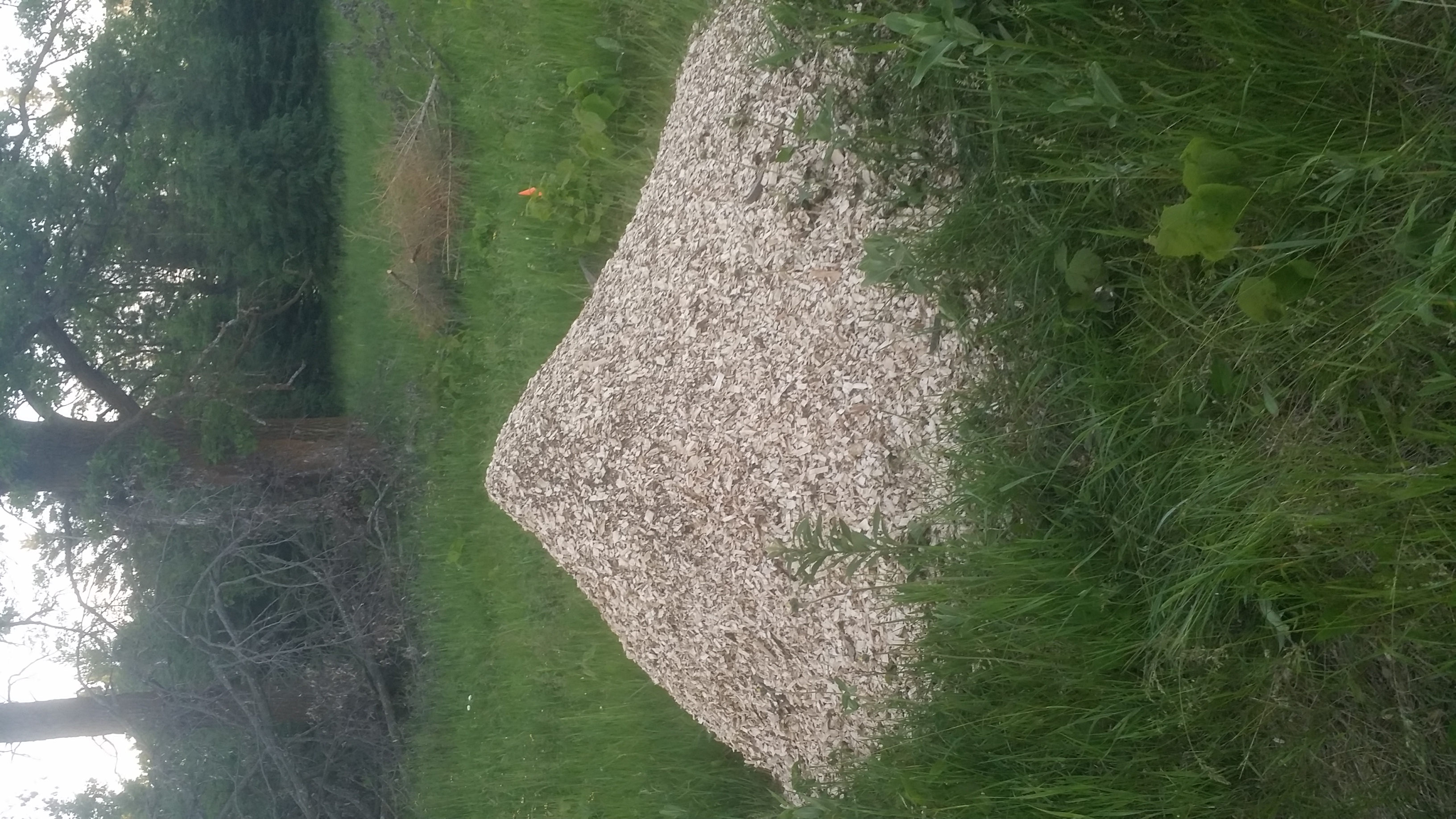

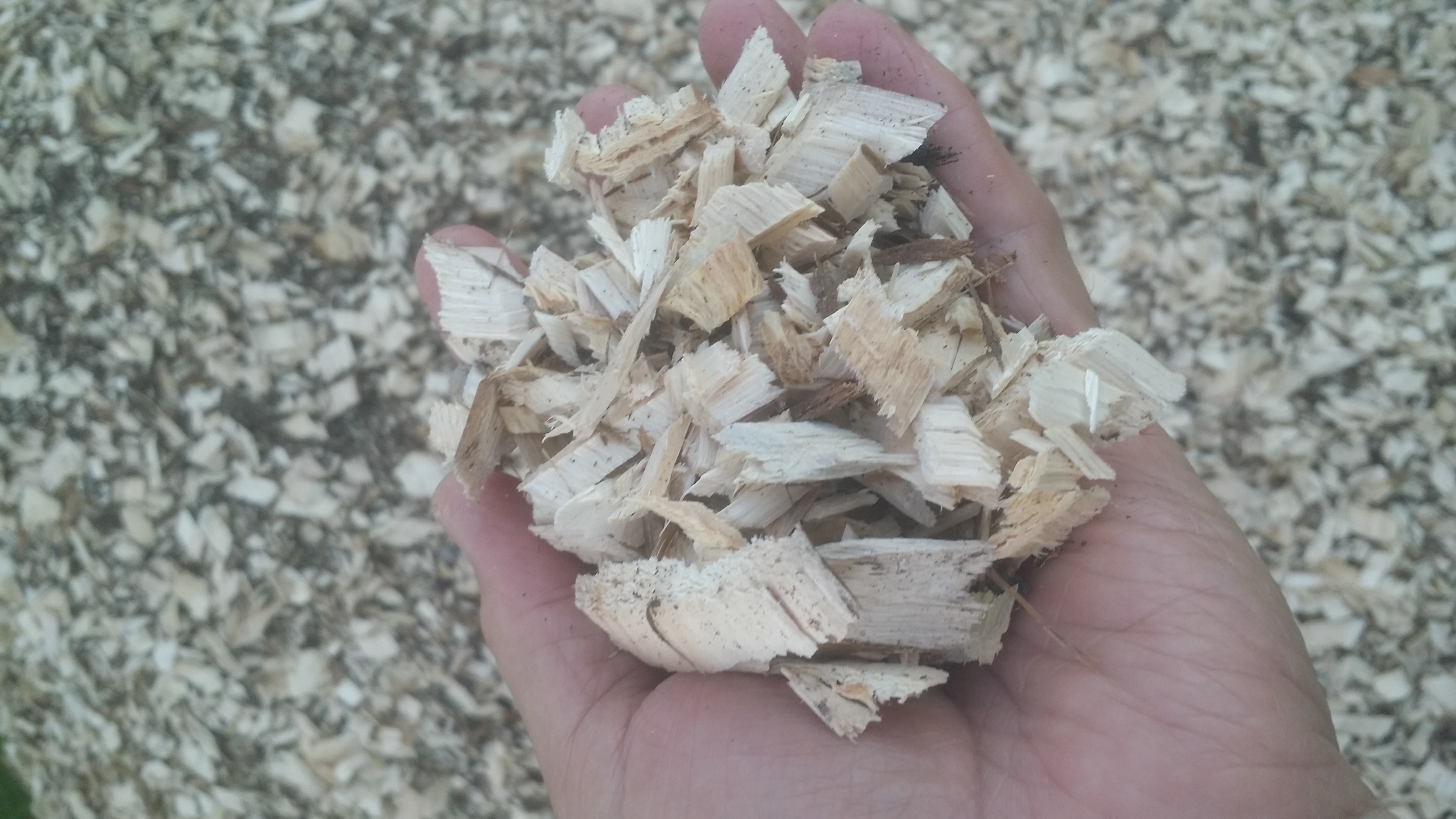

I picked up a BXM32 earlier this year and have put about 10 hours on it so far, primarily chipping poplar along with a bit of oak, basswood, and brush. I've attached a couple of photos from a run of poplar and oak. I run the BXM32 on my MF 1529, 28HP engine, 23HP @ PTO. The worst I've been able to do to it thus far is to temporarily slow the tractor RPM by 200. It eats green and dry 3"~4" poplar without hesitation. Oak results in smaller chips than that from poplar but the chipper handles it well too. I feed the shredder hopper small branches, about the diameter of one's finger, and it processes them well. The output is very shredded.
