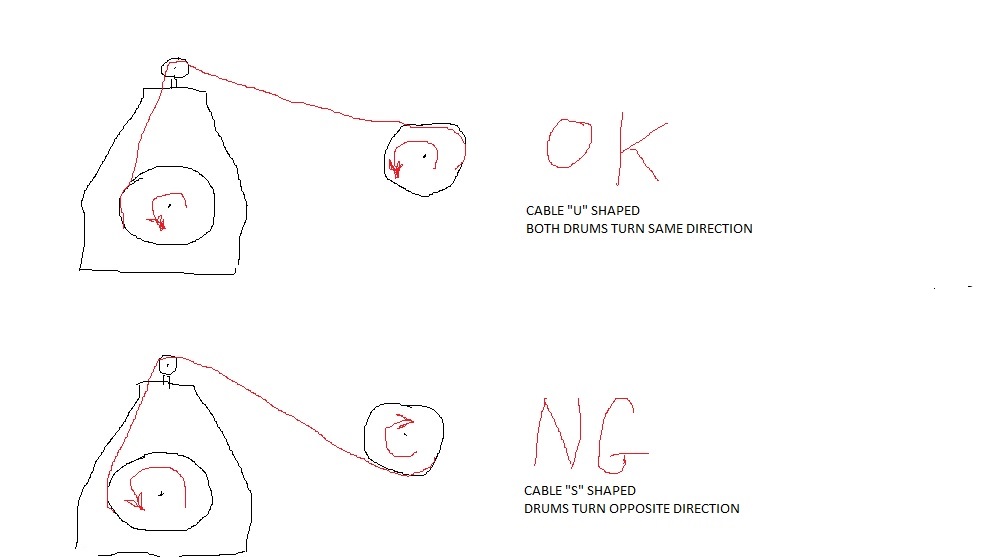

Your going to want to wind that new cable on under tension before you try pulling any wood. If you have some loose layers on the drum when you start a hard pull on a log it will pull the cable down into the the layers on the drum then tighten on itself. Could ruin your new cable. When that happens you can't pull the cable out by hand. You have to hook onto a stump or tree and drive away to get it unbound. You can put it on loose the first time but before you pull with it reel it all the way out and pull it back in under tension.
Also when you wind the cable on either have it layed out on the ground so it is free to untwist or put it on drum to drum like this. Putting it on wrong drum to drum will twist and kink it.

After you get your new cable, "wire rope" layed correctly on your drum, dump some diesel and used motor oil on it. If you keep your cable lubed, it will work better and save better. Dry cable takes a beating. If you work slowly when drumming, you will keep your line wrapped right.

Again my thanks for the input from folks experienced with these winches. I had planned on working up from an idle when feeling out the use of this winch. I did a similar thing when learning the backhoe I bought this spring. Good advise on coating the wire, we called it “ slushing” the wire when I was at sea, I have a couple of jugs of waste oil in the flammable cabinet waiting to go to the recycle tank at the town barn, i’ll soak a rag in that and wipe the wire down when I lay it out before spooling it up. Any suggestions for spooling it up under load to get it wrapped tightly ? I read a suggestion in another thread to run the wire out and then leave the tractor in neutral and then winch the wire in using the tractor as the load. Seems like a reasonable plan, is there any better method?
