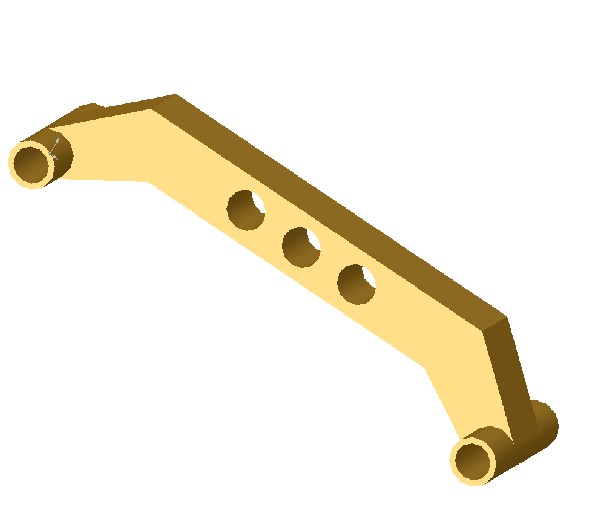

I was just out looking over the Wallenstein Thumb on my BH75 - it's certainly a very elegant design and compact. However, compactness is its major downfall as the designer didn't give much thought to the forces being applied to his design... In order to make it fold up so small, they needed to curve the black top-link (making it far weaker than it might otherwise be when compared to the Bro-Tek unit).
Therefore, if one wishes to maintain the compact design, then the sketch I provided should work reasonably well (it doesn't solve the design flaw, but it does add more steel where it's needed - see updated design). If, however, one wants all-out strength, then a straight top-link will provide much more strength (as stated by wkasak) - thus creating the hybrid to which Tom_H alludes. In this stronger hybrid, the weak part of the design will now be the serrated jaws themselves. Unfortunately, after closely examining the unit, the top link on this hybrid design would have to be physically removed if one wishes to fold the unit when not in use.
Honestly, I'm not sure what to expect when I put mine to the test, but building the new unit could be fun... :rolleyes:

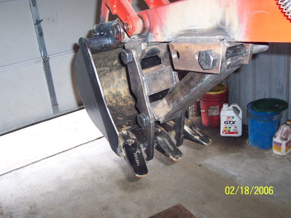

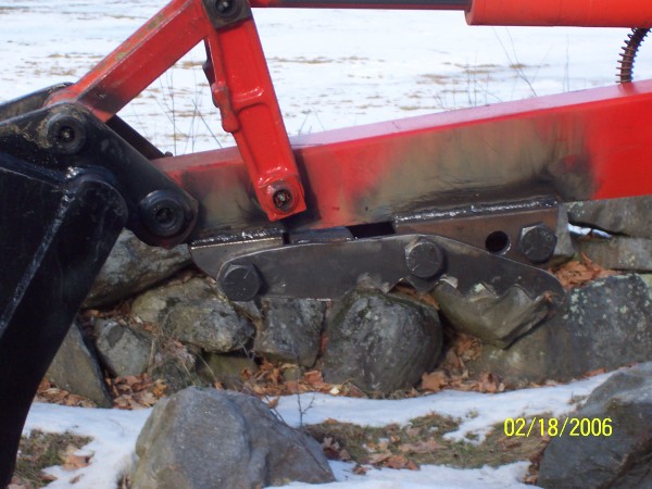

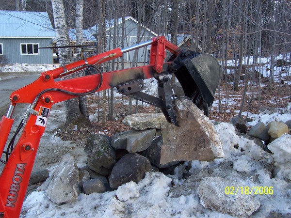

HI,
Just thought id show you a couple pics of mine.I know when i was building and designing i thrived for pics.As alot of you know from my stonewall building,this thumb has stood the test of time.Hope it helps.
ALAN

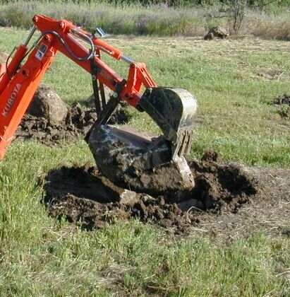

Ditto, 3 seasons now.
This rock, I couldn't lift w/ the FEL !
Mine also doesn't care if I jam it into the ground while digging :)
Amazing what some scrap form stakes and 4 bolts can withstand when the grometry's right :D
   / Wallenstein Thumb Review on BX #27
Impressive, any idea on the weight?
KC
   / Wallenstein Thumb Review on BX #28
kcook said:
Impressive, any idea on the weight? KC
Well, not really. That was the second one I lifted that pulled the front wheels clean off the ground ... this one was bigger and took a heaping FEL full of dirt to balance. I guess the specs list the FEL capacity as 460# so I guess it was something north of that.

Escavader,
That is one BEEFY thumb!!! Is that 1/2" plate steel? When folded up, does the top-link fold in as well, or do you remove and stow it elsewhere?
Nice piece - you could easily sell them on e-bay (especially if it could be modified to attach with bolts.
   / Wallenstein Thumb Review on BX #30
Wo, Dude,
Now that's a serious mod. Nothing's gonna torque that baby out of camber. I'm thinking that if I get a bh, I'm taking it to a welder and just have one of those fabricated. HomeBrew, yours is slick too.
