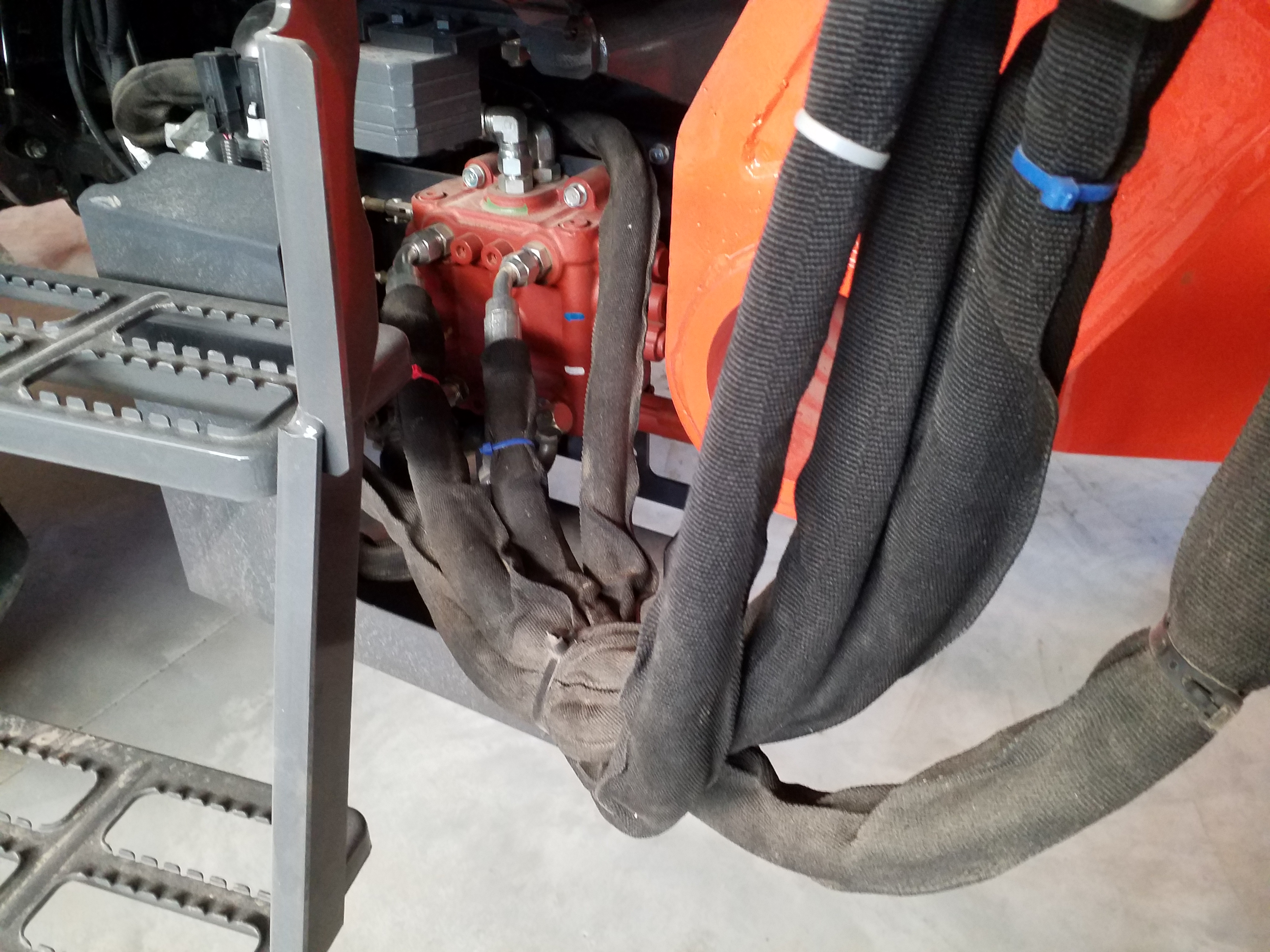

We plan to buy M5091 so I would like to ask you if there were any problems with your tractor? Is there anything I should pay special attention to? Can you please take a picture down below right door of your tractor, I'm interested on how a loader valve is connected to the tractor hydraulics. Thank you very much

I only have 12 hours on mine but no issues so far and I am really happy with mine. I'll get you a picture of what I think your asking for later today.
   / Want a bigger tractor. M5-091 too big? #46
Here is where the loader hoses connect. I have third function, so if thats what your looking for this is it.

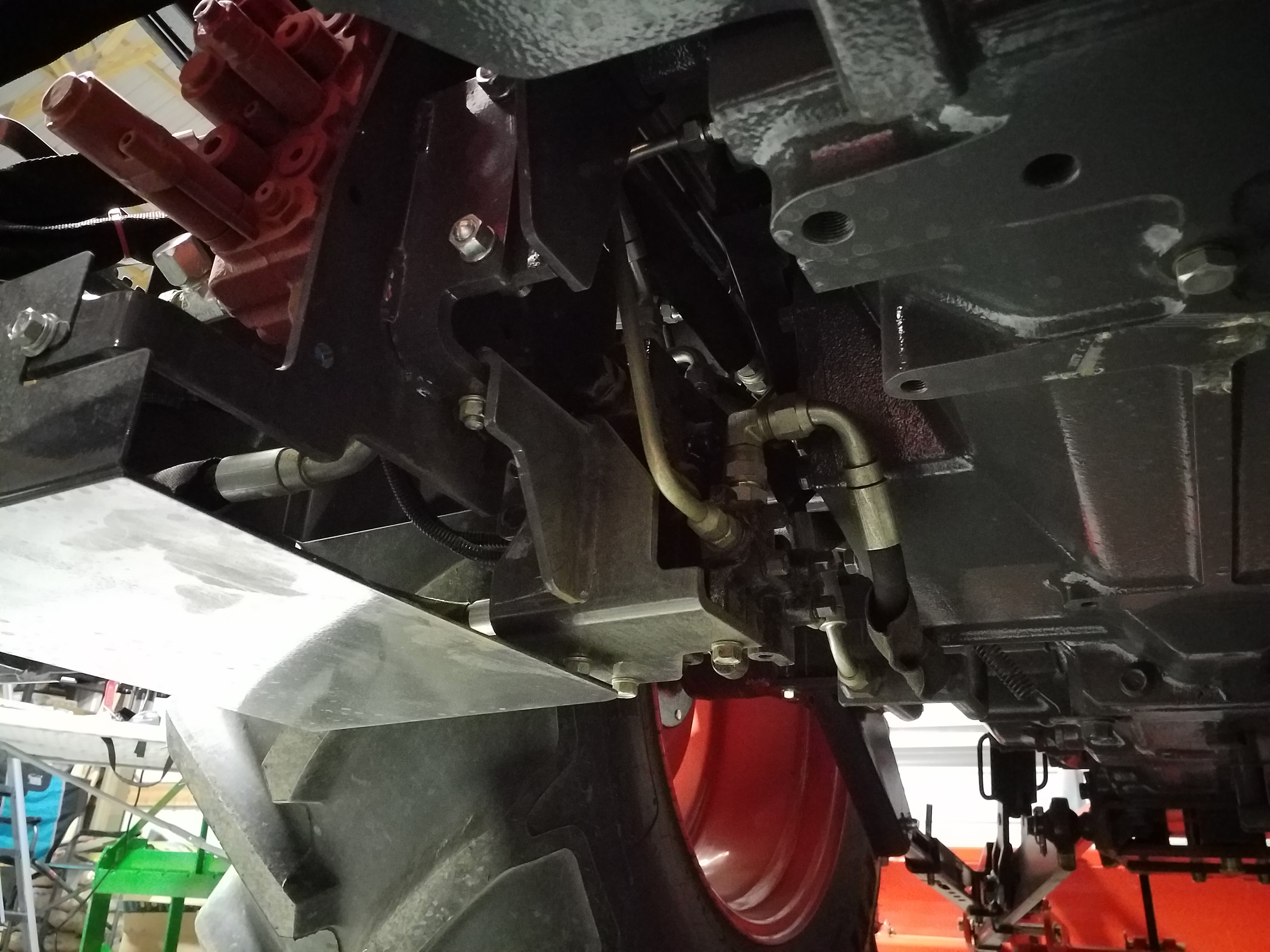

Thanks alot. Well I was actually wondering if this U shaped hose is the connection between tractor pump and loader valve..? Took this picture on a fair where they had M5 on display.

I dont have that u pipe connecting anything. Here is another shot showing the line path back to the pump.
