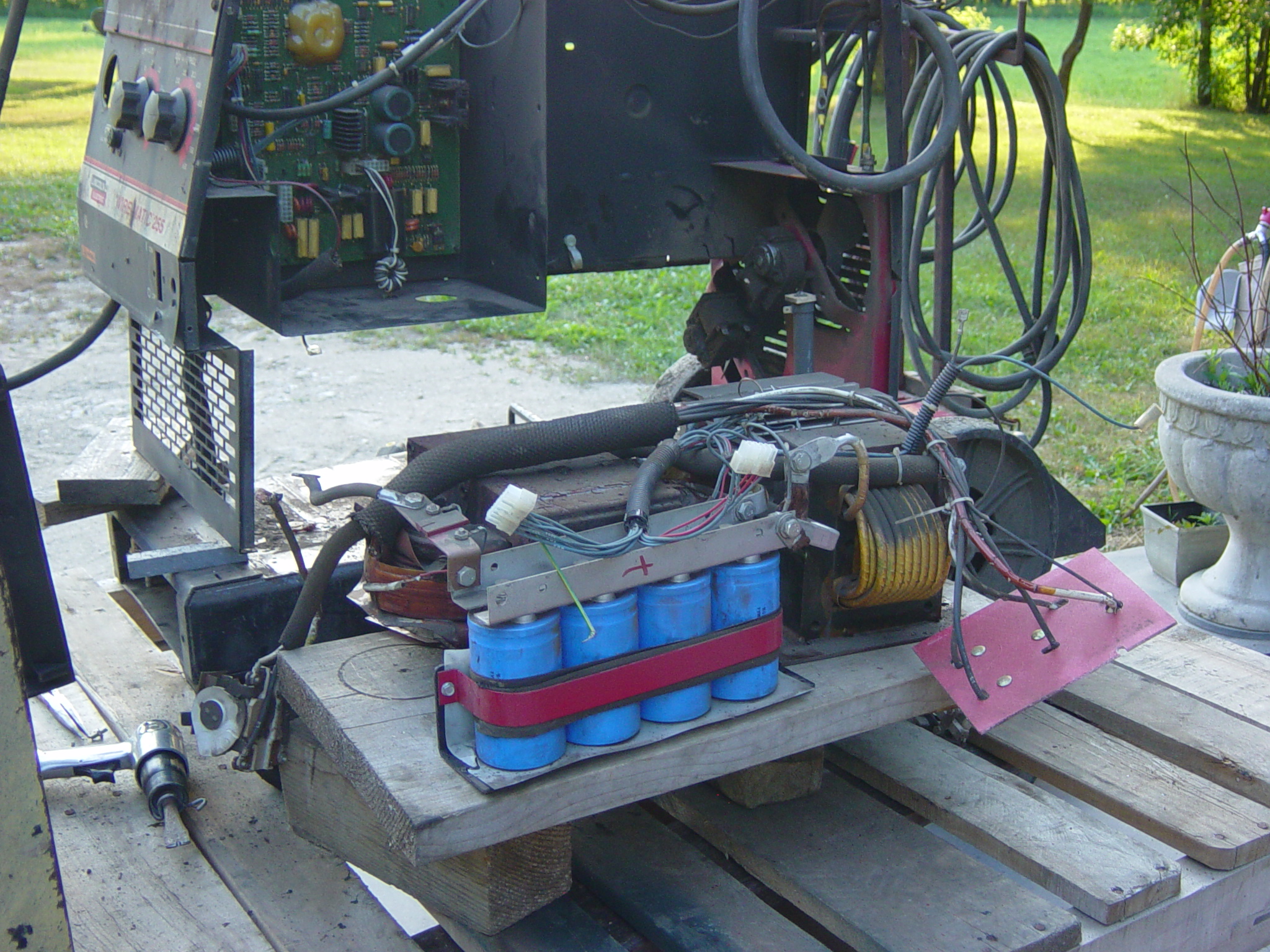

I have worked on an old Hobart MIG Welder Several Times for a friend. It has welded thousands of farm gates. It is an amazing machine, does everything that a 250 class Miller or Lincoln will do and not a transistor in the thing! Only problem ever was main contactor issues. You should be able to find one cheap, because it's out of date and not sexy, but if I ever come across one, I would grab it.
Another welder I fixed for the same friend. Look at all the electronics that are absolutely unnecessary!

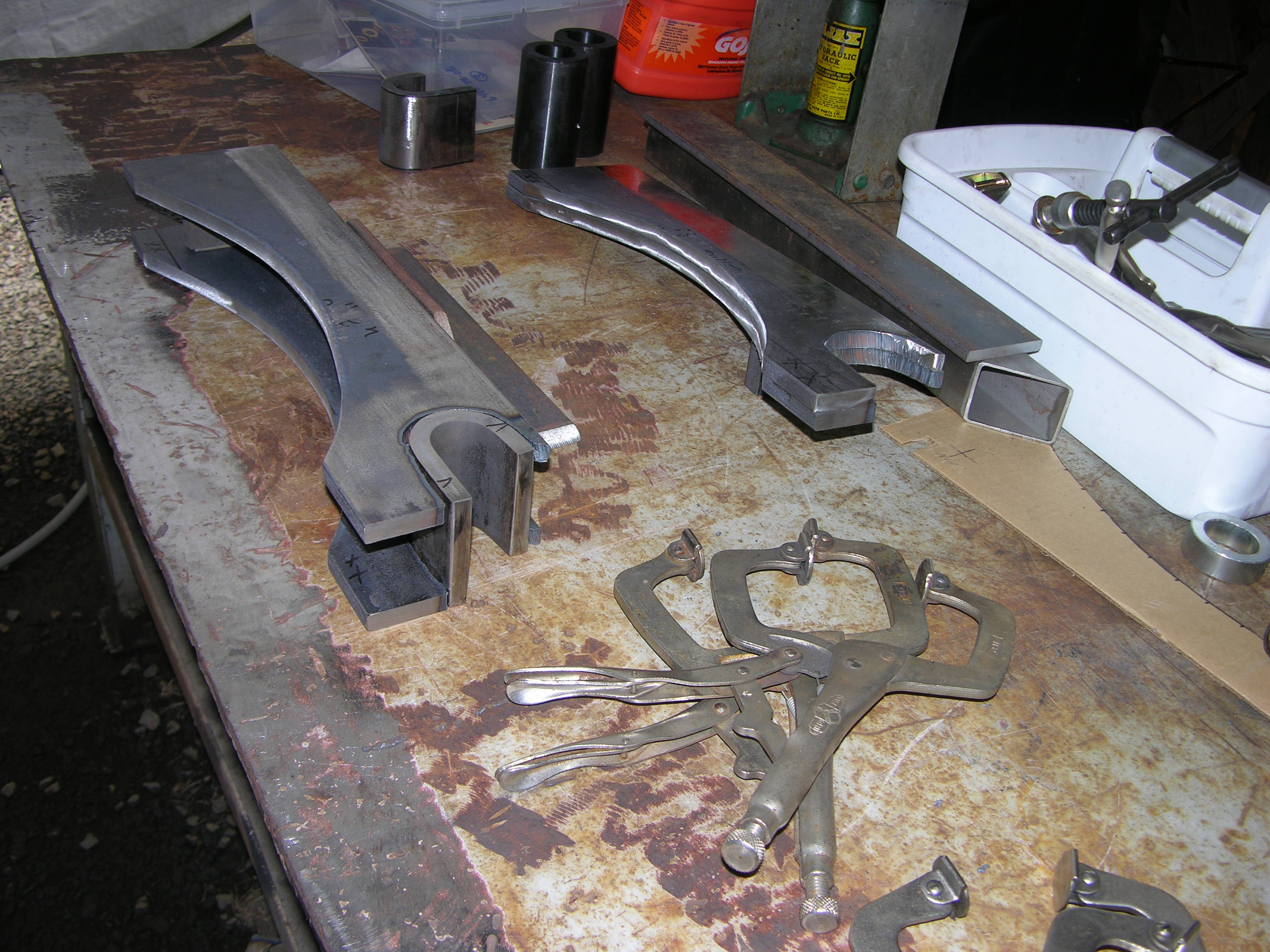

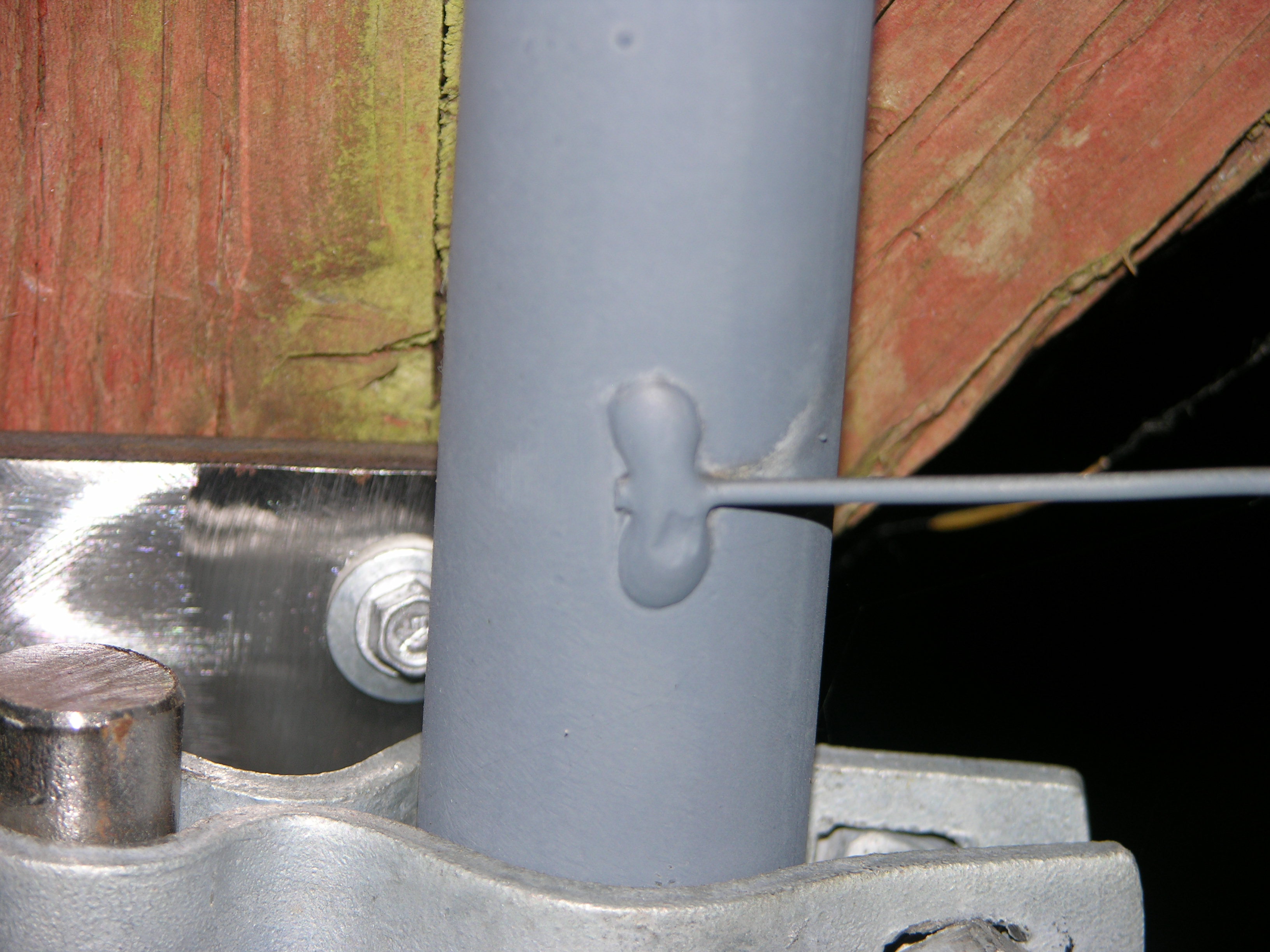

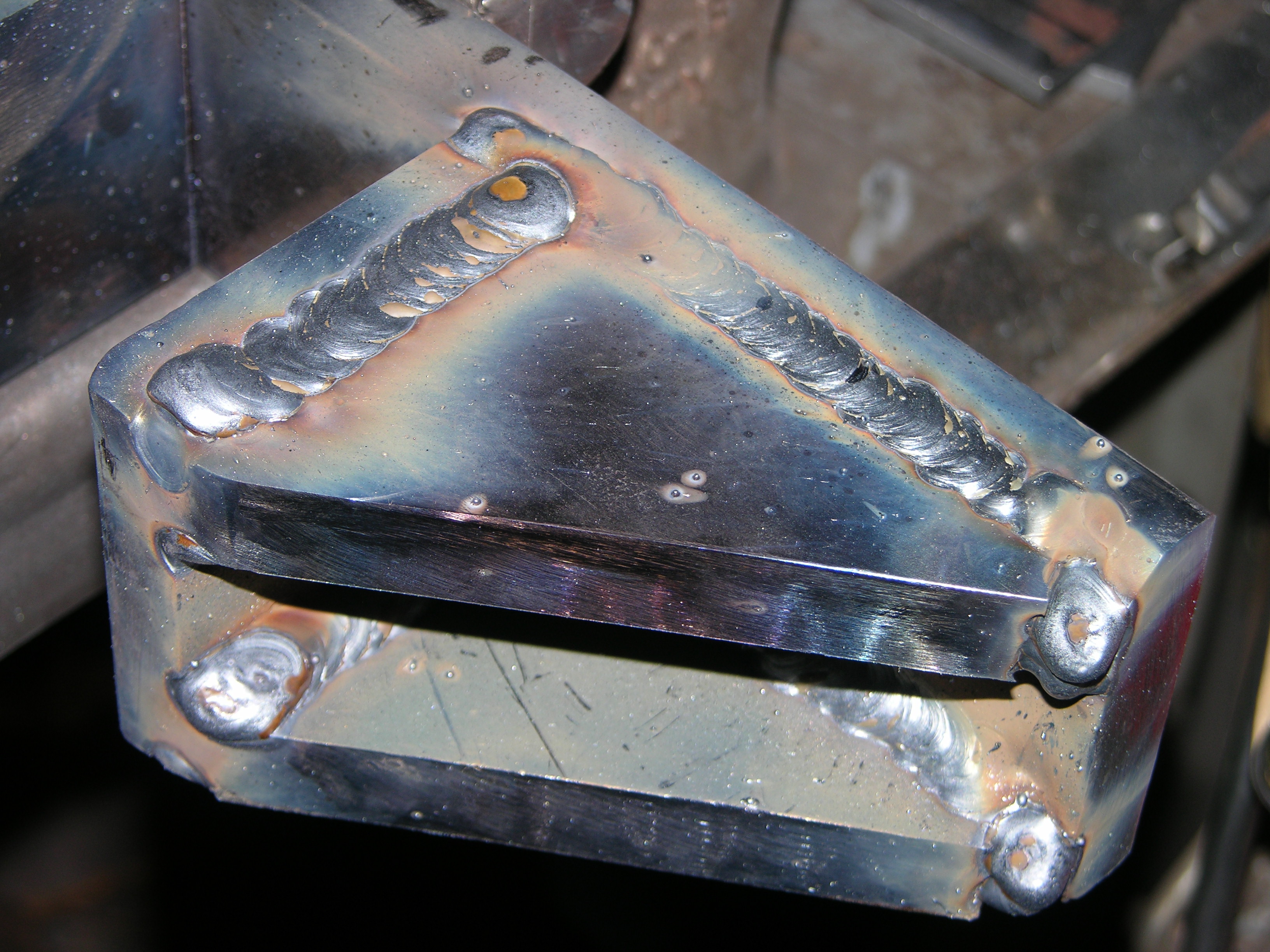

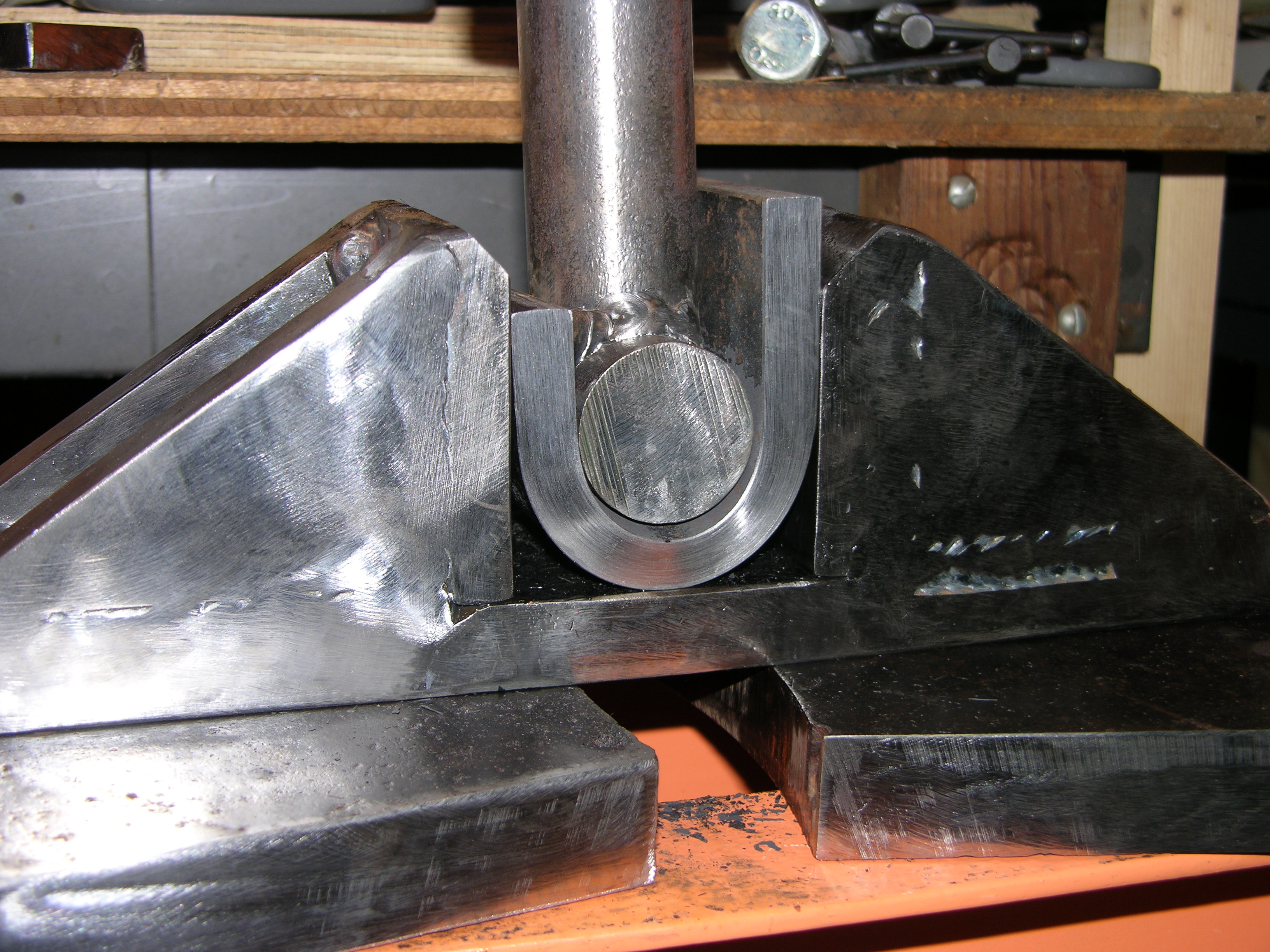

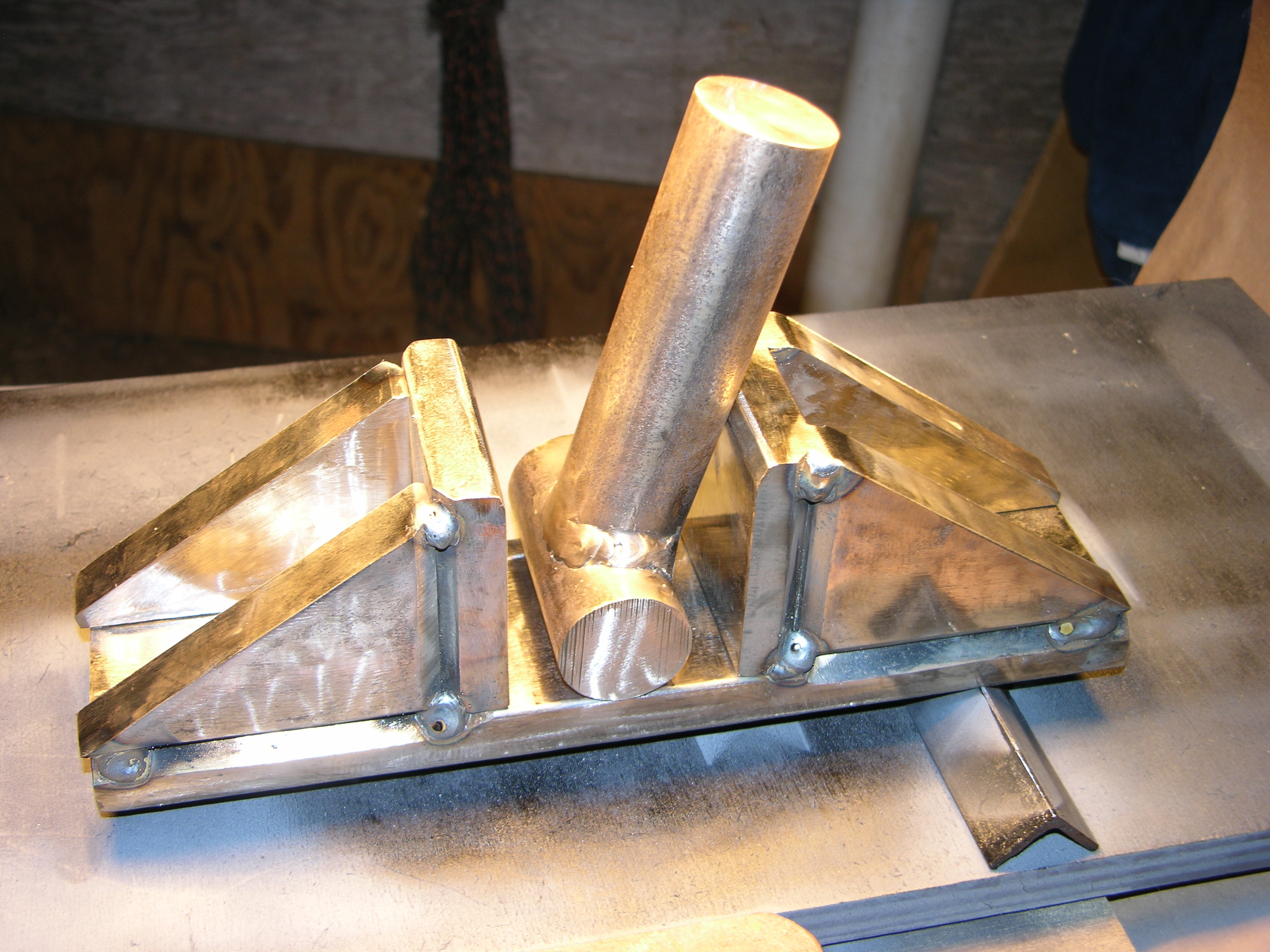

Me too Mark; both my mm211digital and mm252 have welded everything from 14 ga. fence wire welded to emt conduit, up to 3/4" flat bar and never change wire size from .035".
Hint - on the fence wire to EMT, I set for 17.5 volts/180 IPM (low end for 16 ga.), strike off on the EMT (about 1/2 second) then flick it over to the wire for about 1/4 second and DONE...
The 3/4" flat bar takes a bit more juice and time :D ...Steve
Yeah, I know; pics or it didn't happen :rolleyes:
