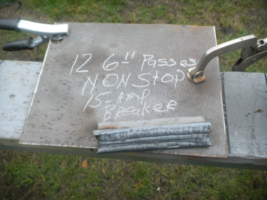

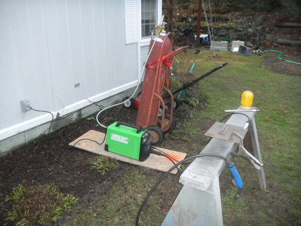

A lot of the concern about 110 volt welders is based off of transformer welders and not the more efficient inverters.
   / want mig welder, which one to get #39
I ran this endurance test with an Everlast 120-volt Mig welder. On a 15-amp breaker.
