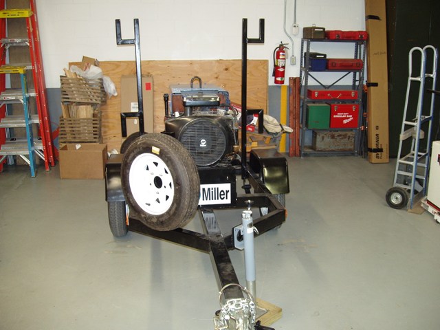

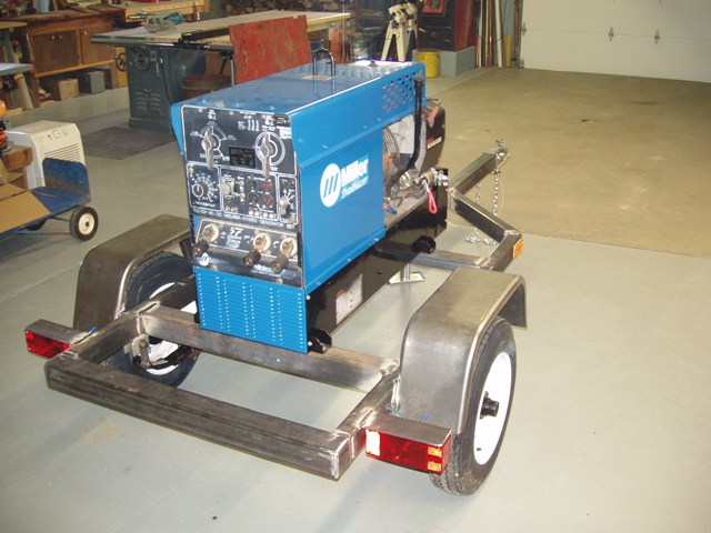

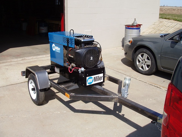

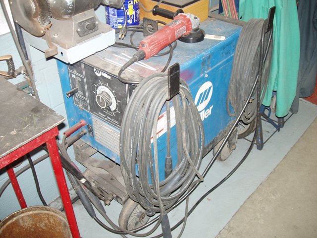

Here is a shot of my junk.:eek:
Very, very nice sir. Now if my memory serves me correct did I see somewhere that you restored that mobile welding outfit??? sorry if i'm wrong on this. it might be just another brain fart I'm having. Either way I like it all. Very nice work on the trailer as well. Tip my lid to you. :thumbsup:

   / Want new welder - opinions? #19
[/COLOR]
Yep, this is the one I rescued from the scrap.....Then I had to build a trailer for it.:cool:
