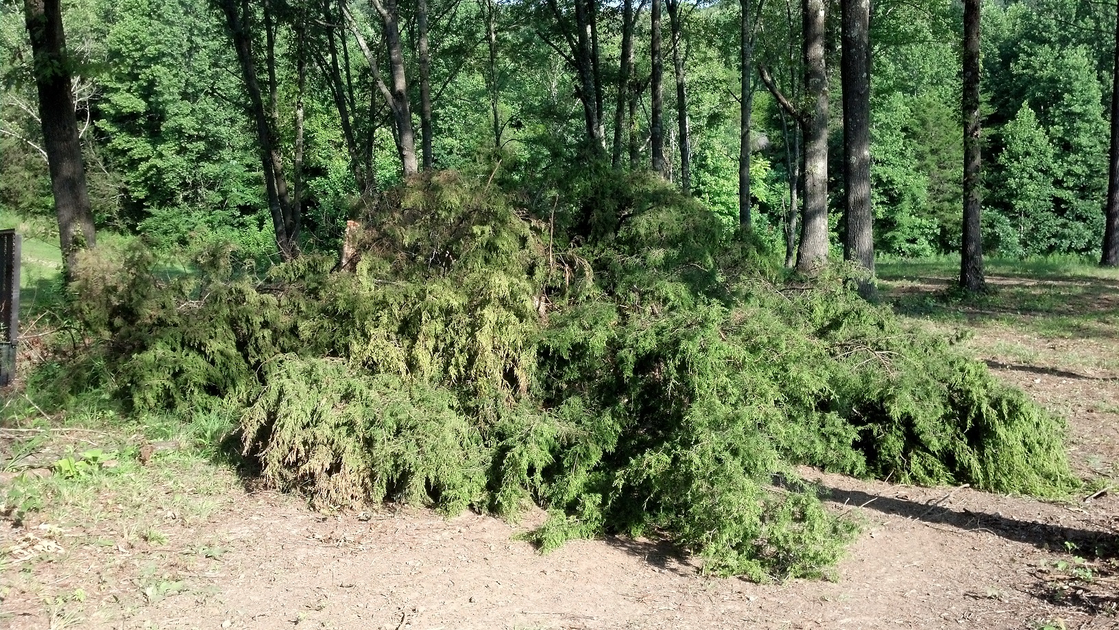

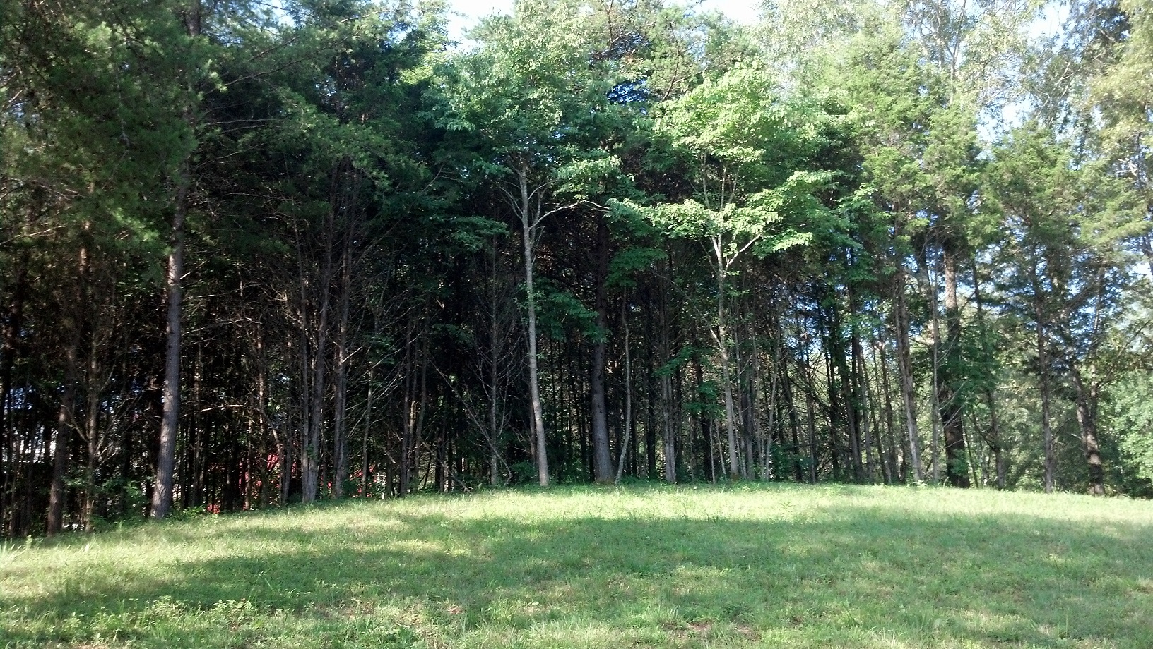

I've been removing cedar trees from my property. I already have a large (>25 trees) and growing pile of tree parts and I'm just getting started. Here is some examples.
Some trees are less than 10" diameter and are easy to pull out of the ground (root ball) with the tractor. But some are much bigger and require a combo of the tractor pull and a 4 ton come along. My first harbor freight 4 ton come along is now scrap metal.
But it was cheap in price and quality. I need to find a better and quicker method of removing the bigger cedar trees. I'm thinking (hoping) the grapple will make life much easier for me in removing trees and moving the downed trees to a burn pile.

Keep in mind when pushing over small green trees like those cedars: Don't try for too big, and do it a day or so after a good rain. They will go much easier when the ground is not like concrete.. you need to wait a bit for the top of the ground to dry some so the tractor has good traction, but the lower soil is still moist. Never push on dead trees or trees with "iffy" looking branches. You are liable to get one over the head at worst, or a smashed tractor hood at best. If you have a dead tree you need to try to remove with a tractor, get a long chain/chains and put it on the fixed drawbar and try to pull them over. Of course if you can afford the rigging you can use the power advantage of "rigging" with multiple pulleys. Don't misunderestimate the height of this tree as you pull it down in your direction. An error could be fatal. One advantage of using "rigging" is you tractor pull can go in one direction and the tree fall can go into another. Always good if you can do it. Watch this little tractor pull a large tree stump with a 35 to 1 "rigging" :

I do wait until after a good rain. I first cut down the top of the tree at about the 5' mark. Then I pull the remaining 5' trunk and root ball. I usually push and pull the trunk a bit to break loose the roots. I have had to tie a rope up high on a tree and bent it in the direction I want it to fall, before I cut with the chainsaw, with the tractor far enough away to miss the falling tree. This is only done when the tree is too close to something I don't want hit by the falling tree when something goes wrong.
