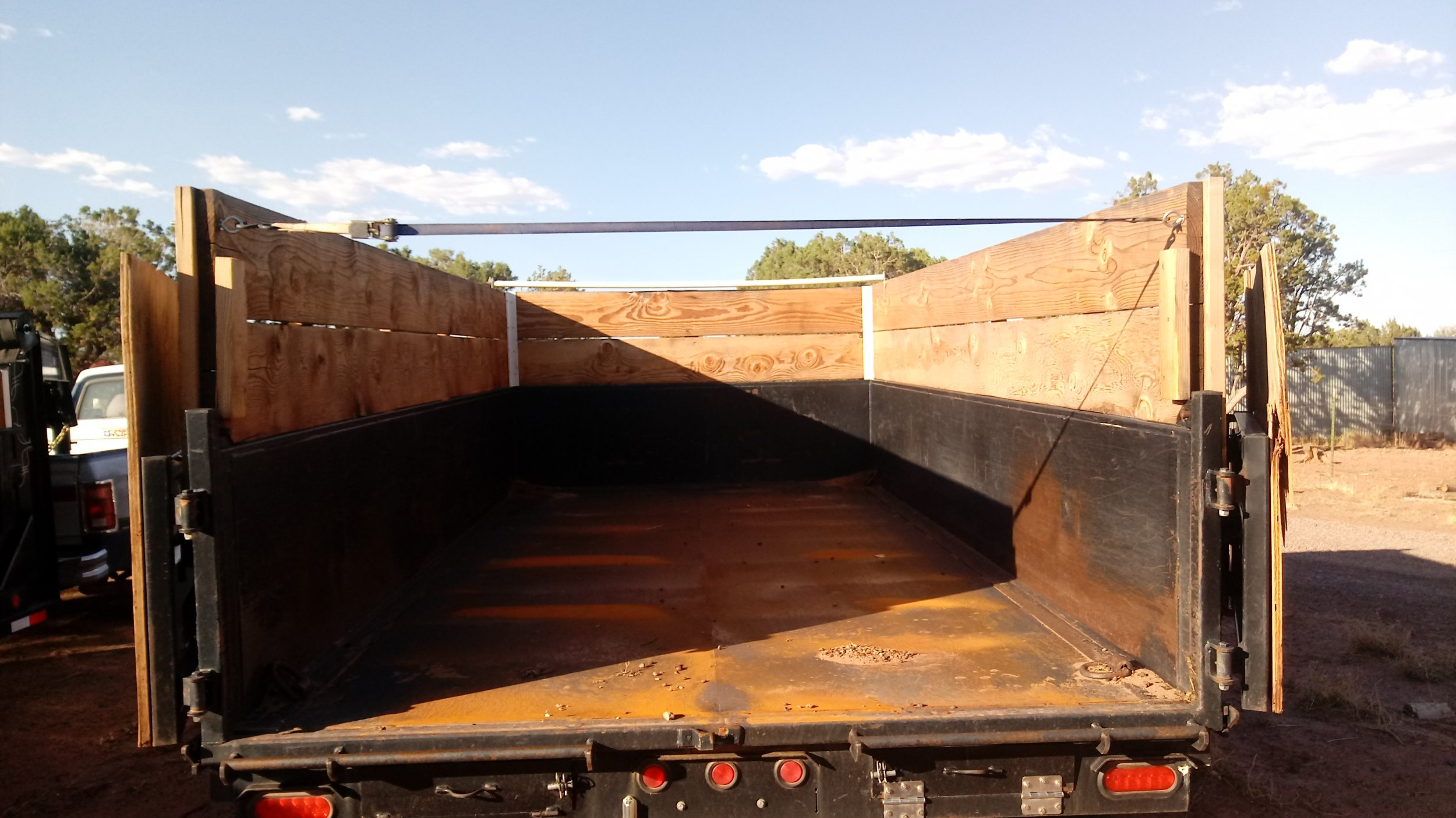

To the OP. I had a 6'x10'x2', 10k and a 7'x14'x2, 14k bumper pull dumps. For a home owner or a seldom user they are great. Easy to hook up, maneuver better than a gooseneck and are very universal. I use mine for almost every type load. In general you want at least 10 gauge floor and 12 gauge sides. For commercial use, go with 7 gauge floor and 10 gauge sides. My PJ has 7 gauge floor and sides but it is heavy at 22k gvw. The Lamar is 7 gauge floor with 10 gauge sides, 16k gvw and weighs 1k less. The problem with a 10 gauge floor, is, heavy wheeled vehicles will bow the floor between every crossmember. (picture of my 14k dump, note the rust, that is low spots)
The longer the trailer the better they tow and load placement isn't such an issue. My 10' was dangerous, too hard to get pin weight. We have frost heaves here (whoopty doos) they can really give you a ride with a bumper pull, gooseneck takes them in stride.
For heavy use and loads, go gooseneck. Load placement is not as critical. Again, longer is better to a point. Decide if you need high volume and light weight loads or low volume heavy loads. I found I need 3' sides and short side boards to haul light weight loads such as chips or mulch. They (3' sides) are high enough to haul good loads but low enough most small loaders can reach over them.
I am also a fan of torsion axles, way better ride.

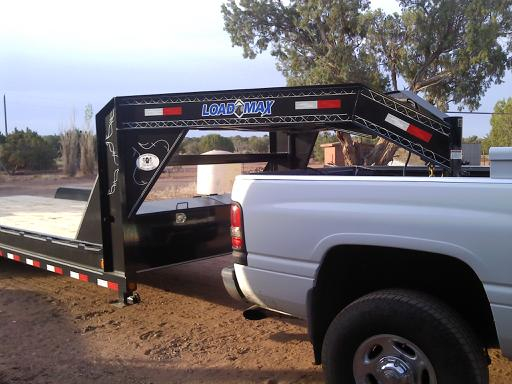

The longer the trailer the better they tow and load placement isn't such an issue. My 10' was dangerous, too hard to get pin weight. We have frost heaves here (whoopty doos) they can really give you a ride with a bumper pull, gooseneck takes them in stride.View attachment 695613
The one I’m looking to get has 20 or 24 inch sides, which is fine by me since you can add 2x12’s or whatever like you did. They also do the 7 gauge floor ect. Think I’ve made up my mind what I want just hung up between the 14 or 16K factor.
