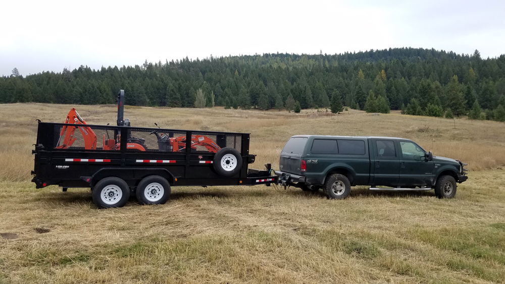

14 foot Moritz gooseneck owner. I’ve hauled 6 tons of gravel, 5 tons of manure, skid steer, mini excavator. Never a problem, ramps are handy and aluminum. The best thing about the gooseneck is the turning radius. You can get in and out of a lot of places that you would never be able to with a bumper pull. My three-quarter ton diesel ram pulls it with ease, really don’t even know it’s there, even loaded.

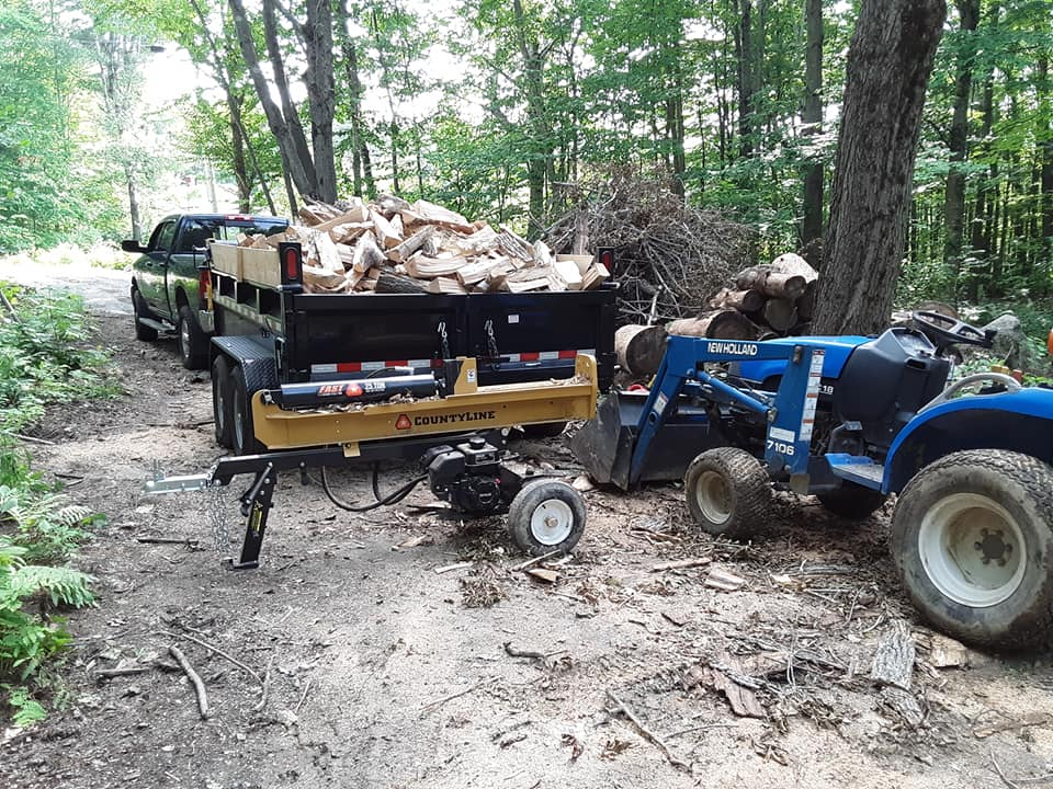

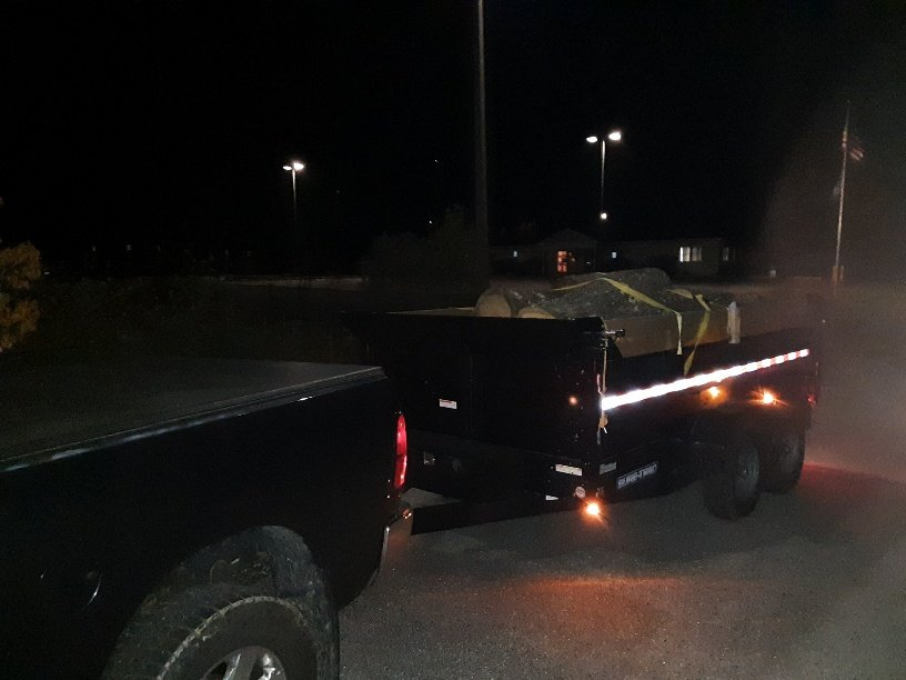

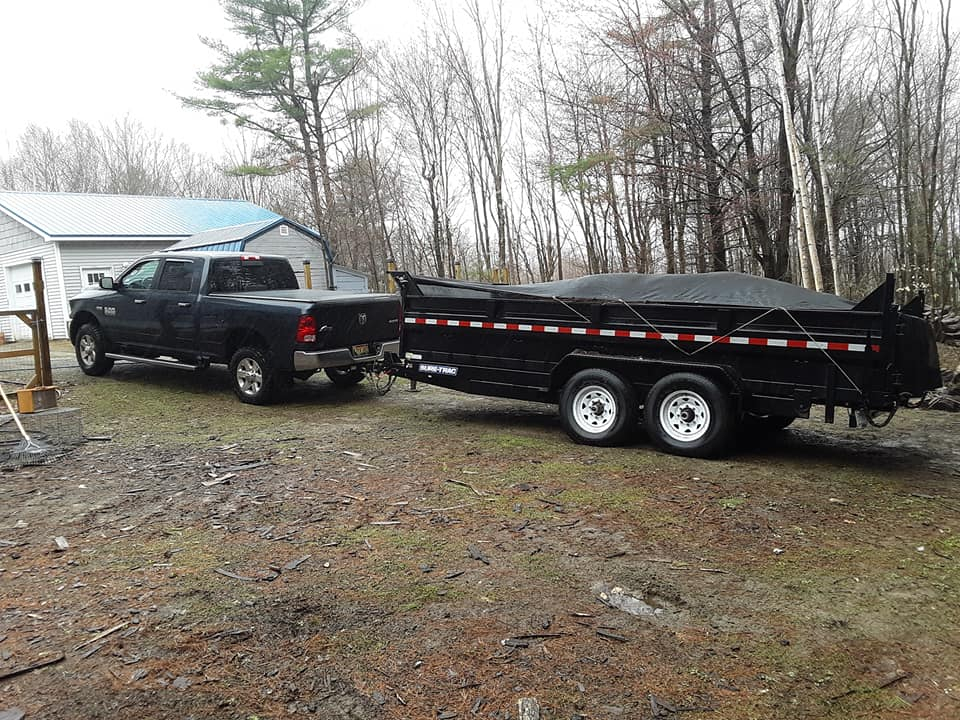

I have a Suretrac 12 foot 14k bumper pull and don't have any issues with sag or sway. I'm hauling it with a '15 Ram 2500, no suspension or tire upgrades. If you're looking to haul equipment and maneuvering room isn't an issue, go with the 14 footer. That way you've got a little more room to adjust where it rides, so you can balance your load better and control your tongue weight.
A goose neck will give you a little more flexibility with how you position the load, but if you're not working in tight quarters then the longer trailer would still be better. The downside is that it can't lift to quite so high of an angle for dumping, but the difference is pretty negligible.
Edit- I'm not great at taking pictures while I'm hauling, so I've only got these 2 of firewood in my trailer, and then 2 with it maxed out with a 16 foot rental from before I bought my 12 footer
Green Oak:
Wet topsoil.
not a lot of squatting going on. You just have to distribute the load correctly, to maintain the proper tongue weight.
