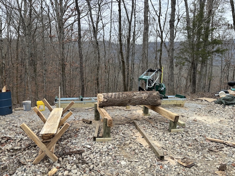

Learn your mill, by that I mean the flow of the "process". Moving the quantities of logs, slabwood and boards on and off of the mill (efficiently) is something I'm still playing with myself.
This said noticing that you only have access to one side of the mill in your picture. (and that might work just fine for you)
A big congratulations to you on your mill!👍
YES!! That is my next big goal, refine my processes so I am not getting in my own way. I have some ideas; log deck, slab rack, a bunch of precut stickers, all the tools i need onsite in a jobbox, etc. I don't have a ton of extra time to mill so I want to make it as easy on myself as possible. Since you mentioned the other side of my mill, there is about 5 or 6 feet over there before the slope starts. I am thinking about making a second log deck on that side is that something you millers think would be useful? I would have to roll the logs across the mill and onto the other side. But I could really load up with the logs then.

Back when I was running my little Hudson Mill things that helped me were to have a log deck set up high enough on one side to easily roll logs onto the mill rails. I loaded the deck with logs with my little MF GC2300 tractor with bucket forks. I had a bottle jack between the rails at the cut start end to set the top end of log centered for height. Always kept a Peavey to roll logs handy and some other tools like axe and hammers.
Clear lanes to carry off cut pieces are a must. You don't want to be stumbling over things.
Once you get the rhythm of it it is rather amazing how fast you can slice up a log.

HH, which side is your push handle on? Do you load logs with forks on your tractor? Which side is the log dogs on? Where is the discharge of the saw dust?
On my Timbery saw mill, I load logs on the push handle side. The logs dogs are on the opposite side, which is where the saw dust discharge is. So I roll a log off the forks onto the mill, the dogs stops it from going off the other side. The tractor is then parked on the handle side with the forks at a convenient height to load slabs or boards onto as needed. When the log is cut up, I move the tractor to where I am stickering the lumber for air drying. I put slabs on another set of base stickers for fire wood cutting. Jon
Yep, this mill is setup the exact same way. For now I am loading the logs with the tractor. The first thing I am going to mill are beams for a log deck. Seems like that will be better for work flow not having to get in and out of the tractor every time I need a log. I do like your idea of having the forks right there to collect the cut lumber. I will also probably build 2 racks very early on, one for the slab cutoffs and one for milled lumber. That way I don't have to fire up the tractor every time I want to mill. Thanks for your input! How do you like the Timbery?

I think the Timbery was one of a few that has a diagonal brace between the rails for stiffness. I don't want a log deck right next to the mill because I utilize the tractor forks to put the cut lumber and then transport to the base stickers for stacking the lumber. Then those stacks are moved away from the mill to their respective air drying areas. Some of my logs started in the 24 to 26" butt diameters. Tractor was necessary to handle them. Even had to use it for rotating 90 degrees. Myself on a pevee was not strong enough.

I hear you on the log deck, I plan on keeping the deck wide enough so the tractor can fit between either side of the deck. I hope that works. Time will tell.

Starting to get things dialed in. I wanted to build a log deck wide enough that would allow me access to the mill with the tractor, but I am not sure its going to work well. The way it is it doesn't allow me to put shorter logs on it. I might have to go with a log deck that does not allow tractor access as I feel like it is more important to have a log deck than it is to have tractor access. I will make the deck so I can lift it out of the way with the tractor if I need to get in there. I want a deck because I think it will be easier to have the deck loaded and show up and mill, rather than getting the tractor every time. Also, I do not love loading the logs on the mill with the tractor every time. I think you increase the chances of hitting the mill that way.

Could you use a log deck that sloped to your mill, so your tractor only has to get to the end of it? I've seen a number mills that were set up for a "gravity feed" of logs to a set of stops, and then a log was rolled over the final stop or the stop was removed for one log to move the log onto the mill.

It is not the rolling part, that is easy the deck is lightly higher than the mill. The main part is positioning it on the mill in the ideal position. Not easy to move these logs forward or backwards once they are set down. Also accommodating all lengths of logs from 6-16 feet.

Have you considered a small "gantry" type rolling crane to lift and move your logs from your stock stack to the mill table.
