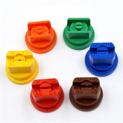

1--Here's a Tee-Jet tip I use. I The lowest flow is the best and I think mine is red.

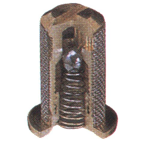

2--Here's the no-drip check valve filter I use. Goes in the nozzle.

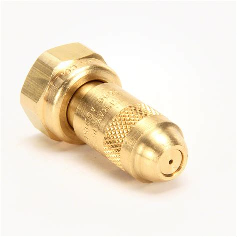

3--I don't use this last nozzle. Puts out waaay too much liquid for me.iu.jpeg
