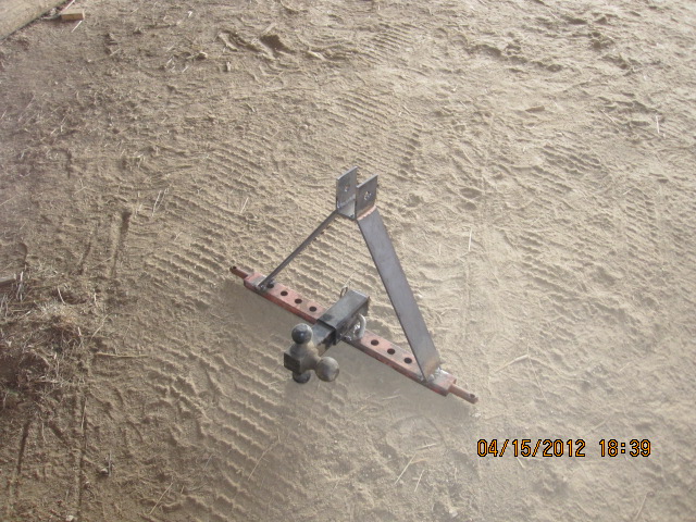

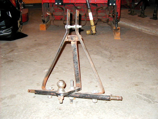

Here is one that I did as an early welding project. The welding could be a lot better, but it will give an idea of one approach. Note, the weight and pull is on a heavy duty drawbar, so it should hold. My welds are just keeping it upright.
Ken, you did a little nicer job than I did, but mine served my purposes.:D See post #9 in this thread: http://www.tractorbynet.com/forums/attachments/6912-draw-bar.html#post70750

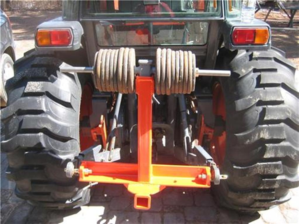

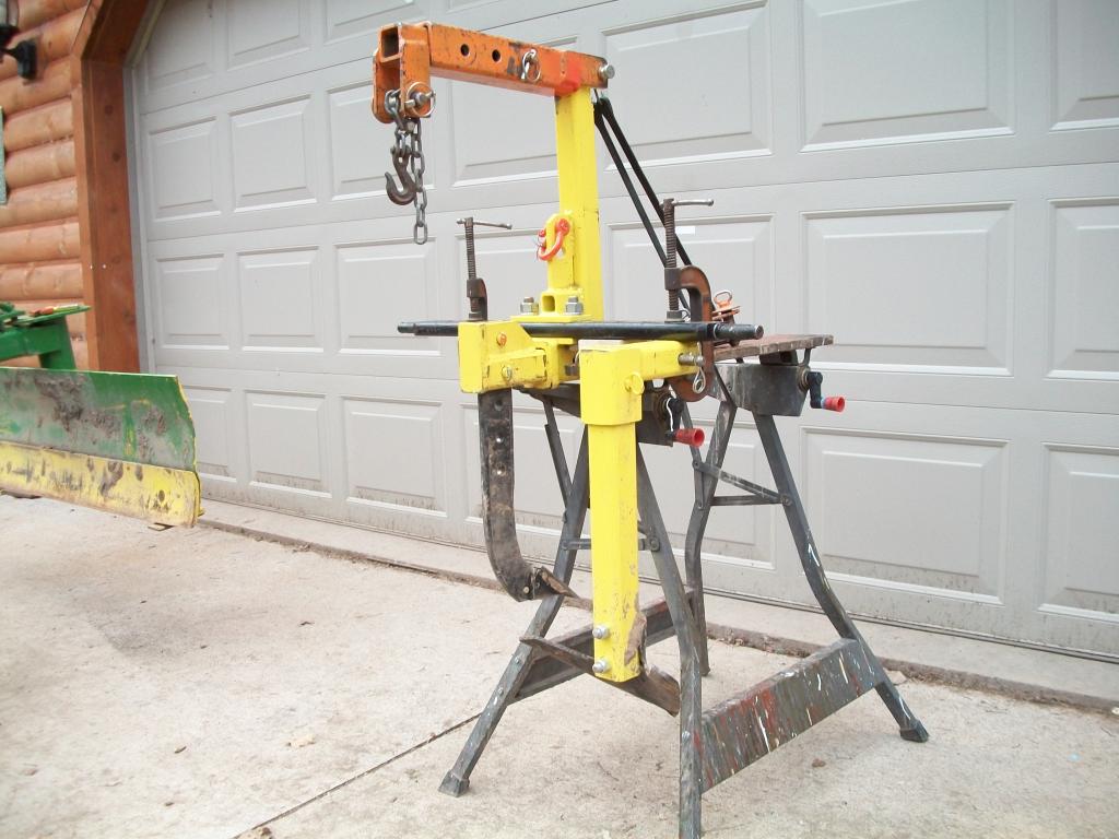

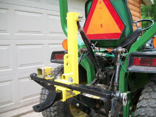

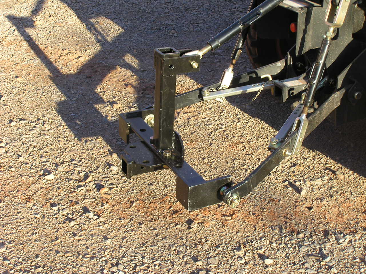

Just found a hitch on clearance for 15 bucks gonna cut to width and add pins and an upright with a 2 5/16 ball for gn hitches

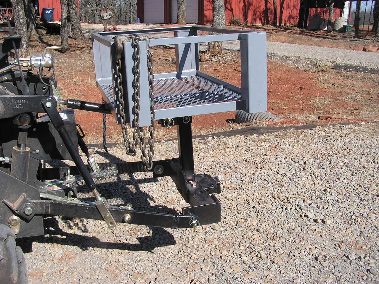

If you use a receiver for the upright, you can do a lot more with it than just a gooseneck ball on top.
The carry box.

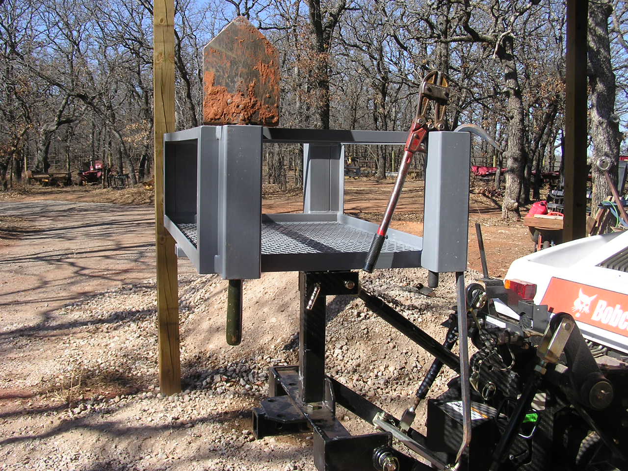

Here are a couple samples of my inventions......
If I can get multiple pictures to attach....
Good luck

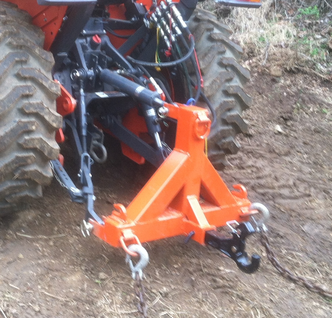

   / Want to make ball hitch attachment for the three point lift, Any made? #17
Here's mine
Cost:
3-D rings $15
2-Chain hooks $10
1-receiver tube $12
1-Pintle hook $90 Optional
Orange rattle can paint $10
Lower and upper link pins $15
Scrap 3-1/2 x 3-1/2 tubing & flat bar $Free
So I have $62 in it less the pintle hook......and my time..........I enjoy fabricating so my time is my hobby.

   / Want to make ball hitch attachment for the three point lift, Any made? #18
^^^ Great idea with the chain hooks and D-rings.
   / Want to make ball hitch attachment for the three point lift, Any made? #19
Yeah .... I run the chain through the bottom of the D ring and then adjust the length using the chain hook.
That keeps the chain pulling as low as possible.
I ran out of leftover chain hooks and couldn't put one on top of the upright.

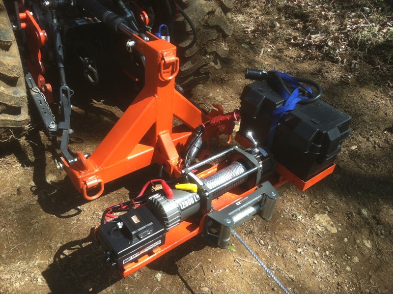

   / Want to make ball hitch attachment for the three point lift, Any made? #20
Here's a picture with the winch mounted.
the bottom tube of the winch has a D ring for connecting the cable to when using a snatch block.
