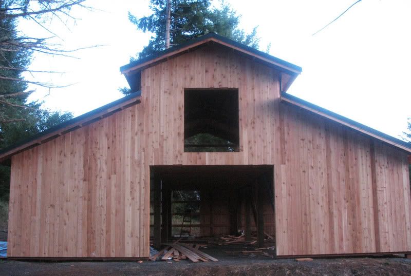

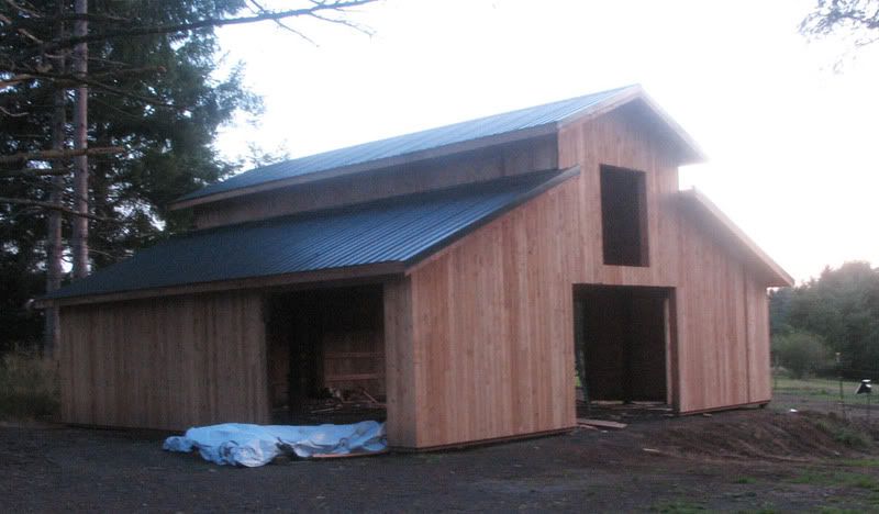

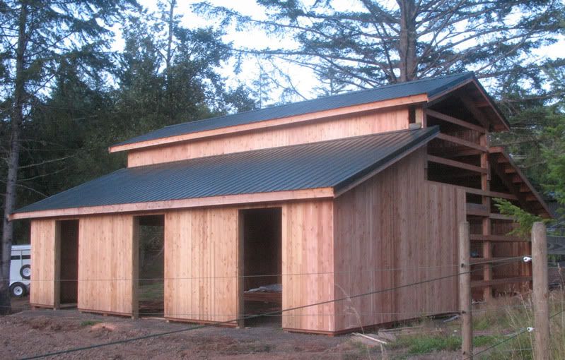

Just a quick update, nearing the end of the exterior siding. I apologize for the picture quality, I'm not sure what is going on with the camera. I decided to make it easier on myself and beak up the siding on the large, completely sided rear wall. I'll run a belly band across the entire length to cover up the seam and give it a better look. It will be nice to have it closed in, the only problem being is that it's getting dark in there pretty early in the day now. Looks like I might move up the electrical. Once the siding is done, I think it'll be onto stalls and the exterior paddocks. I can put trim up during the rainy season if it comes to that. I need to get the paddocks graded out and finished before it turns into a mud hole.

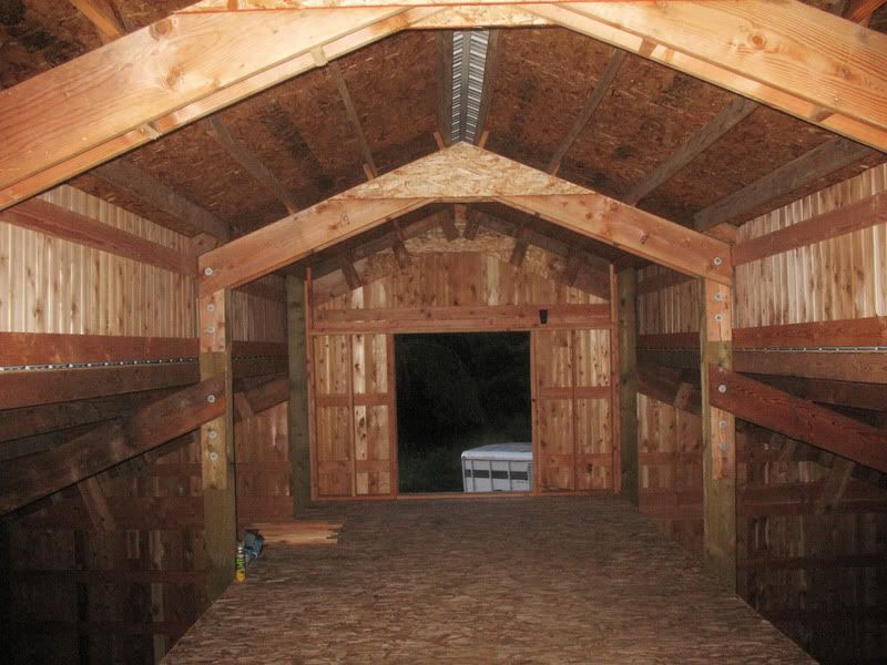

View from inside the loft.

MAN!!!!!! Is that a nice barn!!! Good job my friend!! :D
   / Want to see yet another pole building? #98
Steeldust,
Great job!
Are the openings in the loft for feeding hay down into the stalls?
Are you going to put up rails?
Again, great job man.
   / Want to see yet another pole building? #99
Beautiful. I really like the design and all that wood.

Steeldust,
Great job!
Yes, I'll be able to feed hay down from the loft. I will put rails up when I'm closer to having things finished off. Right now, they'd just be in the way.
