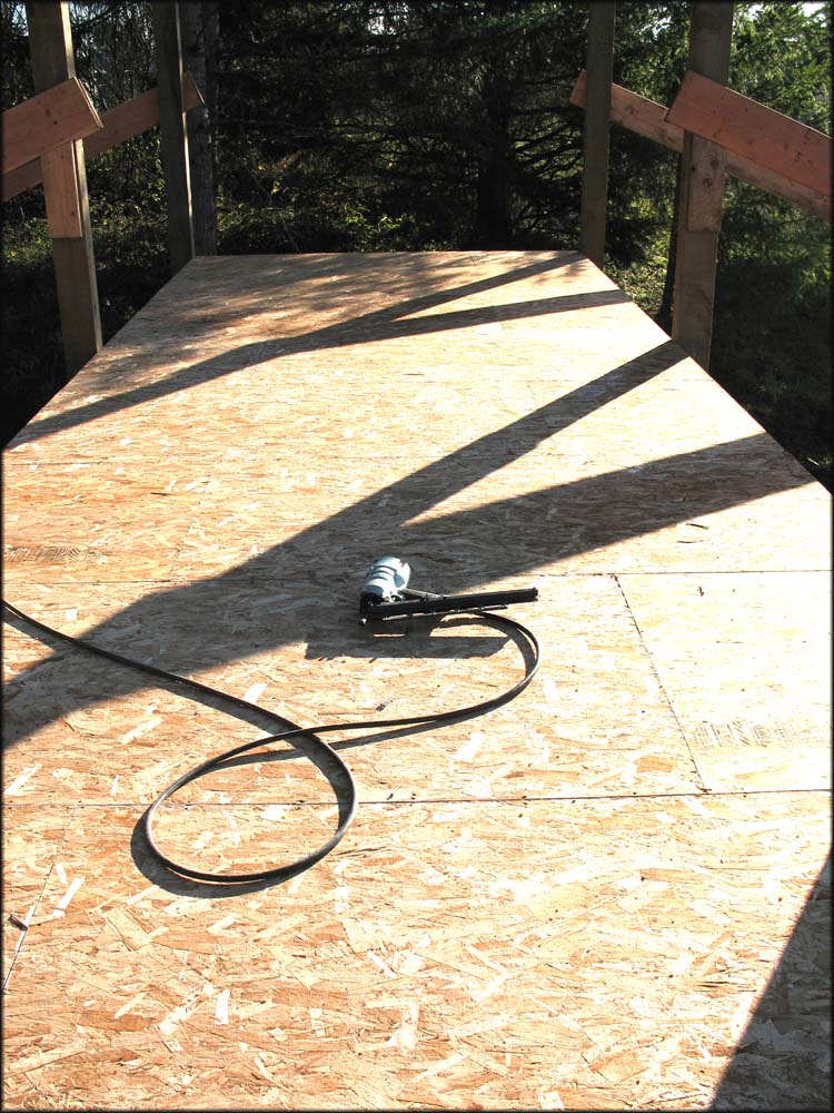

Most of the loft decking went down today. I'll have to make a mental note never to lay T&G OSB subfloor in the rain again. The OSB swells just enough to make fitting the tounge tightly into the groove quite difficult. I somehow managed to tear the insulation on my circular saw cord today, luckily the circuit is GFCI, and it was tested today. I was using the back up cordless circular saw to cut hardibacker recently, so that blade is trashed and really slowed things down.
The posts are in 56" deep holes with 8" of concrete poured into the bottom. I then backfilled the holes with bottom ash from the plant I work at (has the consistency of sand) Most up here either backfill with sand or 5/8" minus rock with lots of fines. Either way, add water and agitate as you are filling and they're rock solid when finished.

The original plans that I based this building off of spec'ed 11 7/8" LSL beams for the loft rim joist. That was to achieve a 80 psf load rating. Looking at the data I figure using Structural grade 2x12 in doug fir easily gives me a 60 psf load rating for the loft floor. Which should be more than enough for what I'll need to store. In fact, with they type of hay I store, I don't think I'll have the height in the loft to load it to 60psf.

Quick update. Decking on the loft floor is done (edges of OSB are nailed down, still have to go back and nail on the center studs and pound the 500 or so odd nails needed to fill up the joist hangers, 16 nails per hanger :mad: ).
I finished it up this morning as soon as the OSB thawed out, and before I had to put the turkey in the deep fryer. I'll most likely cut the center rafters, attach the gussets, and set them on Saturday. Hoping to start putting up the purlin blocks and maybe setting purlins by Sunday. It'll be nice to have the roof done and have a dry place to finish her off.
Hope everyone had a good Thanksgiving.

Perhaps I should not be asking this. Did you attach anything to the posts to limit uplift or is that not something particular to your area?
Typically, with PT posts, many (not all) the builders in my area nail or screw on some pieces of PT about 8" long to the posts. Once the posts are well tamped in or in your case, backfilled with the ash, the blocks resist frost heave which is a possiblity where I live.
