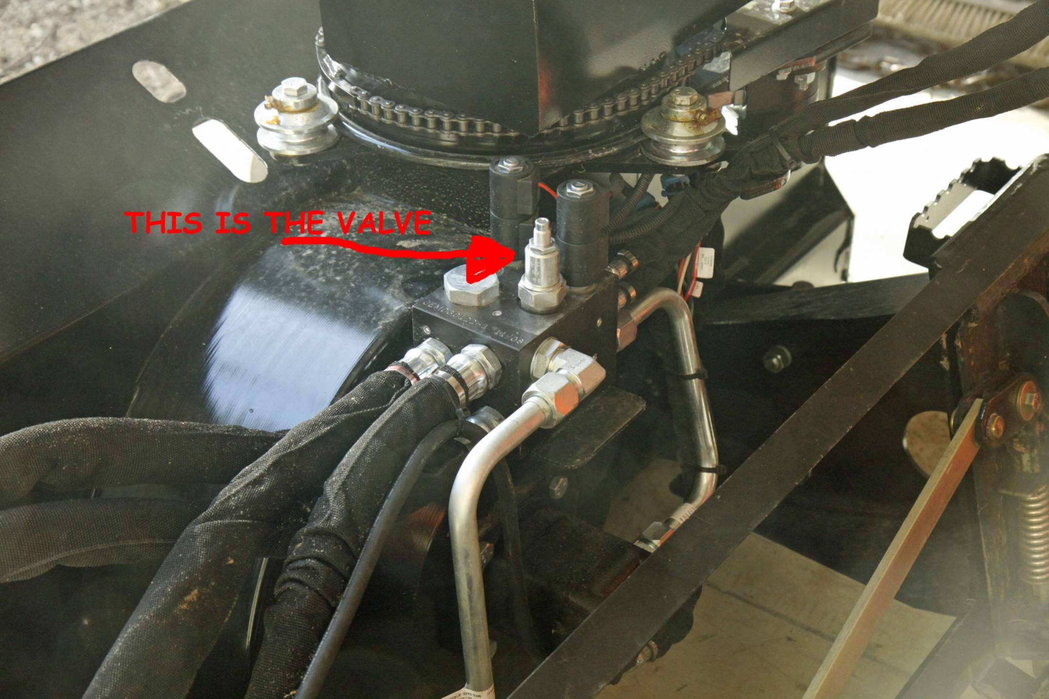

It's a proportioning valve sweetheart.....:)
I'm completely floored by your modesty.....:thumbsup:
I wonder if its an "Mentor" brand flow control valve with the aluminum block housing as it sounds like one of thier units?
   / Want to thank TBN users that helped me fix the loader mount snowblower issues... #12
Don't believe so. The builder of his unit uses Charr-Lynn components and Parker Valving.
Relief valve isn't the correct term. It's a proportioning valve. The adjustment knob acts on a needle valve and check ball system to divert a percentage of the fluid into bypass while maintaining a pre-set pressure. The tighter the needle becomes, the less fluid goes into bypass and the more fluid acts on the hydraulic motor.

not sure of the brand on it. its the silver valve. Its a simple adjustment. Loosen the nut and turn the allen head screw.

grsthegreat, I got to thinking instead of changing the adjustment from a powdery snow to heavy wet snow and back couldn't you just set it on ONE setting for use on any kind of snow?
well, i was told that i would be safer using the lower settings early in the season and for light snow to protect the auger, etc. at too high of a setting rocks, branches, etc can cause damage by preventing the unit to disengage. The first snows of the season are the ones that really mess with my equipment. that was when the majority of the shear bolts on my old machine would break.

Well... I guess different people and different manufacturers call them... well... differently.
Sun Hydraulics calls it an adjustable needle valve cartridge.
