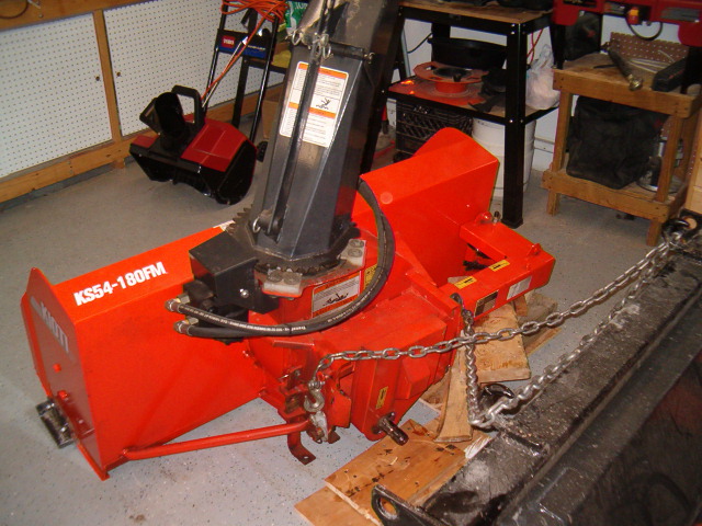

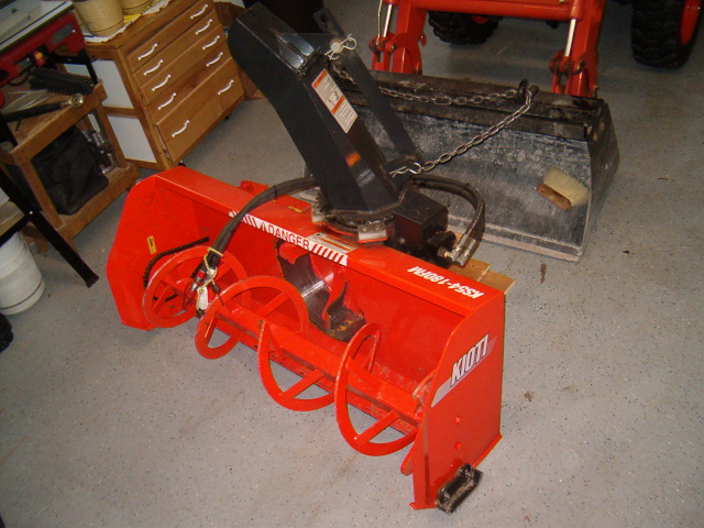

Well, It is time to get the snowblower off my CK2510 and stow it away. I want to place a couple 5/16" weldable grab hooks. The blower is a Kioti front unit model KS54-180FM . It bears thie Kioti brand. I need to locate a good place for both stability and hopefully balance so I don't damage anything including the chute. I will include a heavier plate beneath the hook. Anybody got any pics or suggestions where a good location exists. Most of tihe available steel is 3/16's of an inch. I would like to carefulliy move this withi my bucket and chain.
Thanks for any suggestions in advance.

Thanks for the observations. No hook on this snowblower but I know what you mean. I had a loop on tihe previouis blower whichi was a rear Power take off Meteorhis is the solution however given I can get somewhere close to thie center of gravity.
The longer chain unfortunately wont be much help. I would have to raise bucket to accommodate longer chain so the load clears the ground. This will cause load to swing and also be placed closer to tractor. More swing and load closer can equal collision at most an my slow speed. Your tractor is probably taller already than my little CK2510. The booms on my loader would handle the job more efficiently if closer to horizontal for me.

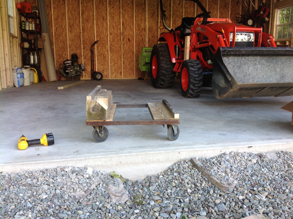

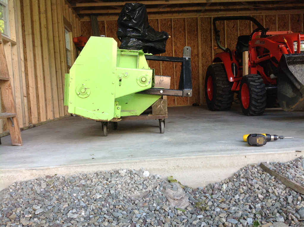

Is it going to be stored indoors? If yes, you could make a cradle for it on a dolly. This assumes that it will lift high enough while still on the tractor. I made this for my 3pt blower. image-2033240318.jpg image-3026902612.jpg Roll the dolly under the blower, drop it on the dolly and disconnect it. It's very stable and rolls very easily. If it's stored outdoors, can you use your pallet forks? Maybe a cradle on a piece of plywood mounted to two 4x4s for dunnage.
If you are not already planning to, you might want to shoot the bare metal in the drum with some primer or coat it good with some Fluid Film before storage.

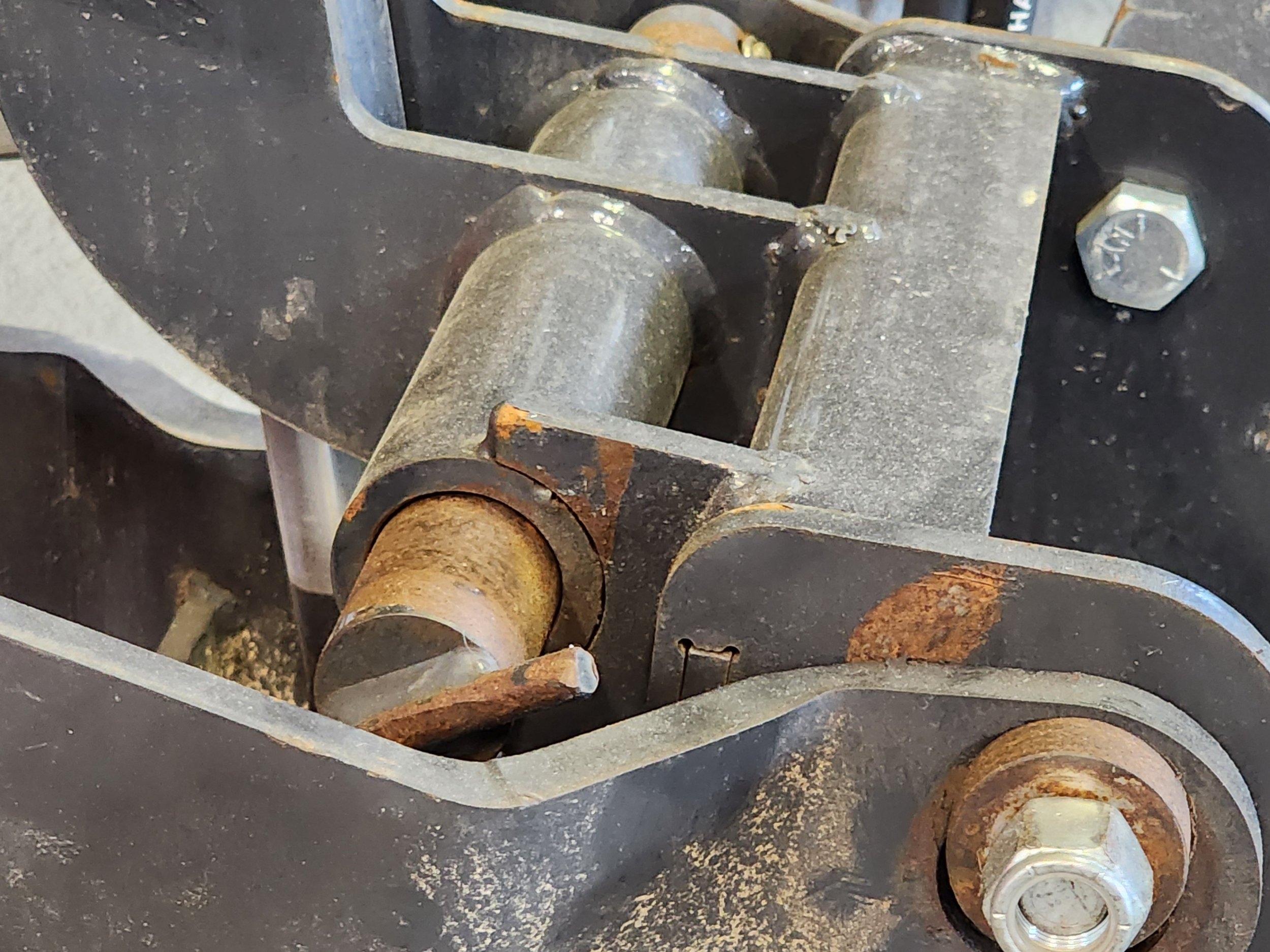

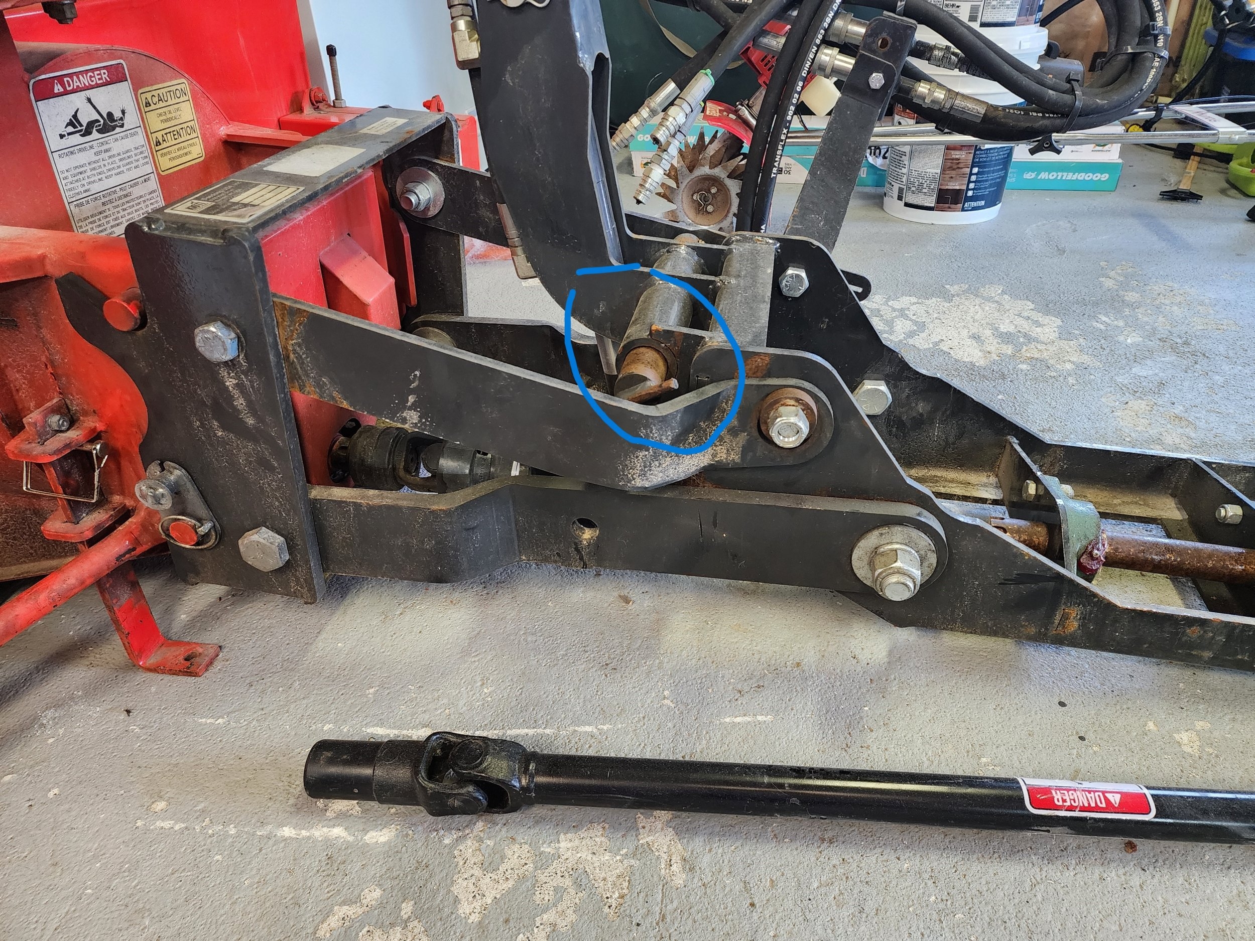

Can someone tell me how to actually remove this large pin in order to attach this snowblower to the tractor?

- edit. I was thinking the KS66, but the idea should be the same. And I assume it still takes a mountain of a man to move that one as well-
Yes. I think if you pulled the lower pins (the gold oval shaped things) that attached the subframe from the blower then you can tilt the back of the subframe high enough that it will 'unhitch' from the blower. Be careful, that subframe is a lot heavier than it looks. And the blower itself is like 700 pounds or something. You might want a helper to prevent it from falling forward. (and possibly lifting the subframe)
Once its separated, the square portion of the subframe should fall enough to get the pin out.
I am sure it can be done, but the subframe needs to be attached to the tractor first, then use the subframe to lift the blower. And removal should be the opposite. They shouldn't be stored 'assembled' for reasons that you unfortunately discovered.
Good video (though I think he attaches the hoses wrong the first time, iirc) that explains it pretty well. I use dollies for mine, but the idea is the same.
