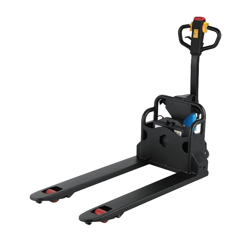

I combine two of the ideas mentioned above. I store my implements on pallets fitted with caster wheels. That way, I can move them with forks as well as roll them around inside the barn. Using the forks, I can also store the palletized implements off the floor on a rack.
For tight spaces, rather than use the tractor & forks, I use this electric pallet jack to move them around:
