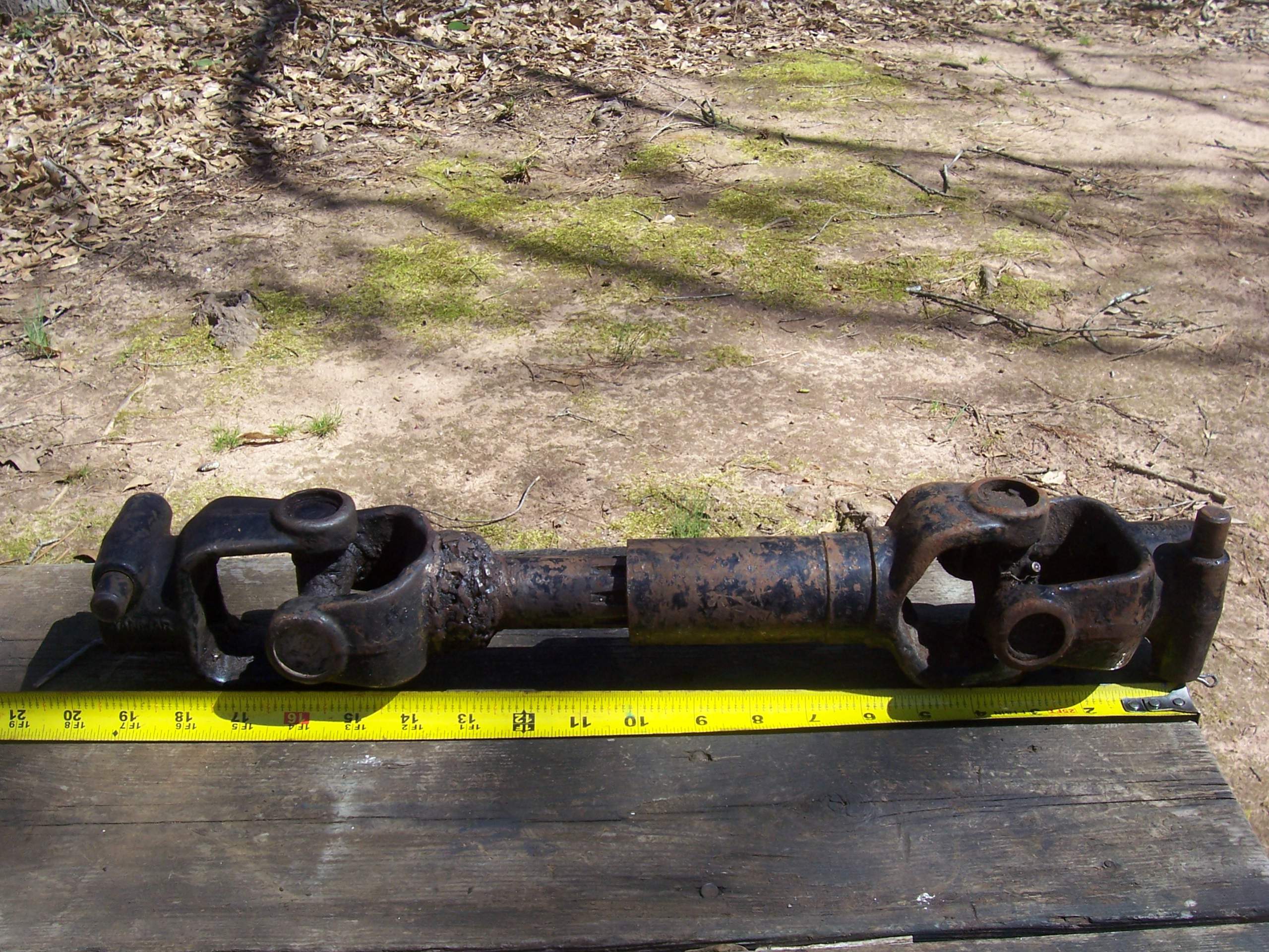

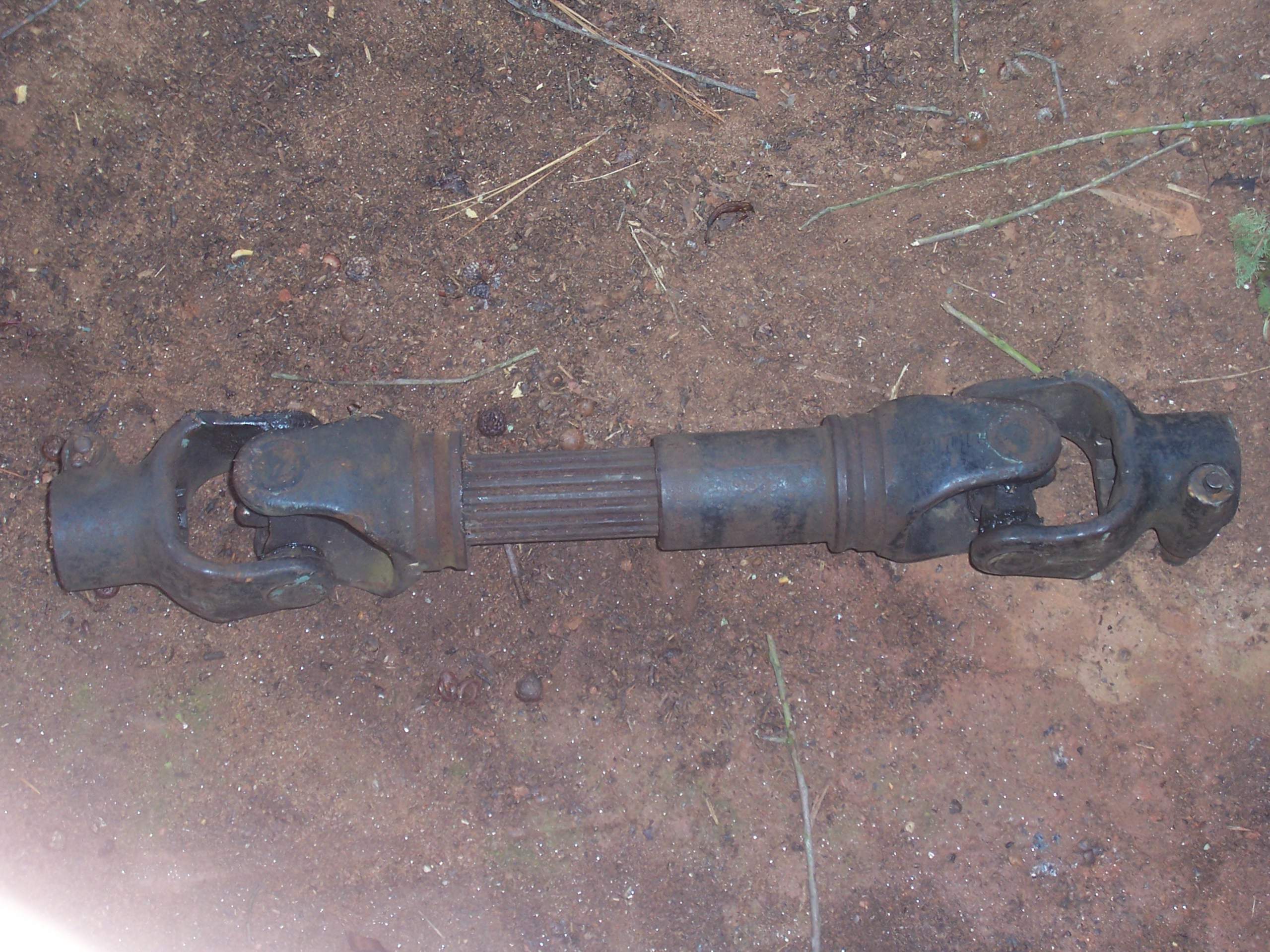

Been many yrs. since I shortened a Yanmar tiller shaft. Fredricks gave me the wrong shaft so I cut and welded one to make it fit until the correct one was sent. Worked like a champ! Even used my Elcheapo HF. welder on it. LOL.... It was easy and only took a few Minutes. What I did since being to long even with no slip clutch attached was took out a section on the male side which was about 6" leaving a 1/4" of the shaft intact. Then I still had to shorten the Female side of the Shaft. So I took that couple inch section and welded it to the male side. Slid right on the 1/4" and made a Coupling!! Inserted and tached the male side and was done with it. Still have the shaft to the day. Which of course they sent me the correct Shaft, Which I sold with the tiller a few yrs. later.
