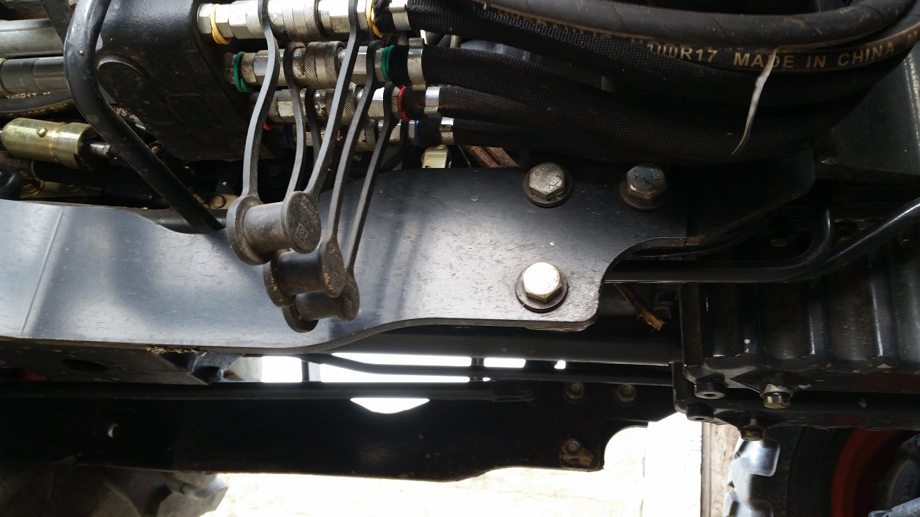

I have a woods BH-80X on my ct230 and have been pretty happy with it.
Galaxie... Do you have any pix of how the Woods subframe connects to the tractor at the FEL? Woods uses the same subframe for their BH65, 70X, 75, and 80X backhoes, and I want to put a BH75 on my CT230.
