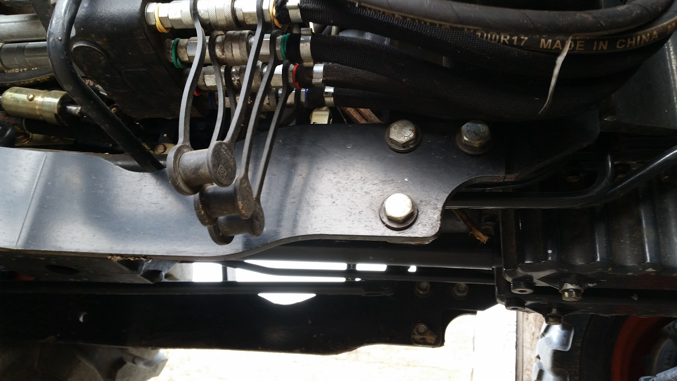

I can get you some pictures when I get back home but it won't be till after Thanksgiving. I don't recall doing any modifications when I attached it. Other than being hard to do everything by yourself, I don't remember issues.
I have been very happy with mine. I have done a lot of things with it that really saved my back and things I didn't think it would do.
The only thing I don't like about it is the cylinder for the bucket and main arm leak off quick. I don't see any visible leaks but they do leak off.

Dave,
My frame extends from the back of the tractor up to the cross member for the FEL where it gets bolted on with three bolts as shown in the attachment. I hope this helps. If you need more pics, please let me know.
