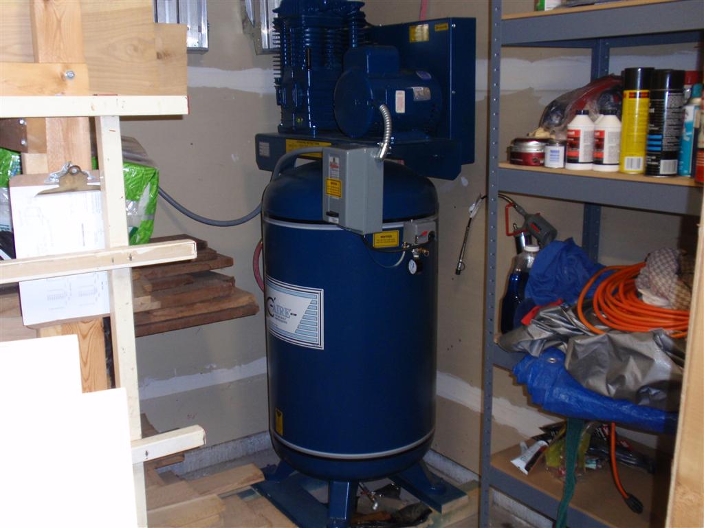

Anyone ever try to take the crank bolt off a 3.0 SHO engine? Or worse yet, a weenie little 1.6l I4 Honda? Good gawd they're on there to beat the band. I found time is your friend. Keep pounding at it even with a good impact wrench, sometimes up to 15-20 min of pounding - with breaks to let the compressor recover. But then I fixed that with a much bigger 2-stage compressor. I don't run out of air anymore :)
But then I've also found that some things just work better with a breaker bar. Sometimes the slow steady pull will loosen something the impact won't. It pays to have choices. My IR 2135TI is great - much lighter than the old 231 IR and more power. But sometimes the 24" breaker bar is the solution. We won't get into cheaters... :eek:

It amazes me that every picture I see of a compressor, shows the compressor still mounted to the shipping pallet instead of properly sitting on the concrete floor, on machinery pads.
   / Wanting first impact wrench #65
There was long conversation about this on here a while back.. Most people leave them on the pallet and after many years of use have never had any problems. I haven't got a large compressor yet, so I dont know the answer to this, but does the instructions say you must bolt it to the cement. Seems to me the wood in the pallet would absorb some of the vibration.
I guess it depends on who is right when you say "properly.":laughing: When I bought a 60 gallon compressor from a business that specializes in building, selling, and servicing compressors and associated accessories, they specifically recommended leaving it on the pallet. And in my opinion, as with the experts I spoke with, they are "properly" sitting on the pallet.:laughing:
I cannot imagine any advantage to removing one from the pallet to mount it to the concrete unless you have a problem with vibration causing it to move around. Mine never moved at all. And one big advantage to leaving it on the pallet is in case you ever have to move it. In my case, when I sold the farm, the realtor bought the compressor; sure glad it was still on the pallet.
