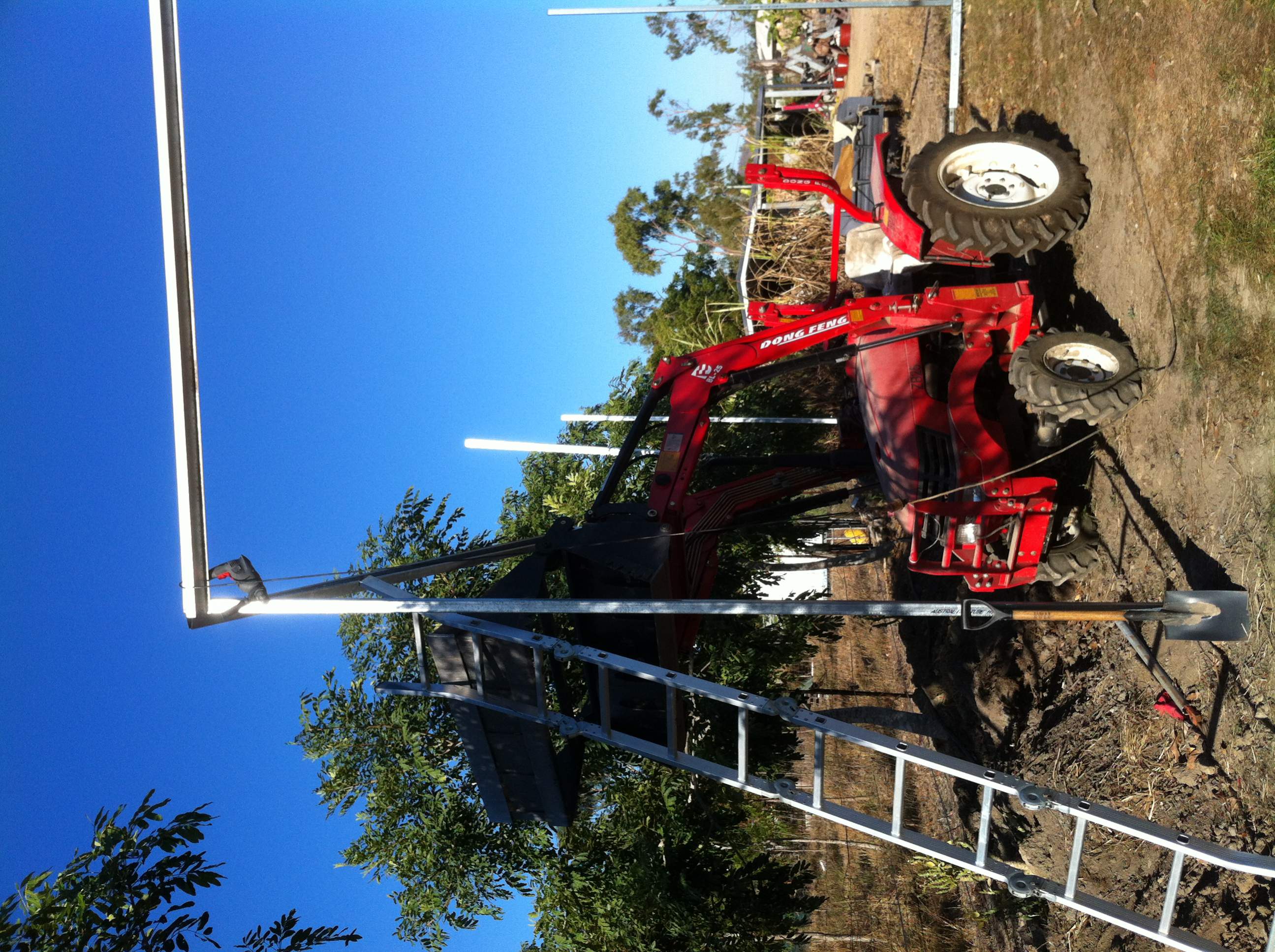

My experience ha sbeen a positive one with Dong Feng about a year and a half ago I bought a ZB25 3 cyl diesel with 3in 1 bucket 5 foot slasher and PHD.
I had been using my 1952 Fergy with a home made FEL. So 4 wheel drive and power steering are still a treat for me.
150 hrs on the clock and I would buy another one tomorrow, just love it. Used it to clean up after cyclone Yasi went through my place and tore up some big trees, no worries. IMG_0400.jpg
