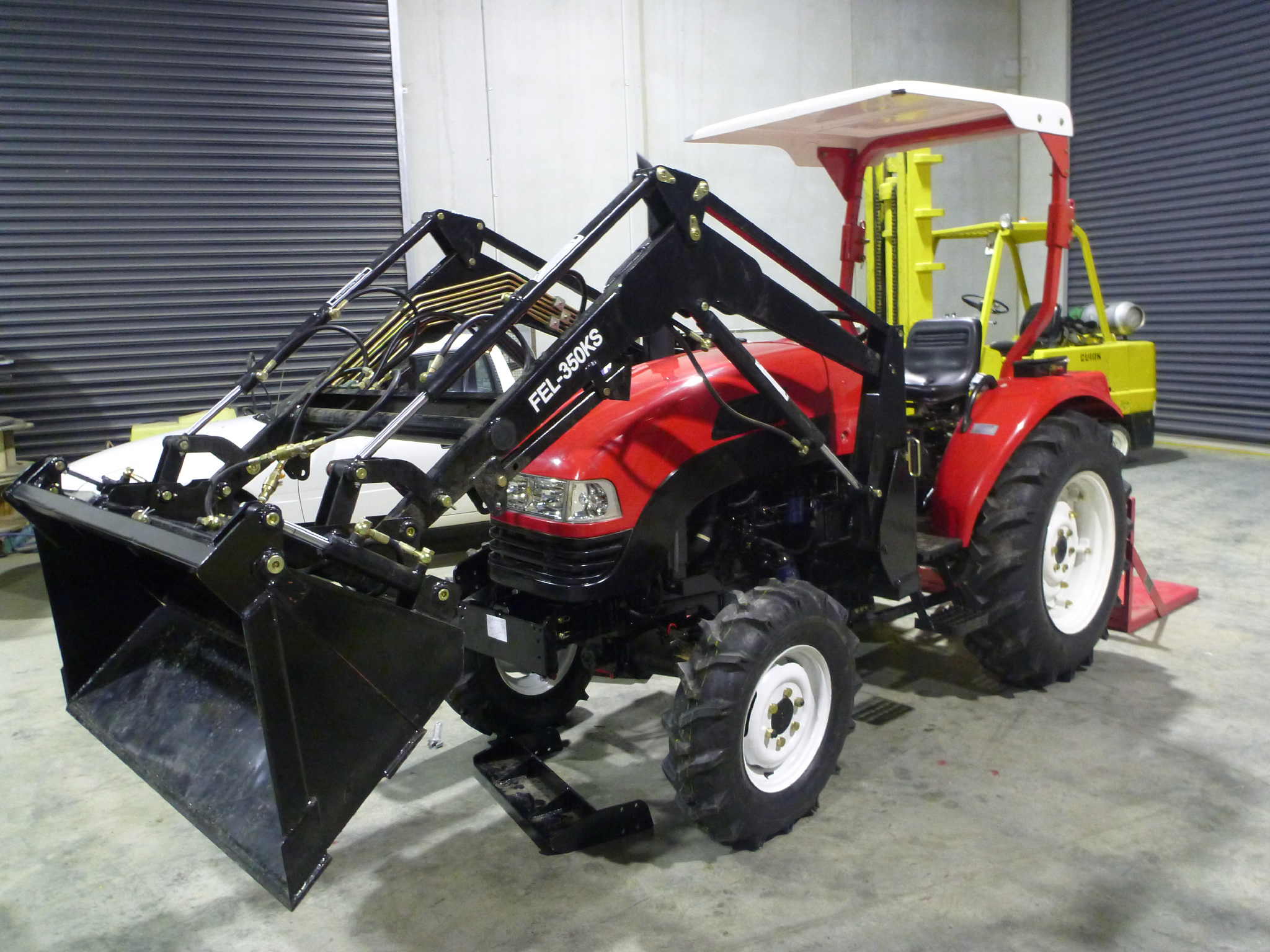

I imported a Dongfeng tractor from China about 18 months ago into Melbourne Aus
It is a 35HP 4wd, I purchased it with the 4 cyl European spec motor
Was a fairly simple process
I had looked at local tractors, and the tractor was available here branded Eastwind / midway sales.
If you want any additional info just ask
   / Wanting To Hear From Australian Chinese Tractor Owners #35
Hi Dave,
Was there much price differential, to the locally sourced tractors?
Were there any difficulties or delays on the Wharf or through customs?
Did it come in a container or as deck cargo, or as cargo in a hold?
When the fotons (Euroleopards) first hit the market in the West there were several operators bringing them in with wide a range of models. The range of models soon reduced and there are only a few examples of some types here, eg my 504.
Is your import the same colour as the locally sourced tractors?
Euroleopards are here as red via one importer and blue via another.
Very adventurous of you.
   / Wanting To Hear From Australian Chinese Tractor Owners #36
Hi Again
The tractor cost me $$7549, but remember I upgraded to the 4 cyl motor, synchro shuttle shift, disk brakes,Rops with canopy, exta hydraulic remotes
less than half the cost of the local product with 3 cyl motor.
As I also purchased a number of additional impliments 4 in 1 FEL TZ04D-1/5 To suit Dong Feng DF-354,LW-7 Backhoe With hydraulic Pump, HD09 Hole Digger, TL95 rotary tiller, Slasher TM140, Log Splitter, Flail Mower & Carry All
All of which case to a further $6600
I the whole lot was delivered in a 20 ft container.
Local handling in China including freight to Aus added another $2000
Colour is red, you could choose red, blue or yellow. I don't recall any limitations
I chose the Dongfeng as it has a much better reliability record than the Fotons
And you can buy the parts localy from East wind tractors, who seem to have reps in all states. though not sure about the 4 cyl motor. dut i got a kit of spares with the order, all gaskets, spare heatersa and injectors filters etc.
The delivery schedule was right on time up to receiving the documents from China they were two days late.
The tractor came in a sube cage, in knock down form, so a little assembly required, nothing a person with a spanner couldn't handle, as lond as you don't try and use the tools supplied,
You could get 8 tractors in a 20ft container.
The only problems I have had so far are with the impliments, dut all minor. I could write a book on the experience, and it would be a comedy, we still laugh about some of our experiences.
