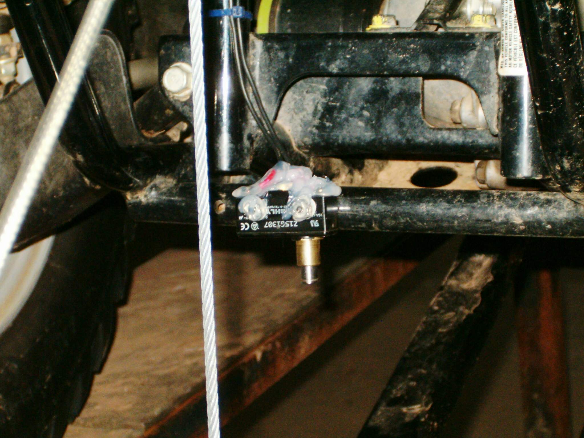

I eventually geared up a switch on the frame that contacted the arm when the plow was at it's highest point. The switch cut the power to the lift side of the winch switch stopping the winch from winding up. It would go down on the down button but lift no higher. On my ATV I ruined 2 winch mounts over winding the winch thinking the plow was not up all the way. It was trying to pull the winch right out of its mounts.

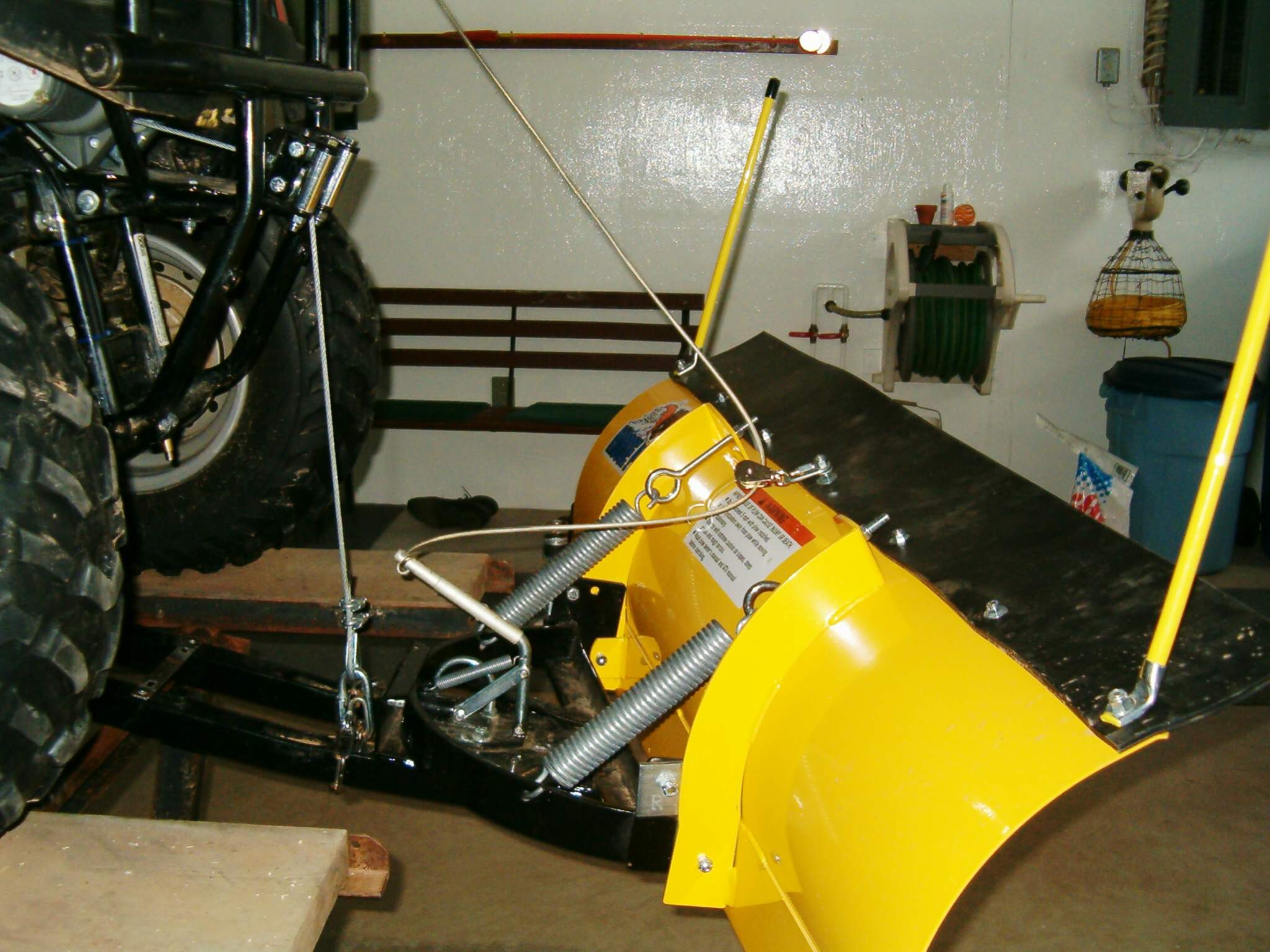

99.99999% done.
I welded longer mounting points (6"LX8"HX10"C2 triangles) onto the back end of the assembly and the blade stays perfectly level in all positions; an 8" drop from the mounting-point under the bumper. I also adjusted the attack angle, re-installed the safety springs, added new blade skids, and re-routed the cable as recommended.
I gave all the moving parts a shot of wool-wax.
All I need now is a 60" strip of conveyor belt (following a lead), to find that 8' piece of 1/4" cable I dropped somewhere on the woodlot, and some snow.
Much thanks for all the help!

   / Warn plow conversion from ATV to RTV #14
We need pictures as proof you know.
Just kidding, hope it all works out, was thinking I had said too much and you were upset.
Great news!!!

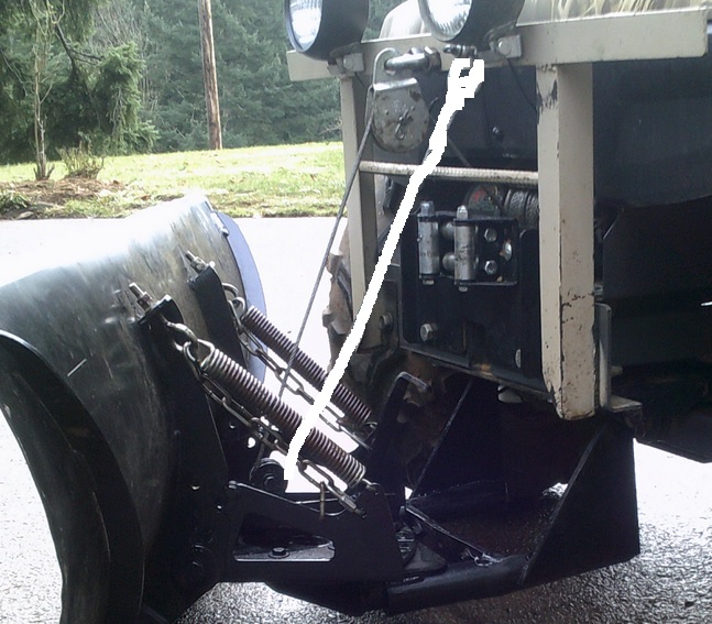

   / Warn plow conversion from ATV to RTV #17
Now all you need is snow!!!
One thing I would do is unhook the end of the cable from up on the cross frame at the top and just hook it to the bottom mount on the pivot plate.
You don't need to double up the cable like that. The winch is plenty strong and it will lift and lower quicker.

   / Warn plow conversion from ATV to RTV #18
Enjoy!!!
That would prevent any potential slipping of the cable off the reduction pulley, as well. One less potential headache. Looks really good. Great job!
Thanks for all the compliments and ideas,
Building on the idea to eliminate the lower pulley, and on the idea to use a shorter cable; I could simply make a more permanent 10' cable-attachment to the blade through the pin where that lower pulley currently is, run the free-running end of the cable up and through the snatch block, then into the blank winch spool. That way, the entire assembly is always all together (on a pallet) when I need it.
That is what I call synergy friends! :dance1:
Dragging the cable out (greasing, sliding on the winch-saver, and rewinding it) every time I dismount the blade may be good training and good PM, but it is getting old; I cannot squeeze the cable or kneel down that long any more.....:ashamed:

Yes I like that idea of a short cable. That 50' cable will soon get bunched up on the winch spool after a month of use. Then it binds on the cross bolts that hold the winch together making it very hard to get free. Been there done that.
The other point would be the 6" extensions. I found my last mode to my plow left the plow close to the front bumper and hard to see the corners. Wished after it was another 6" out further.
So, remove your 2 attachment bolts and simply slide the blade out the 6" you are expecting to add and see if your line of sight is good and you will be happy with that. Then try another 6" to see if it improves. At this point going 6" or 18" farther out is not big difference to the operation of plowing but could make it easier for you.
Remember the pivot has to be level, as you now know, when you add your extensions. So get the level out again and check.

This switch cut the power to the lift side of the winch when the bar on the plow arm came into contact. I was bending winch mounting plates trying to lift the plow too high.
